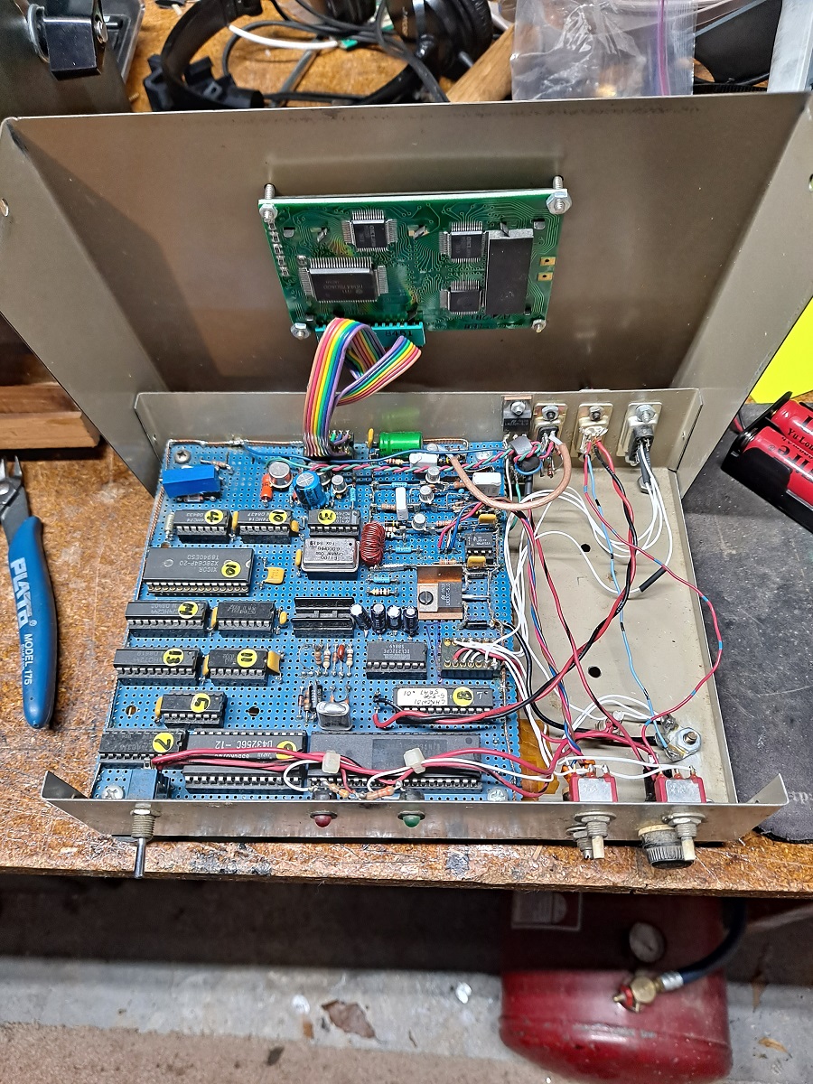

My Chronograph that I designed in 1992. I had to attach a new battery box for a pair of 18650 cells.
It is running an 8052 BASIC processor with 64K external RAM and ROM. 74HC logic with one Lattice PLD.
If it ever really dies, I guess I will have to design a new one.
