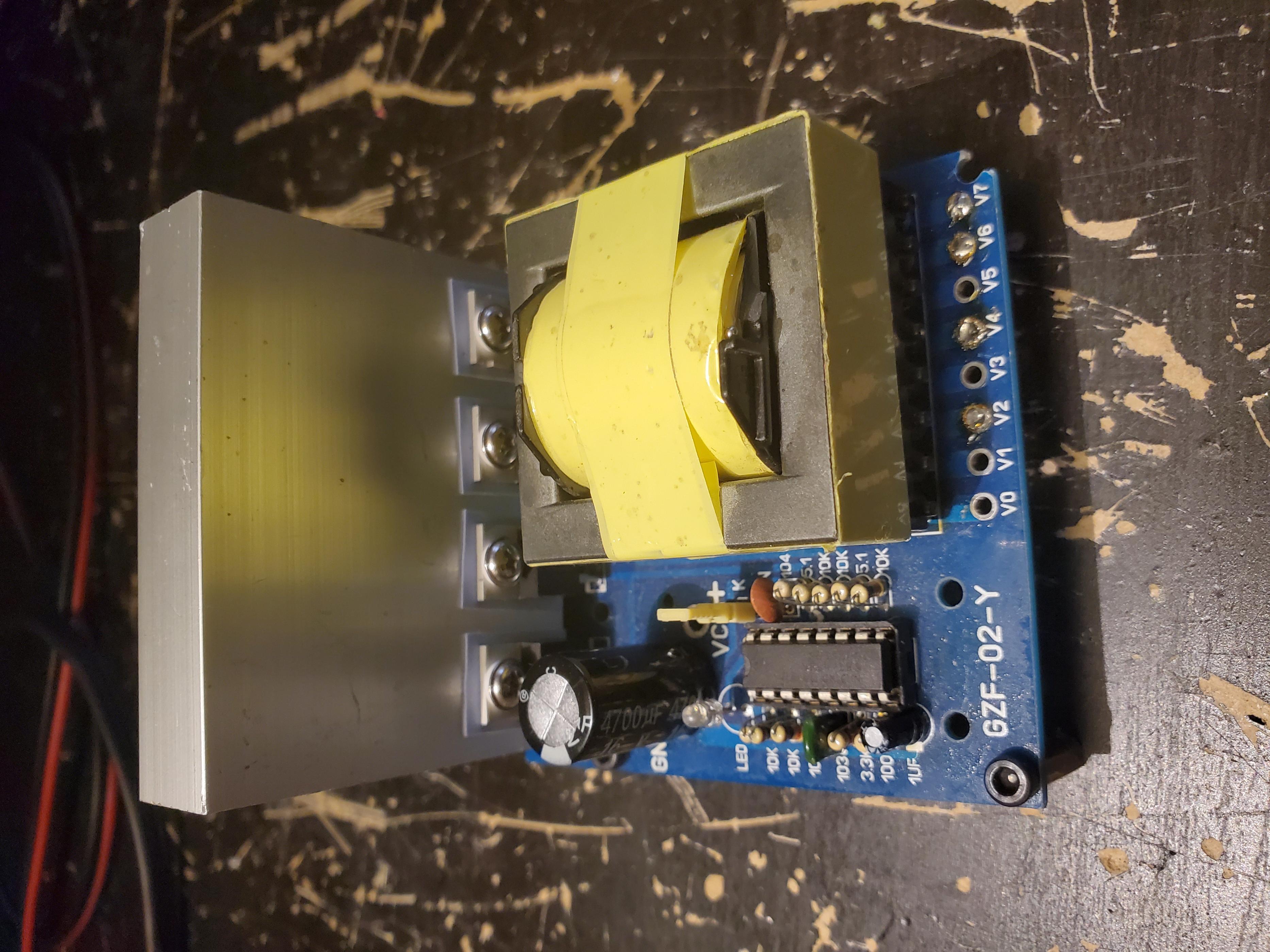

Fixed a 36V SMPS.
I changed to four electros and all is good.

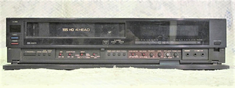

A woman brought in a 1986 GE VCR, apparently dead.
Her son bought it for her as a Christmas gift.
This GE model was made by Panasonic, and had to be their top of the line machine. (MSRP $890.)
Digital freeze frame, picture-in-picture, cast aluminum mechanism, all sorts of editing features and 42 controls, soft drop-down access door, LED level/tracking meters, illuminated cassette chamber, the works.
All it needed was some SMPS repairs - I quoted $80.
The woman nicely told me to keep it, she'd go to Walmart and buy another machine - she only used it for the clock anyway.
This machine never even saw a tape loaded into it!
What you can't see in the photo is the plethora of touch pad controls in the drop down door.
I still have it, and it runs like a champ.

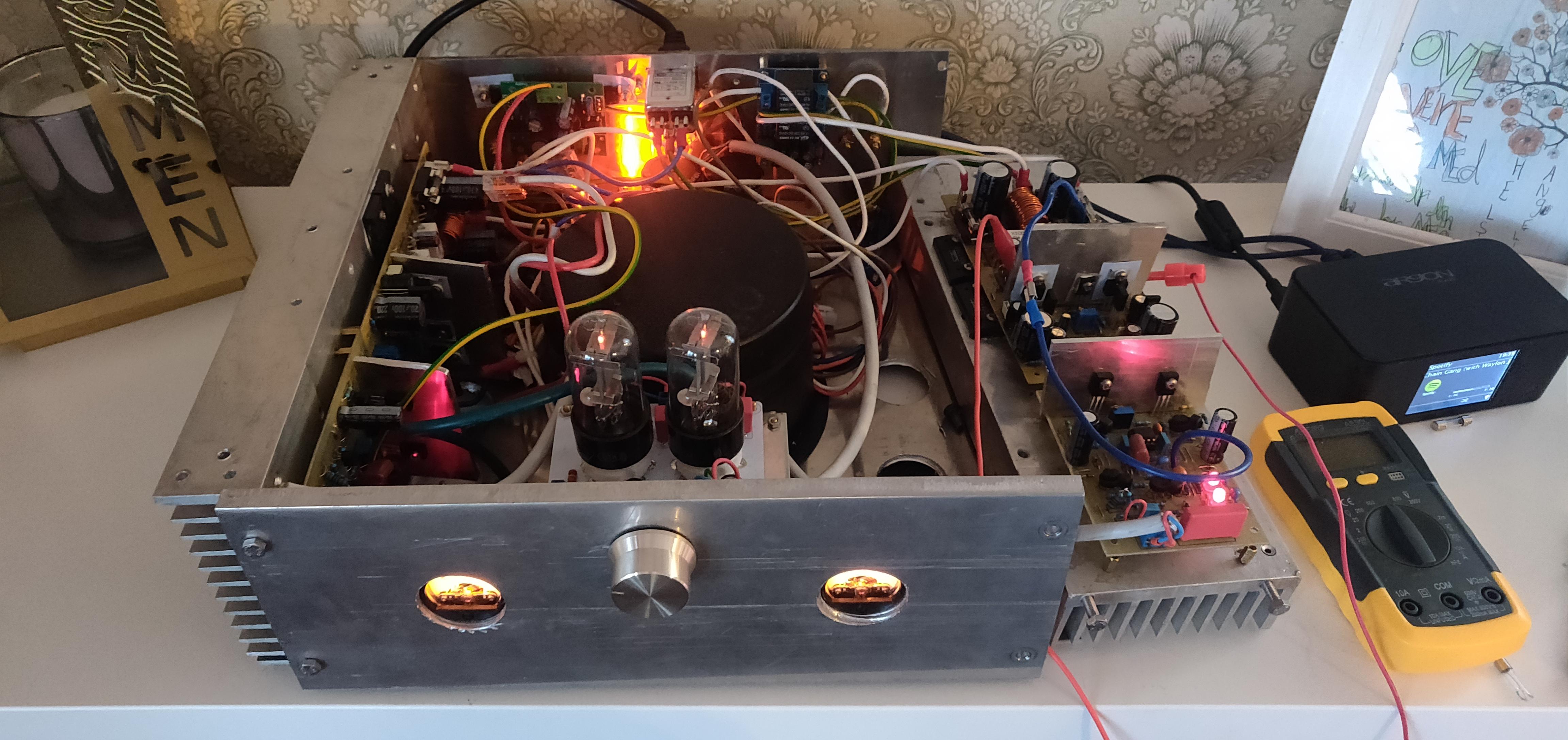

My garage amp.
The output transistors died due to loose aluminium shavings behind the pcb.
I didn't have any Mjl3281/1302 left, so I installed some sankens instead.
Warming it up and adjusting bias before I put the amp back together and carry it out in my garage.
