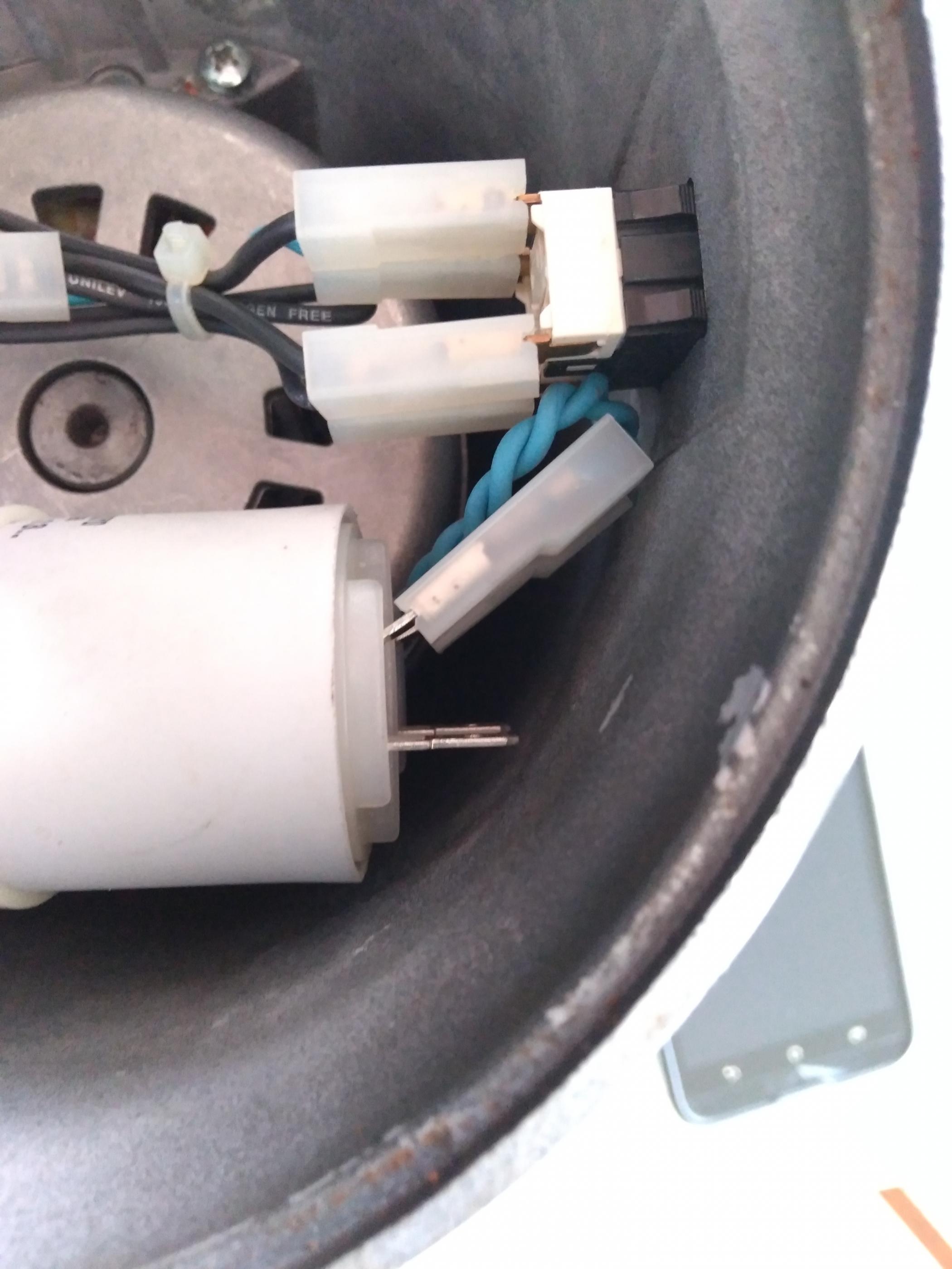

Repaired the coffee grinder yesterday.
I was horrified when I opened the bottom. this is Macap commercial grinder, that is motor start cap with 240V on the terminals, and to make matters worse the cap is held in place with a cable tie. I removed the cap bent and heat shrinked the bare terminals.

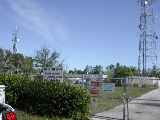

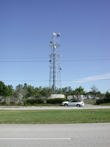

Here's a picture that I used in a report I called "The Two Towers." It's a multiple cellular site. The west facing antennas were at or above the legal maximum ERP at the time to cover a good chunk of the Florida Everglades swamp. That's my Mustang with the trunk open. I got questioned several times by cops when they saw me wandering in the cow pasture with fancy cop radios better than the ones they had.....yes, there is a 1 million square foot Motorola plant 4 miles from here, and yes, we make cop radios.....Mine don't transmit, but they do hear all your calls!...…
And YES, I could actually measure IMD signals being generated by the rusty chain on the gate which had been replaced in this picture. They don't teach THAT in engineering school either. I had actually discovered something similar at the age of 17 while putting up TV antennas. That loose ground wire with the green growth on it made channel 7 disappear by creating harmonics from the ultra strong channel 6 tower nearby.

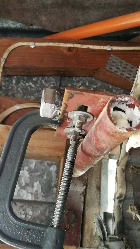

Garage roller door. I accidentally let the tension off adjusting it (the garage has shifted so much after a very long drout here and it had about an inch gap on one end).
I could not see for the life of me how to tension it back up, so I welded a nut to one end and hauled on a big (24") wrench (dubbed "the nutf***er") while my brother-in-law opened the door gradually. Then wound on the last bit and tightened the u-bolts. Worked a treat, it's actually set better than it was before.
Before anyone comments on my welding... I know, I know [emoji28] but it did the job ¯\_(ツ)_/¯Screenshot_20200315_205708_com.google.android.apps.photos.jpg
