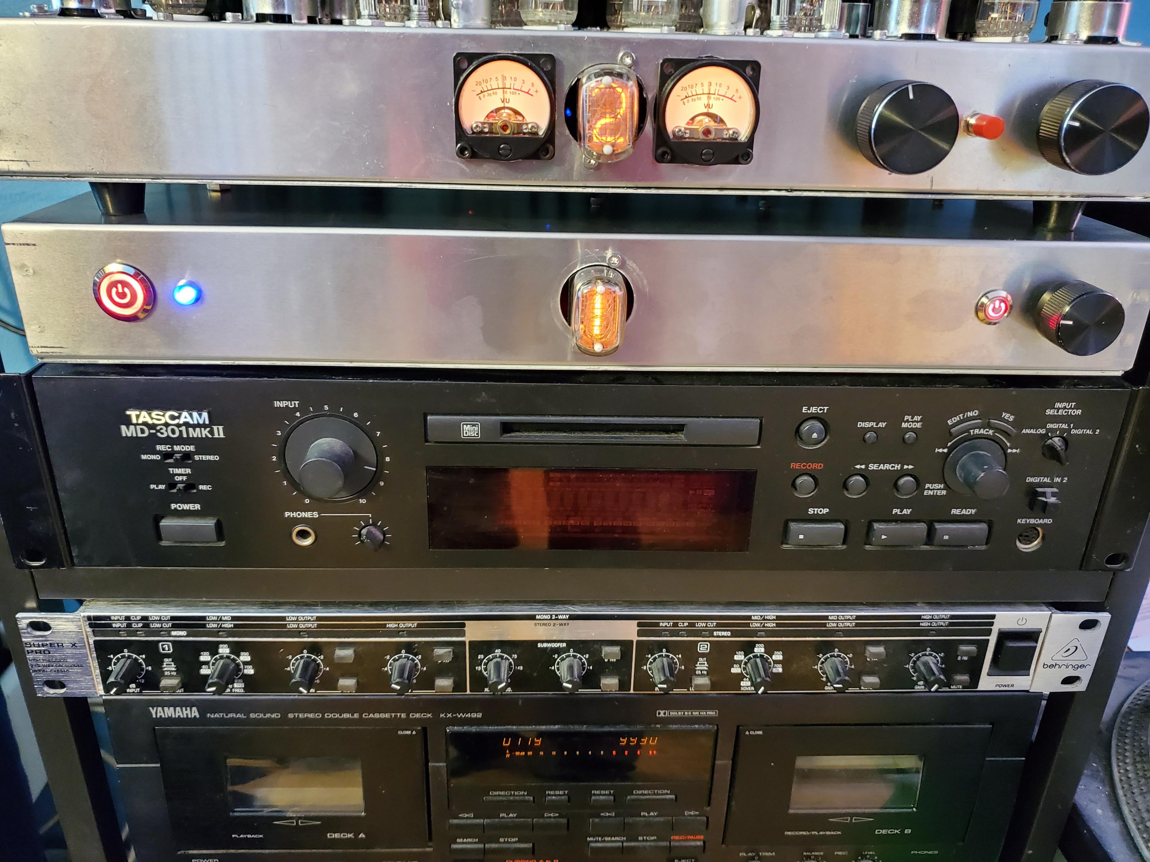

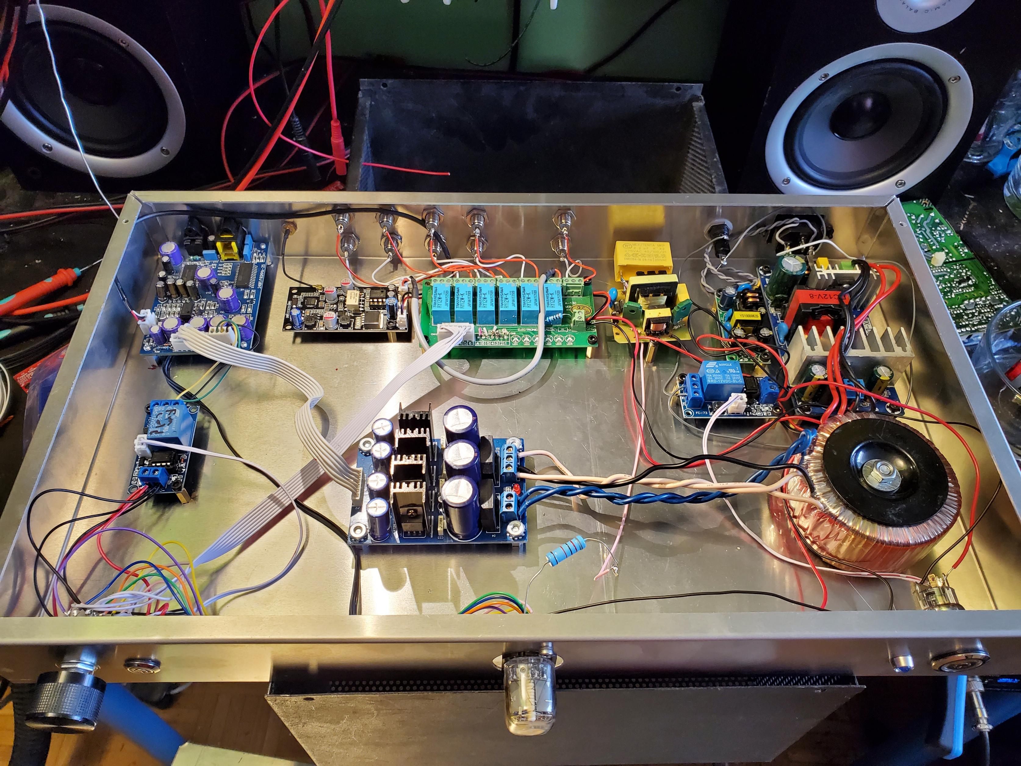

More of a rebuild than a repair, but the hum in the DAC is now gone, and I now have another bluetooth for guests and 5 extra inputs. The only thing I'm missing is an LED to tell you if you have selected optical or coax 🙂
Hi kodabmx,
What is that tube unit on top?
I have the same Nixie tubes (Russian) in my clock (Russian). I don't like the "2", being an upside down "5".
-Chris
-Chris
It's the front of my integrated amp. 🙂
I know what you mean about the upside down five. I've ordered up a couple of IN-8 tubes for my next IA build.
