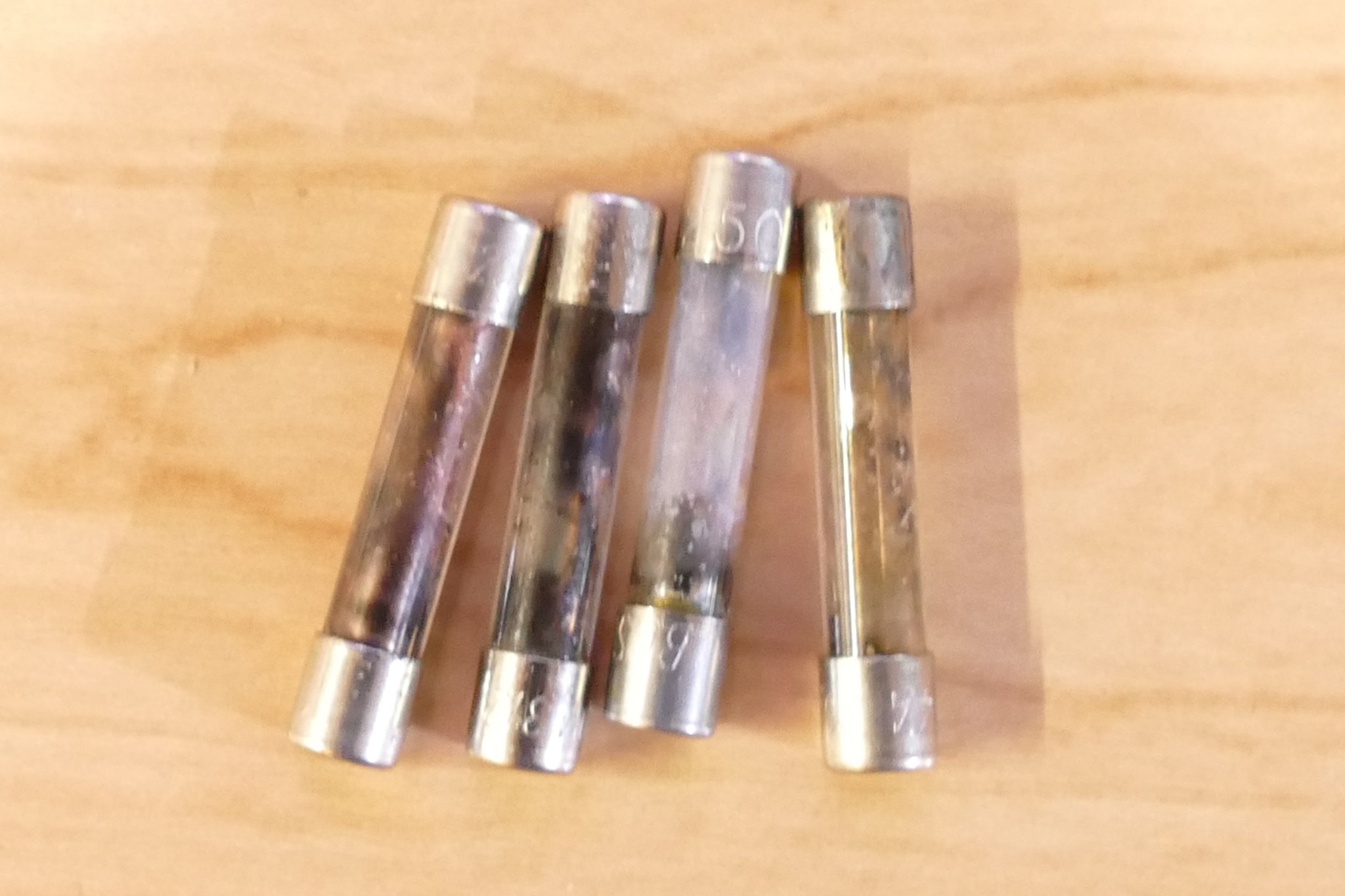

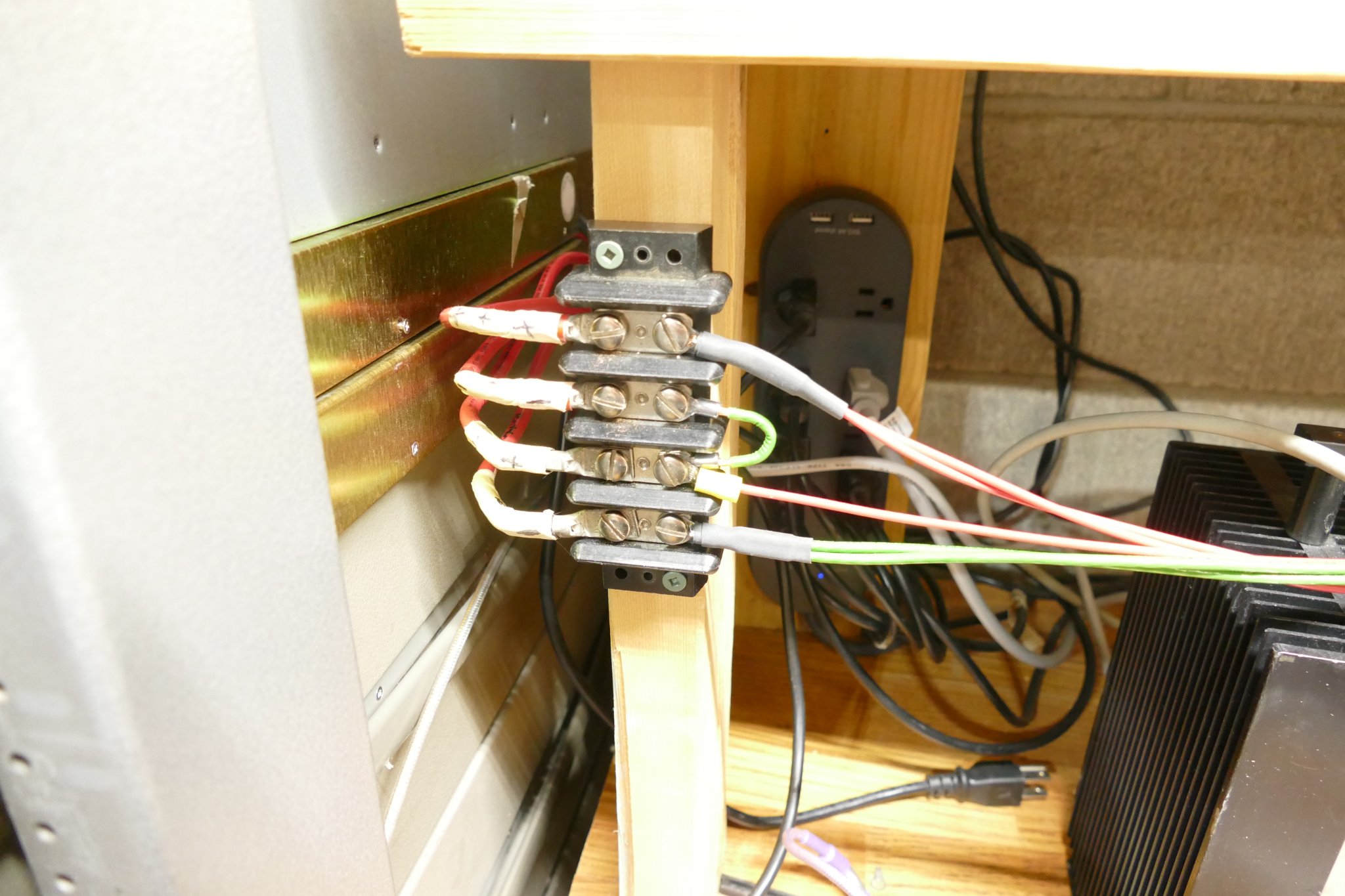

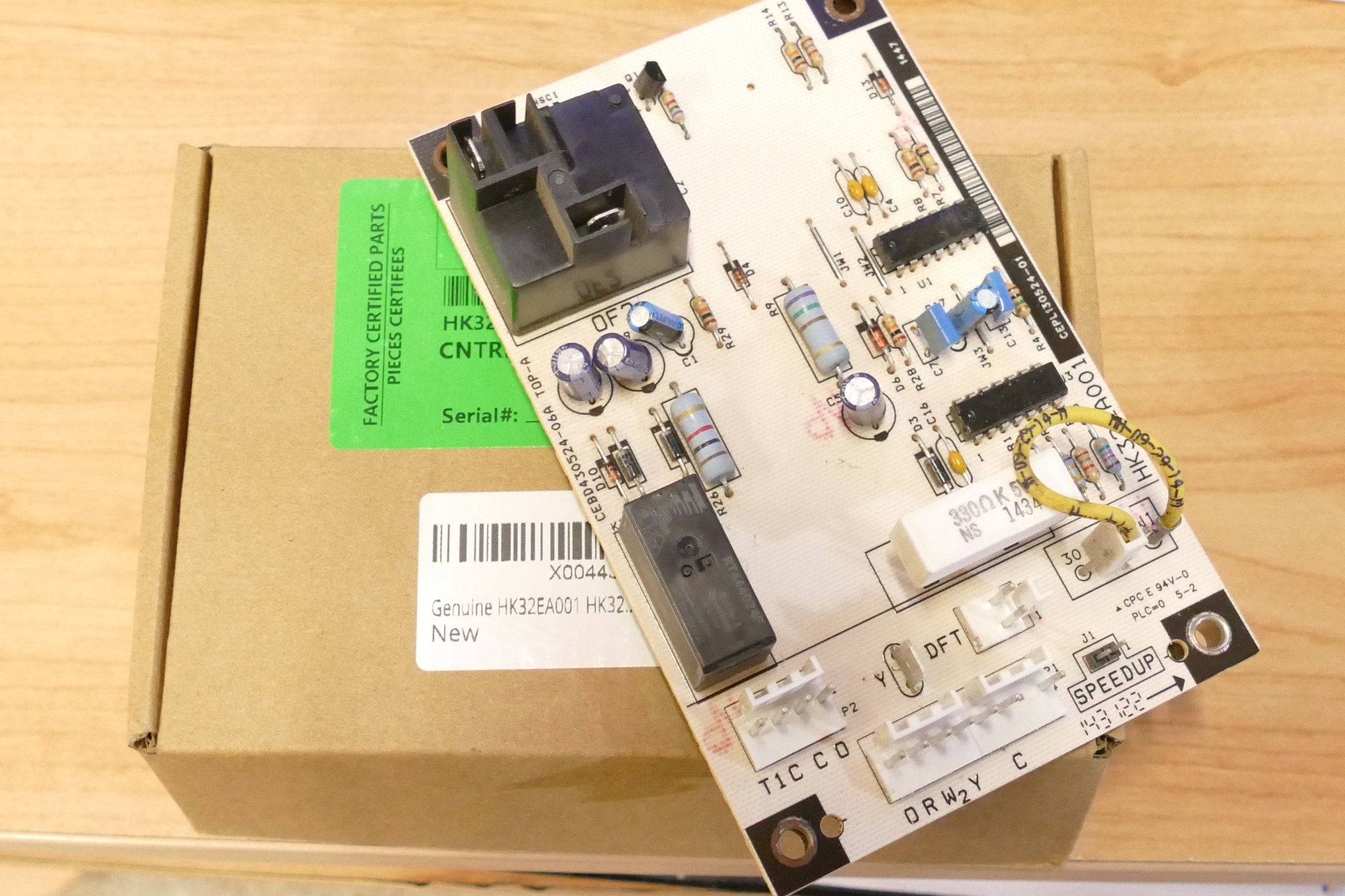

I fixed my 10 year old heat pump. The outside unit would turn into a giant ice cube overnight on a damp cold night. Sometime in late January we had an unknown "electrical event" that blew up a Sony TV, tripped every "arc fault" breaker in the box and severely blew the AC line fuse in all of my 1990's vintage HP RF signal generators. After discovering that my heat pump had a "defrost control board" which could have been blown since that January event. Unlike the blasted fuses, the control board looked OK. The board was over $300 from an AC parts house, with sales restricted to licensed AC contractors only. Amazon had a "Genuine HK32EA001" "Factory Certified" Chinese clone board for $60 so I got one and put it in the unit. The defrost cycle now functions as it should.
The pictures show 4 fuses from the 5 signal generators, the 5th one had shattered, and the old heat pump board on top of the box that the Amazon clone board came in.
I remember being awakened by a bang in the middle of the night in late January. It was not storming or even raining. I didn't see anything unusual, the power was still on so I went back to bed thinking my neighbor had dispatched a snake with his shotgun. There are probably some more dead electronics that haven't been discovered yet.

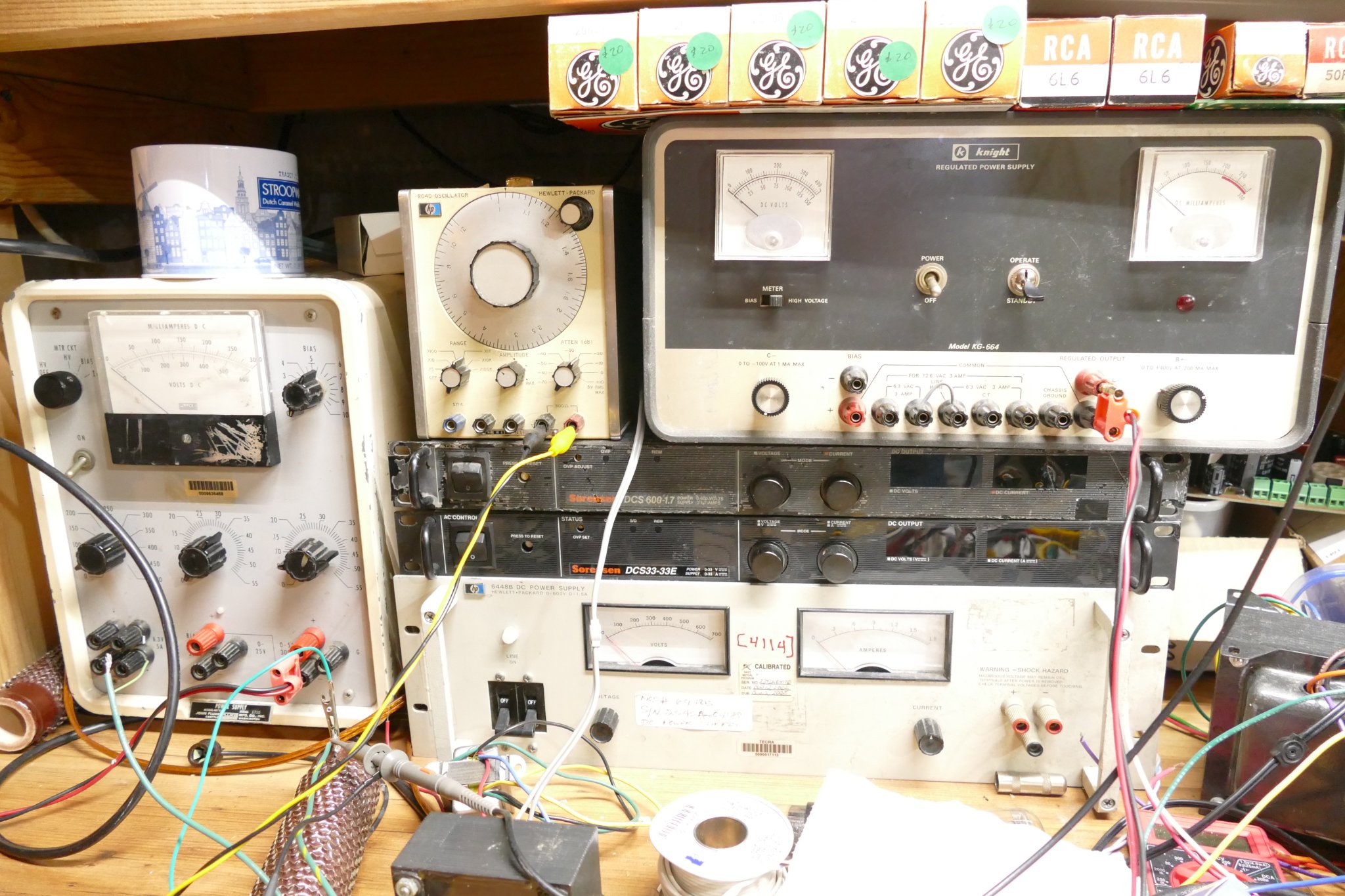

Picked up a "little" Xantrex XKW 600-1.7 for testing some amplifiers. Overkill for sure. The ancient Heathkit and a couple other tube HV regulators work great as well.

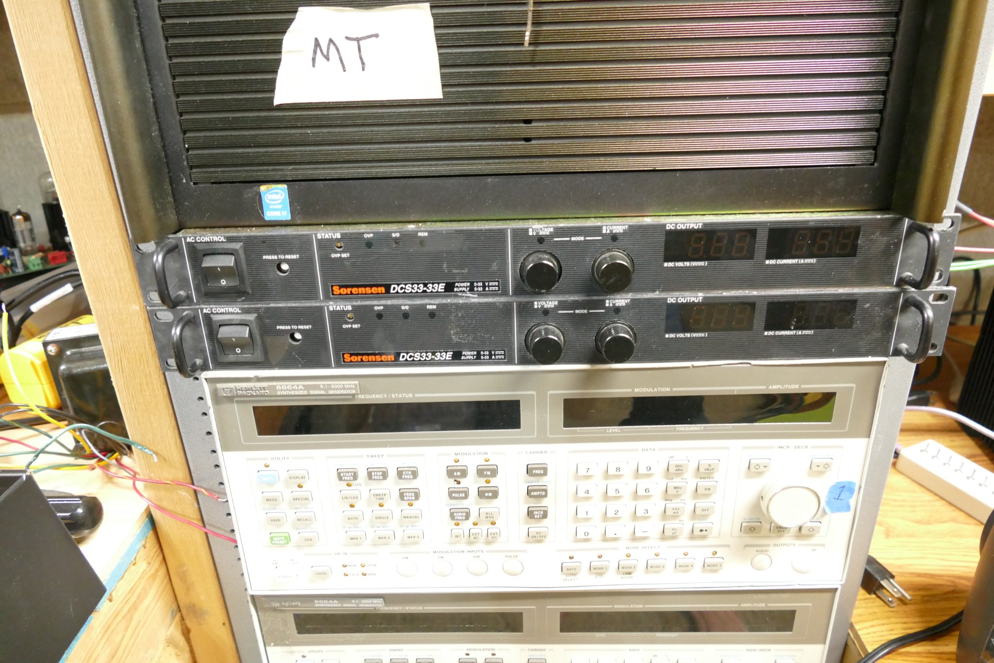

I have a Sorensen DCS 600-1.7 for testing the big stuff somewhat more safely than my other big power supply. The pair of Sorensens have a decent current limiter that is too slow to save a semiconductor when things go wrong, but fast enough to stop a vacuum tube from exploding! The bottom one, a DCS33-33E does 0-33V at 0-33A. There aren't too many tubes that it won't light up. The big bad boy underneath the Sorensens is an old HP6448B 60 Hz switcher. It has 1000uF of capacitance feeding the output (CLC with a pair of 500uF caps). When things go wrong parts, including a pair of 6HJ5's EXPLODE. Plating vanishes from PC boards, bad stuff happens. It has not been used in a long time.

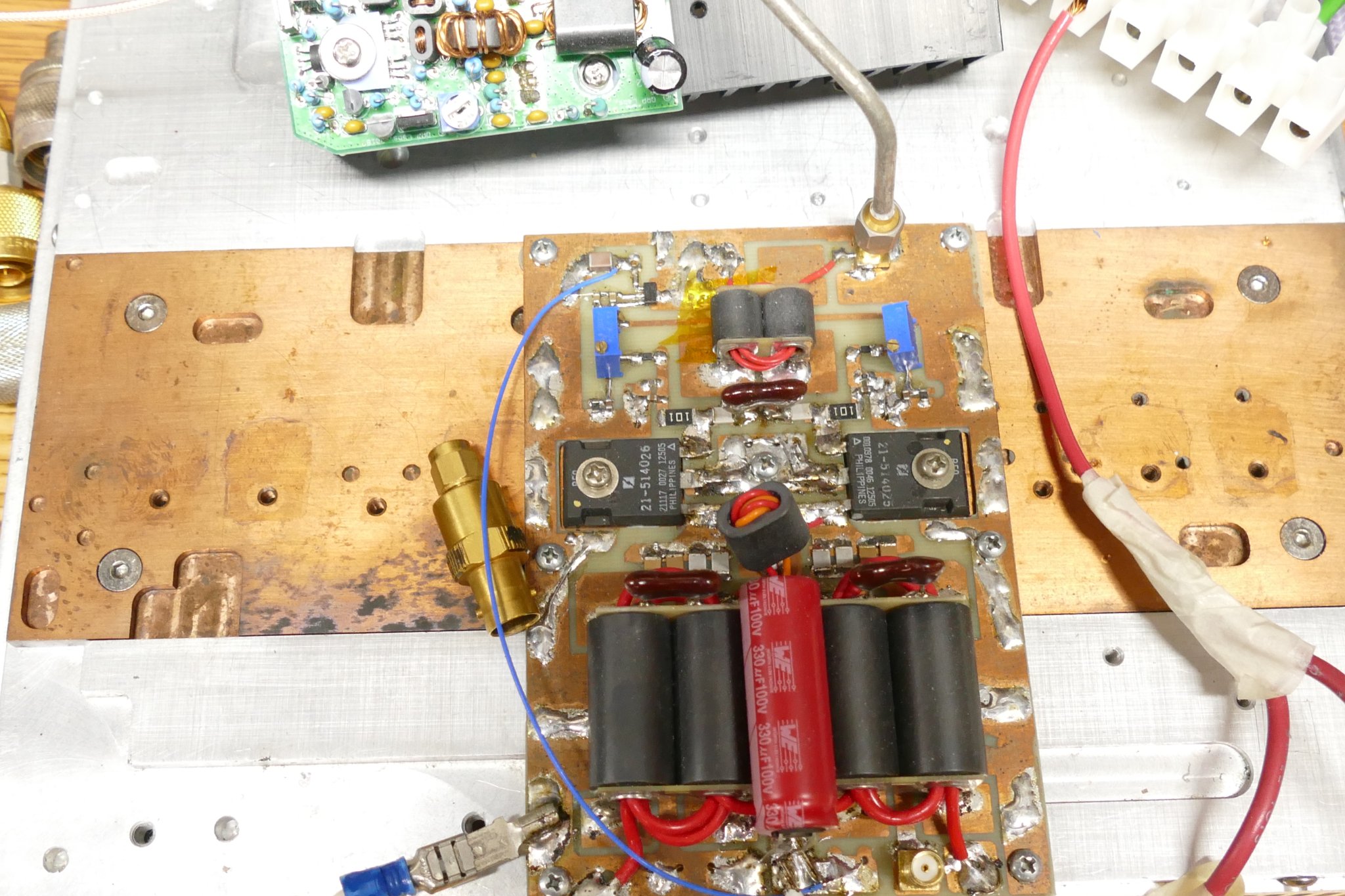

Over on the solid state / RF workbench, there are two more Sorensen DCS33-33Es. They are wired in series so I can get 48 volts at 33 amps. This was used for the design and testing of a 500 watt RF amp with a pair of MHT1803 300 watt RF mosfets for ham radio use on 1.6 to 54 MHz. The little green 10 watt driver board is partially visible. The DCS33-33Es were $100 each, or three for $250. I got 3.

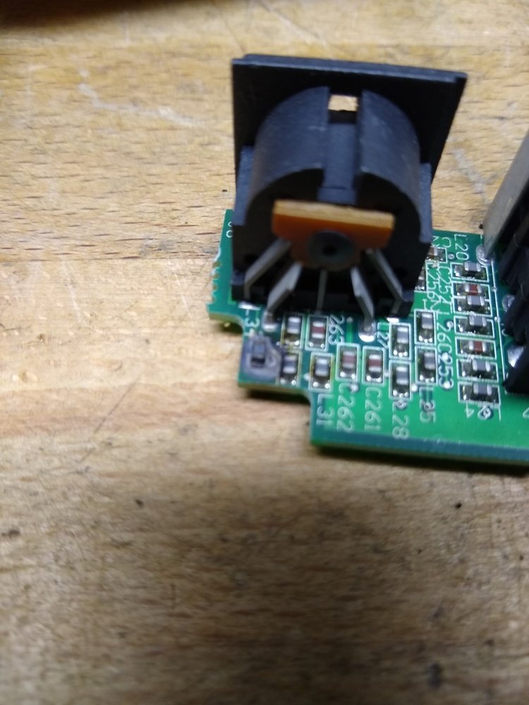

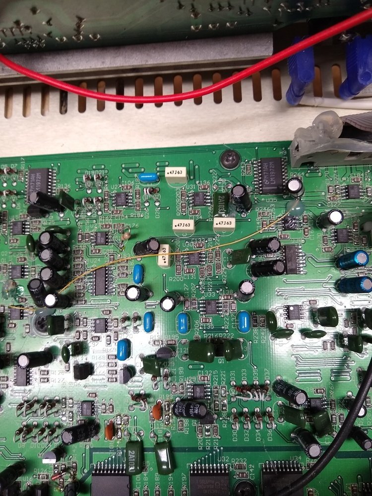

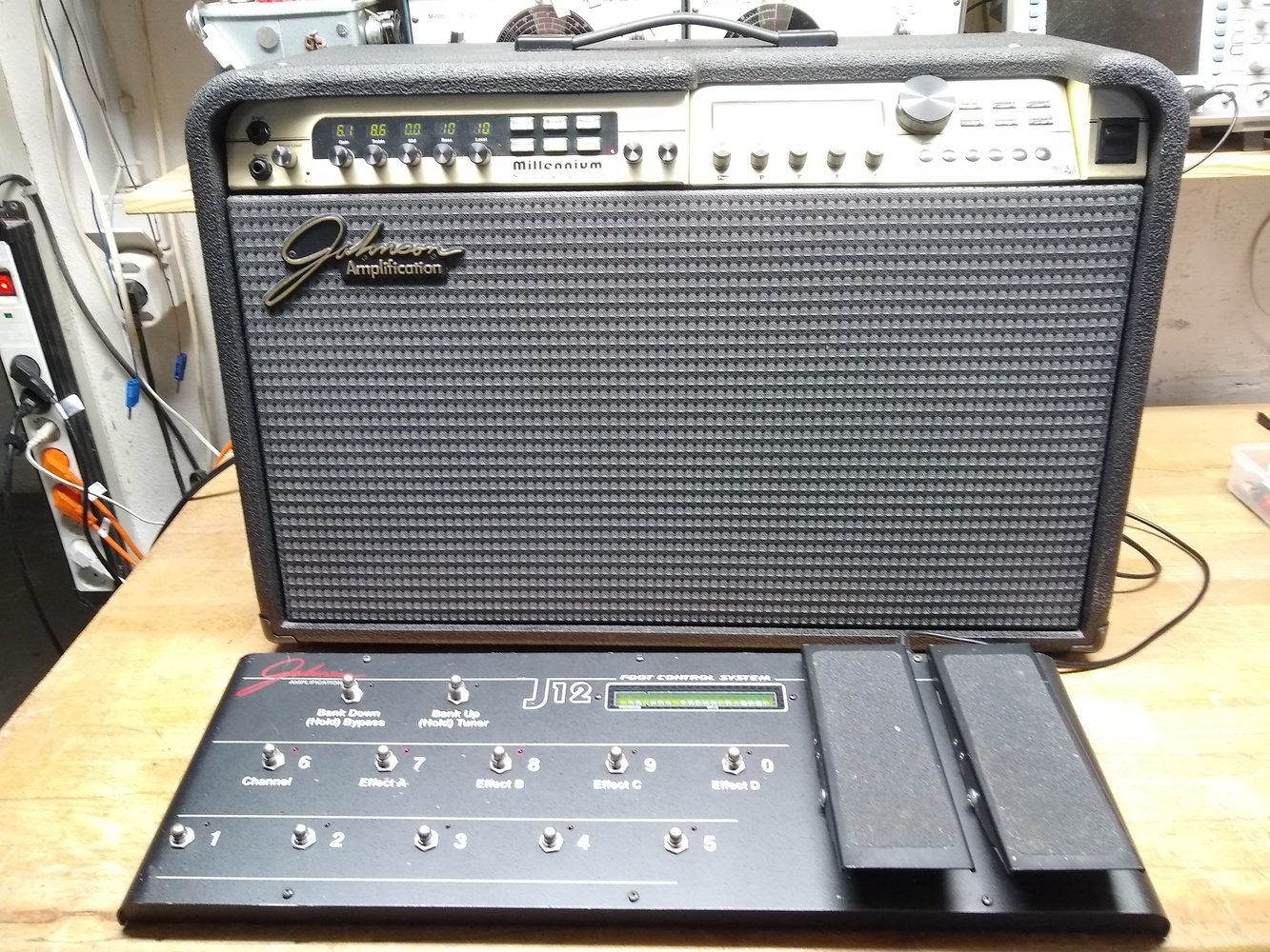

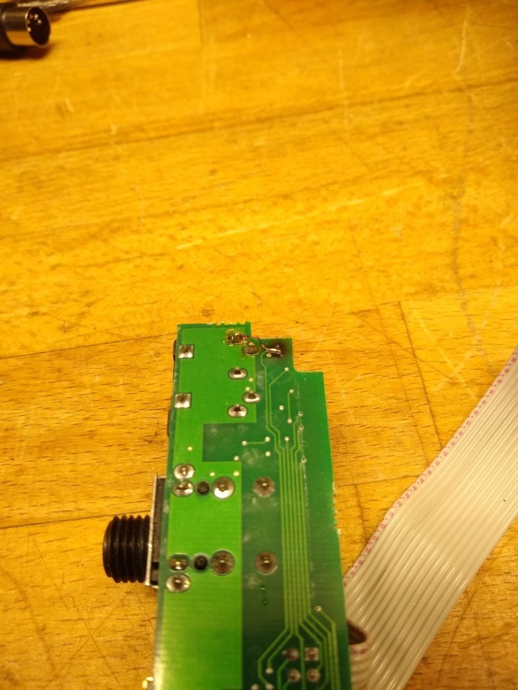

A Johnson Millenium 150 guitar amp recently was on my workbench. This is a stereo guitar combo fitted with 2x 12“ Celestion speakers, providing amp modelling, a multitude of effects and 100 digital stored presets. A nice built sophisticated design and for my knowledge the first commercially available modelling amp which is legendary since. Sadly a very rare bird, production ceased about 20yrs ago, there is not much you can find actually on the internet about it. Luckily two original schematics could be downloaded – otherwise I would have been lost.
The customer said that from that 100 presets only a few were working, i.e. produced any sound although the display showed them all. So I checked the CMOS battery at first. It measured 3,15V – no probs here. Next idea was some defunct CMOS multiplexers that might have burnt. I made a list of them, checked them – and everything looked fine. Running out of ideas I played with the front knobs and discovered that the few working presets all used the first amp model and channel B. So I decided to trace the hole signal path inserting a sine wave into the input jack and monitoring all stages with a signal monitor. In that case simply a tiny guitar practice amp. At the end I found a broken connection in the analog front end, connected with a patch wire and all the presets were back again.
Next issue was the „dead“ foot controller board. This is connected via MIDI cable. There was no 5V supply powering the controller. Tracing this back I ended at the MIDI pcb of the amp and discovered a melted down ferrite-bead in the +5V rail. Replaced it with some patch wire and that did the trick. I guess some cable short-circuit caused this failure.
All in all re-animation of this baby took a hole day and a night to make the customer happy again.
