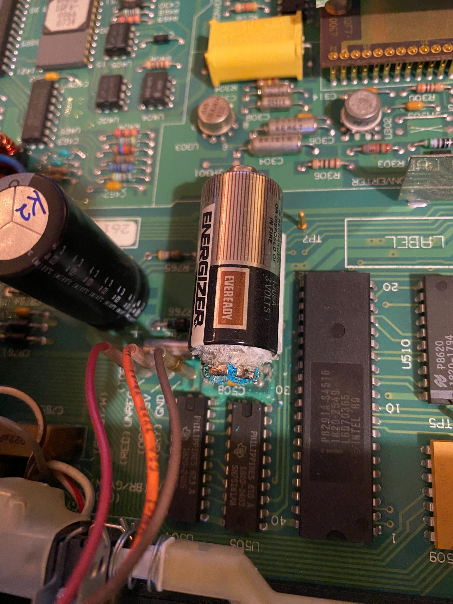

Finished up repairing and calibrating one of my HP3478A Multimeters. I was unaware a previous owner had put a 3 volt alkaline battery in the unit instead of a lithium one... The alkaline puked and all the calibration constants went bye-bye. So I replaced the battery with a proper lithium cell and also replaced the four RIFA caps per advice from forum folk. Just finished up doing a good enough, but non-traceable calibration following the HP manual instructions. Went pretty well. I used my Keithley 2015 meter as a check for the values.
"Self Test OK" is great to see upon power up!
Now I will go after the battery and caps in my second 3478A, which is behaving great thus far. Just need to assure power to the cal constant's memory while doing the job 🙂 (I have a plan for that)

Yup. Use another Lithium battery with wire leads, 10K in one lead. Solder across the old battery (different contacts). Now you can pull the old battery and install the new one without losing anything.
Using a power supply risks dropping a lead and losing the cal constants. 100% success rate doing this, I have a cell with wire leads soldered on for this purpose.

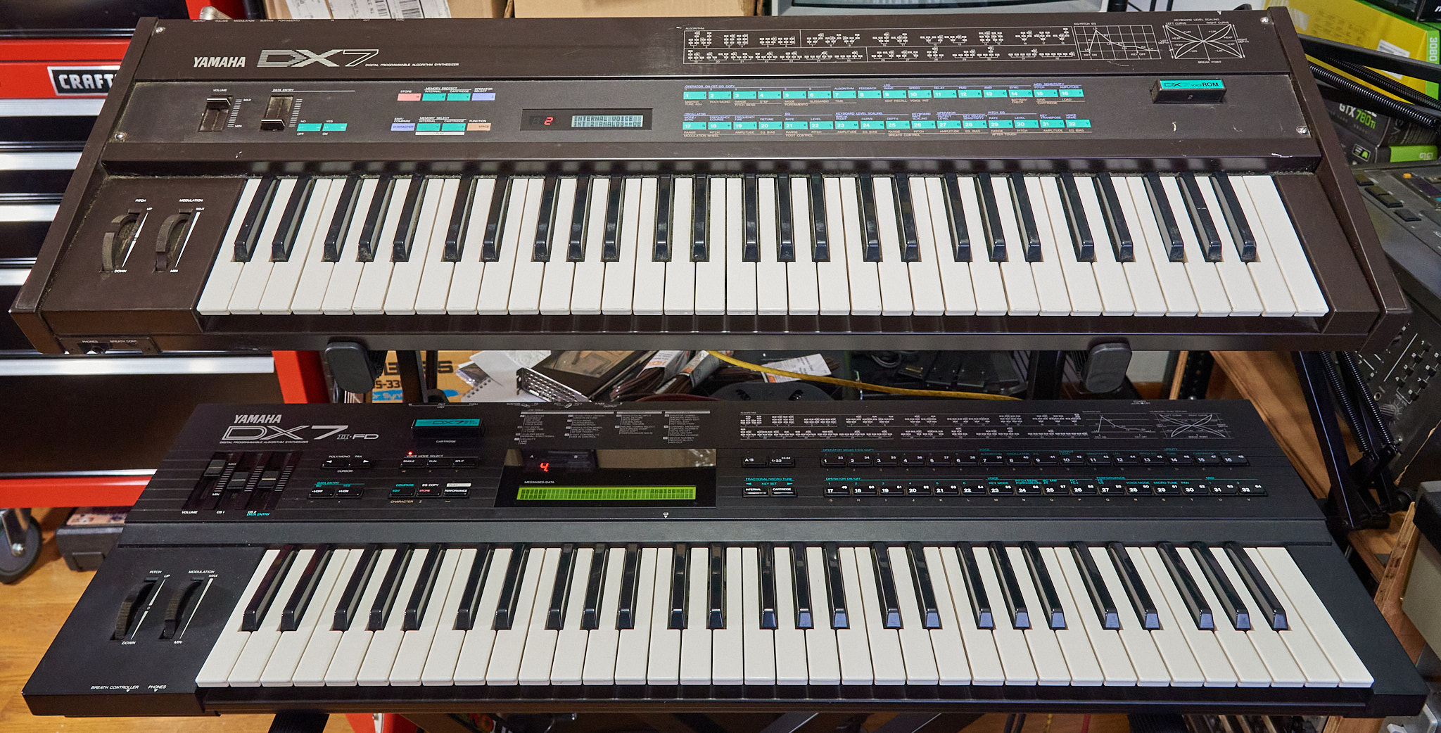

Hey, I've got a pair of those!
Top: DX7 (mk1)
Bottom: DX7II-FD
Programming sounds on them is quite a challenge since it's a menu-driven hell. Someone somewhere said, "It's like painting the hallway through the mail slot." Most people probably just used presets, though making your own sounds is quite fascinating once you learn how to do it.

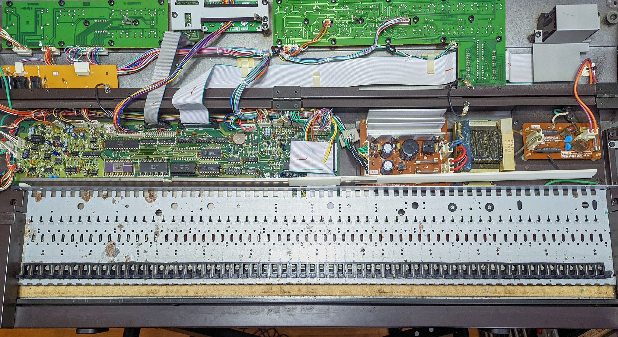

The mk1 was filthy when I got it. There was a lot of corrosion under the keys, and one of the keys didn't work. I completely disassembled the keybed, and I found that the faulty key had a broken contact spring due to the corrosion. Fortunately, the break was near the PCB connection, so I just bypassed it with a wire.

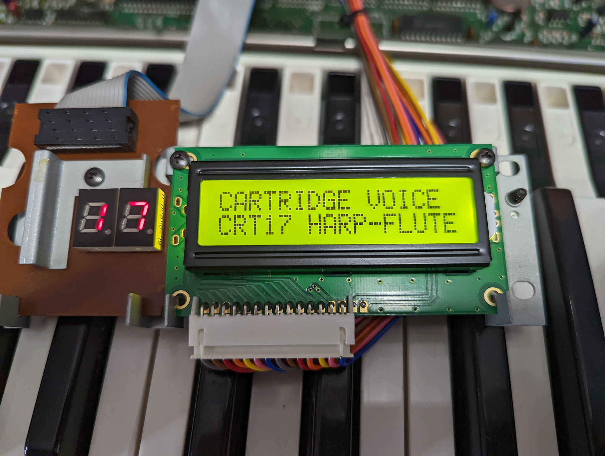

I also replaced the LCD with one that has a backlight. It doesn't fit perfectly (a little too tall), but it's nice to be able to read the screen in a dim room.

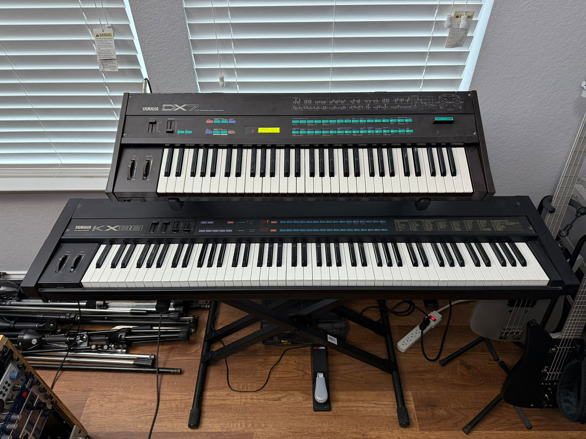

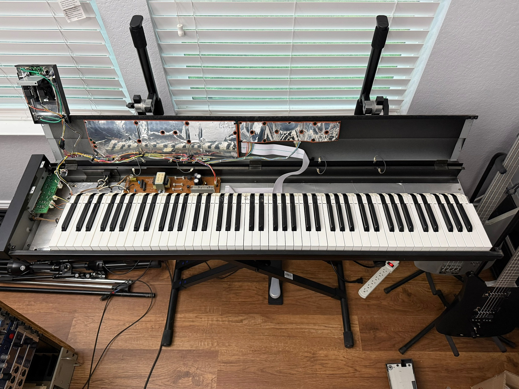

Current project: Yamaha KX88
This thing is a beast! A DX7 is not a small or light keyboard, but the KX88 completely dwarfs it. I'm glad I finally have a full 88-key controller with weighted keys. It makes playing piano feel that much more expressive.
This KX88 isn't in the greatest condition. The membrane panel has a few holes and cracks in it. Fortunately everything works. The interior is very similar to the DX7. I think some of the parts are interchangeable.

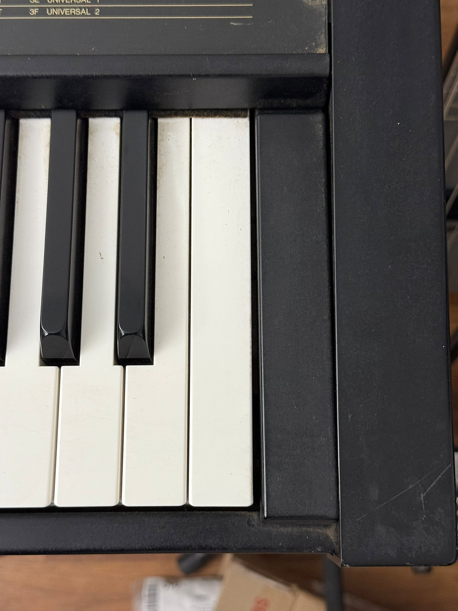

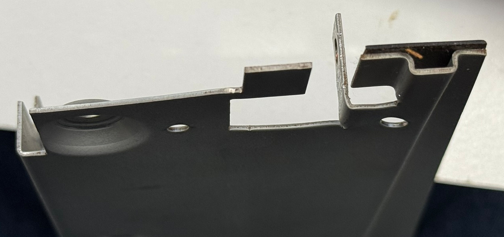

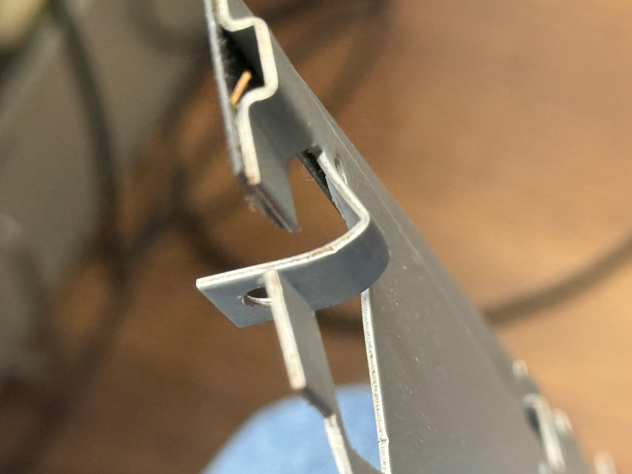

When it arrived, the top two keys were sticking down. The right front corner had some impact damage, and this caused the cheek piece to squeeze the top two keys together. I removed the right end cap and found that the mounting tab was bent.
I fixed it with pliers, and now there is a gap between the cheek and the top key.
I also replaced the power connector with a grounded IEC socket. The original was neither grounded nor polarized. If the input cap or something else shorted, the metal top could be live!
Anyway, the KX88 is up and running again. The next step is to disassemble, clean, and lubricate the whole keybed. There are a few keys that feel a bit stickier than others.

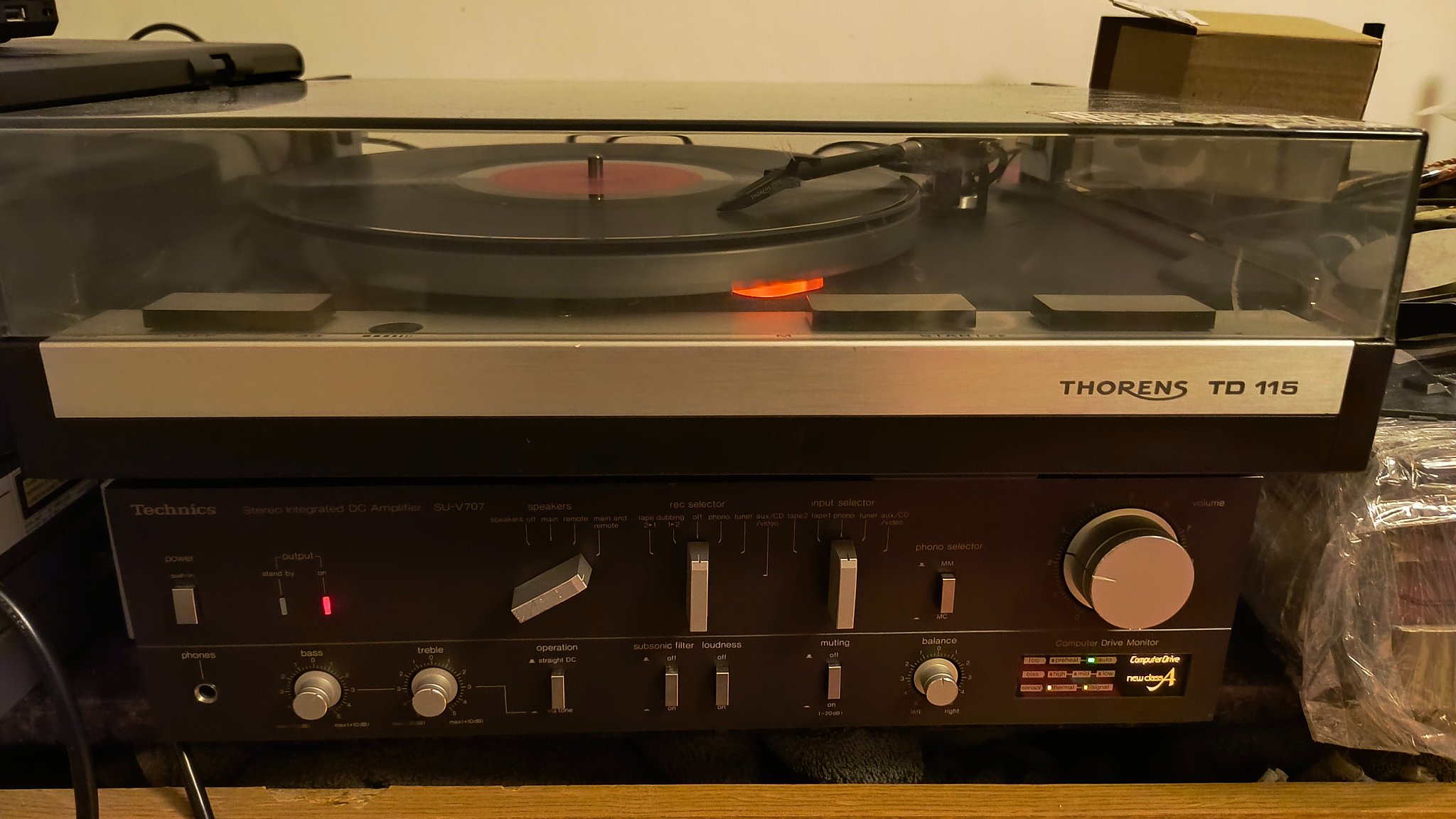

One Thorens TD-115. Actually the first Thorens on my bench. Visually kinda compatible with my Technics amp. Sad It is it is not mine.
Came to my hands with "skipping" fault. Turned out to be an overhaul, as it was needed to keep the unit alive.
- recap
- bearing cleaning and lubing
- new belts (thank you Thakker for having a set of the two)
- cueing mechanism cleaning and lubing again (finally found out that RC model differential high viscosity silicone oil does the job)
- deteriorated foam dampers in springed feet redone
- messed up autostop aligned
- basic clean
- speed adjustment pots replaced
- motor oiled
- rubber rejuvenator applied to the motor holder to regain it's flexibility
...plus some standard fuss.
I must say this TT sounds wonderful now. Hats down to Thorens engineers. But a lot of work to make the thing singing again.

You want to track slightly on the heavy side. Tracking too light is more likely to damage your records. So if the range is 1 ~ 2 grams tracking, slightly over 1.5 gr would be better, and nothing wrong with 1.75 gr.
Yes, that is the low mass arm. I have a similar one on the TD-126 MKII I use.
