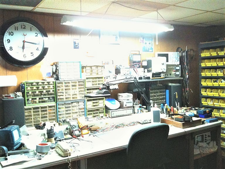

That is a pretty cool clock, though. Does yours have the little thumbwheel feature to kick-start the synchro motor so it doesn't run backwards?

Yes Jim, it's got the original kick-start synchronous motor and it runs perfectly.That is a pretty cool clock, though. Does yours have the little thumbwheel feature to kick-start the synchro motor so it doesn't run backwards?
I always know I'm worklng on a really, really old Hammond organ when the boilerplate inside still reads Hammond Clock Company.
All brass gears too.

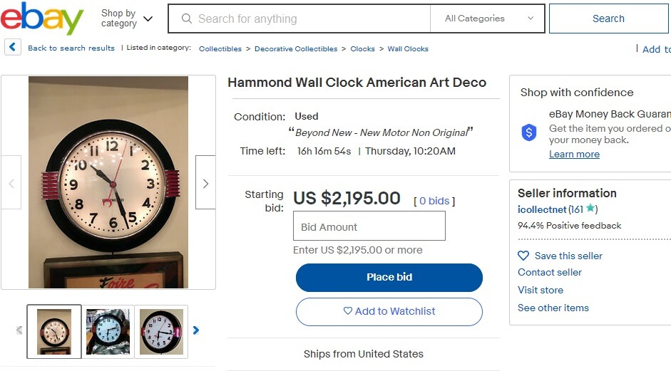

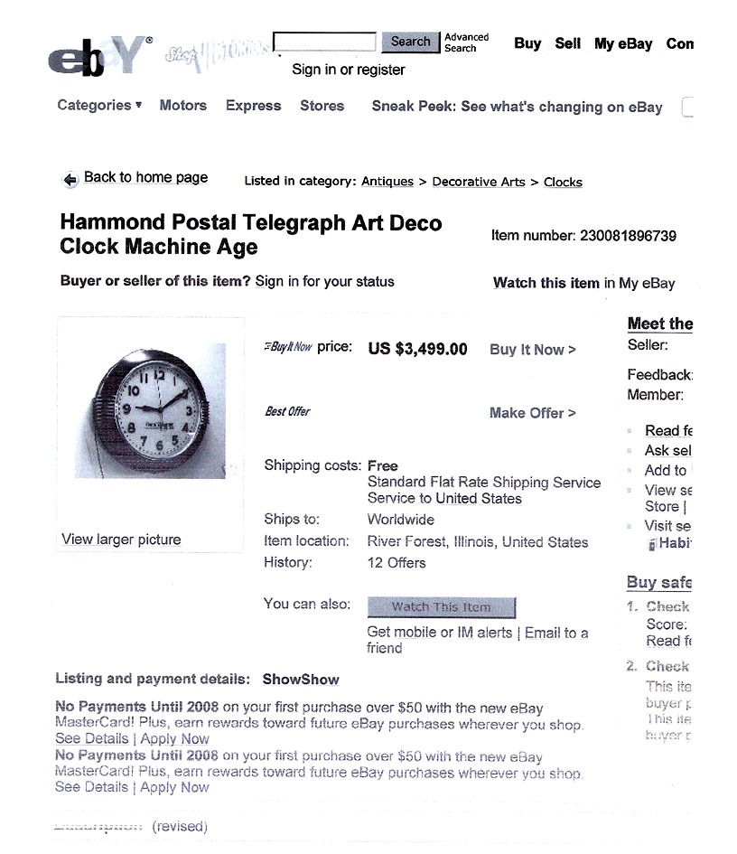

Here's a current ebay listing for one.. apparently they seem to go for high prices.

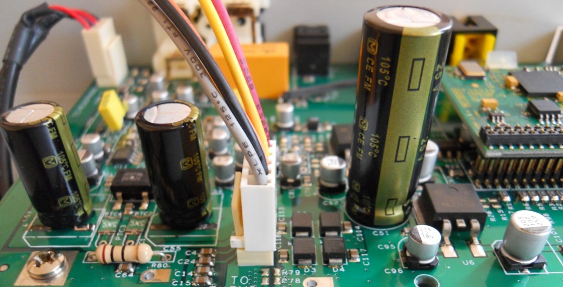

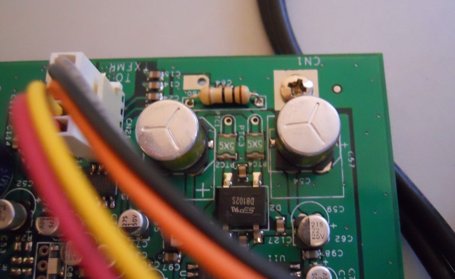

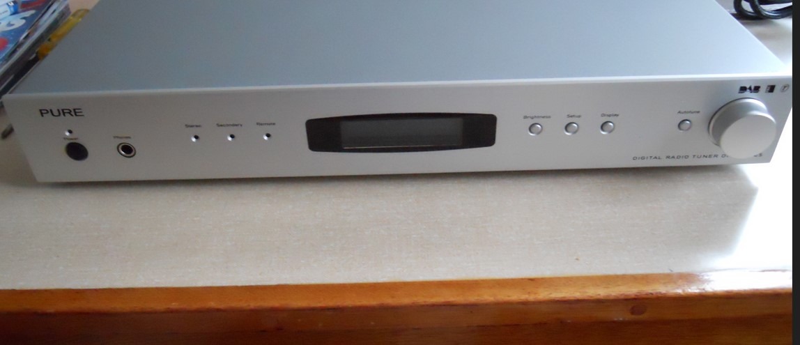

My beloved Pure DRX-701ES DAB tuner had a little attention today. The caps in the PSU have been known to cause trouble and the two 470uF/25v reservoir caps were slightly bulged on top. The 2200uF 25v also got replaced. The board was already drilled out for leaded parts and so these are what I fitted, some quality Panasonic 35v replacements. Those odd looking do-dahs between the caps are marked on the board as PTH so presumably some surge limiting thermistors.

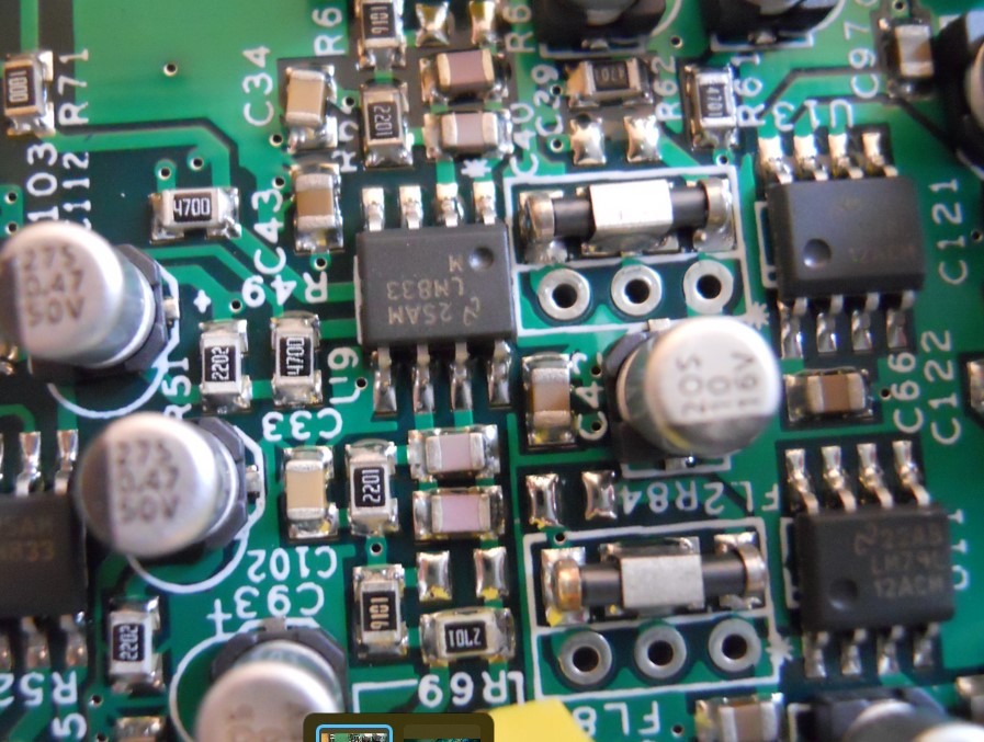

The opamp's which were generic something or others got swapped a few years back for LM833's (not the old LM833N but the TI upgrade which uses a quasi complementary NPN output stage). These are an under rated chip imo. The chip removal and soldering was all done by hand using a Philips soldering station and large bit.
I should have measured those curious looking things next to that particular LM833. Could be some kind of filter or coil. Seems to be one for each channel.

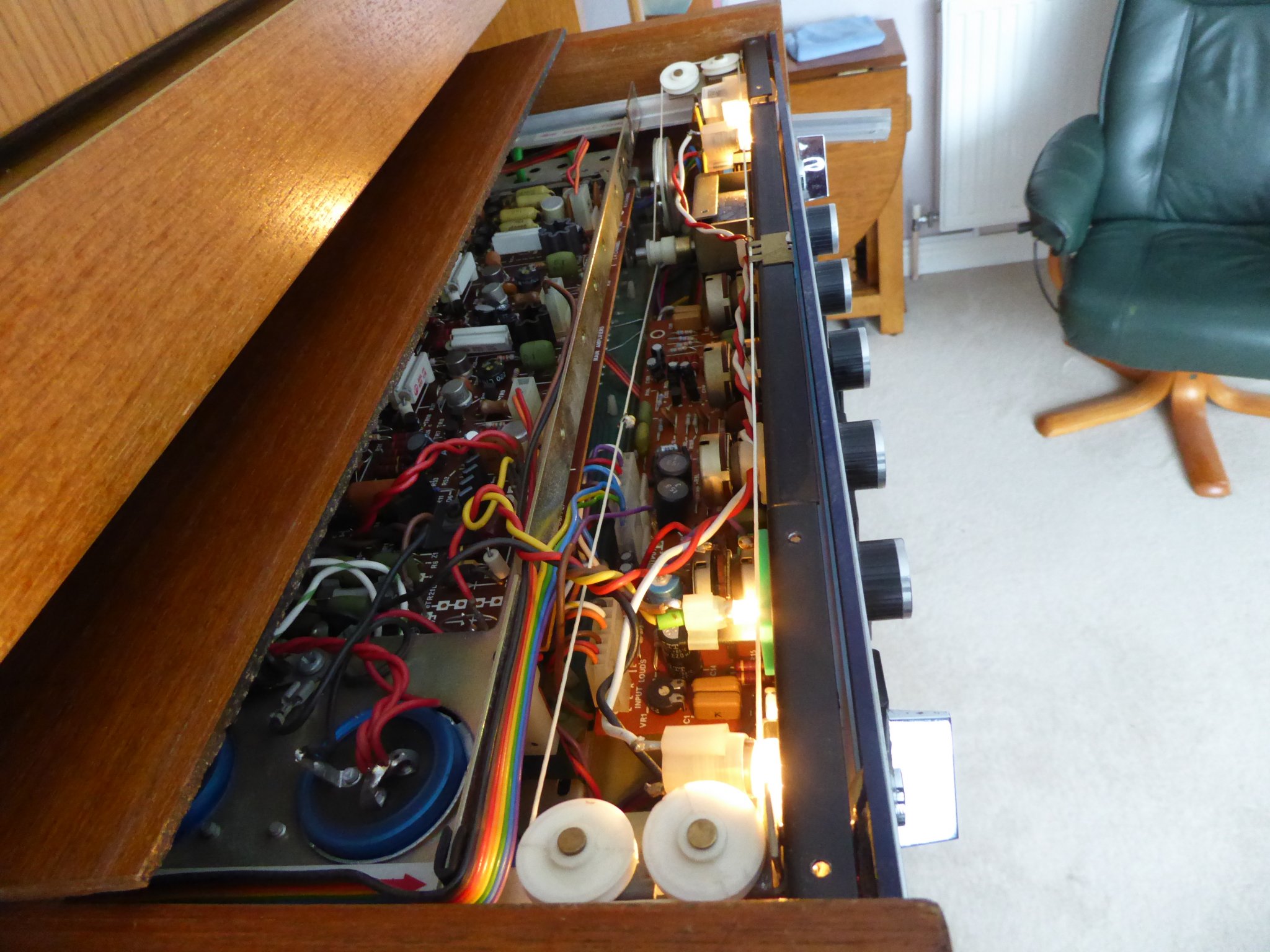

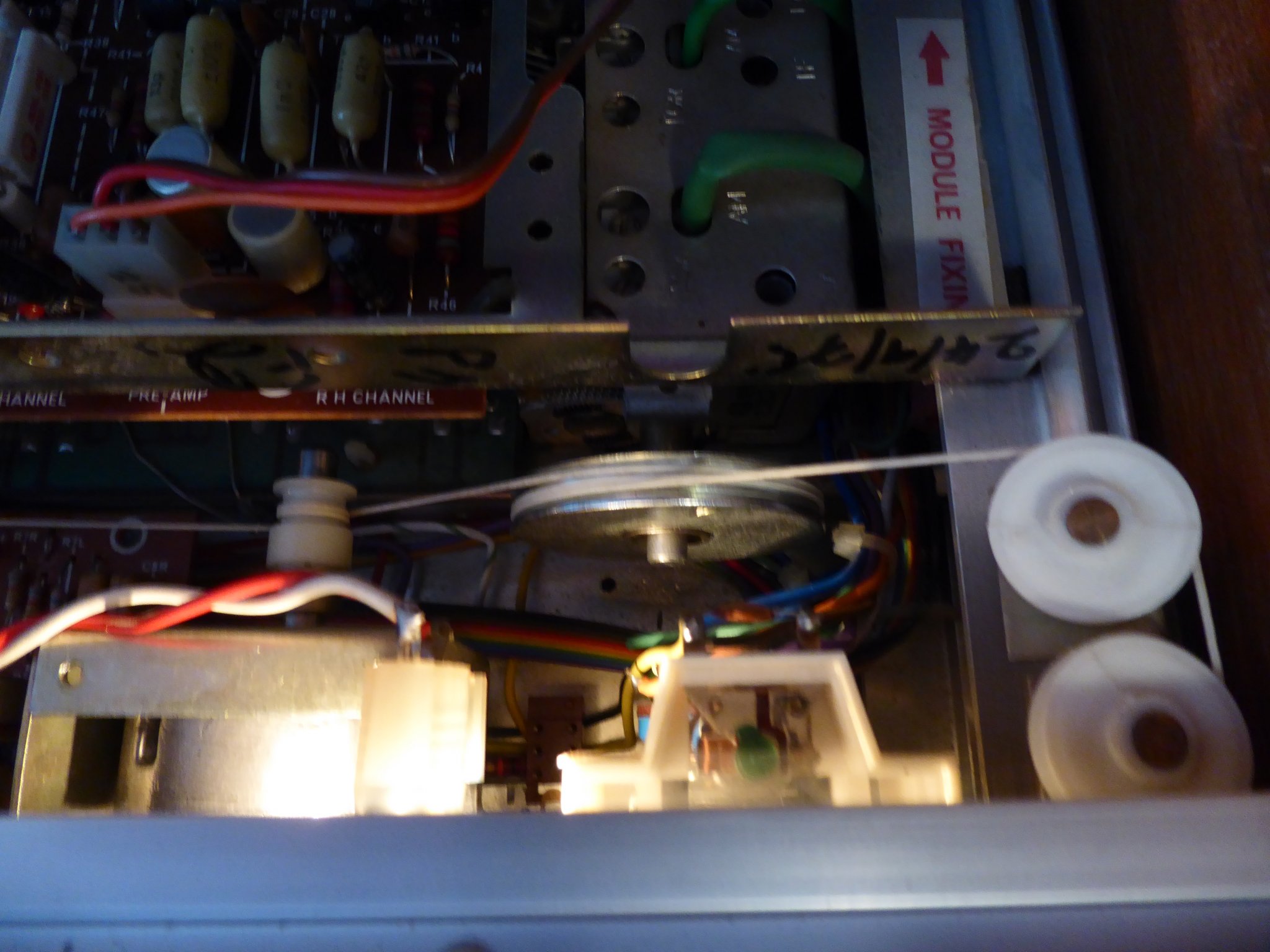

I s'ppose you could call it a repair, I've a Leak 2000 tuner/amp and the dial cord got detached somehow. I turned the tuning knob and found it wasn't working.
What I found when I removed the top of the cabbnet was a ball of cord up one end of the set.
I've a service manual which has a whole page devoted to the tuning cord and "how to replace it using the special tool." Which I didn't have.
It's impossible to get your fingers down here.
I managed to get it back on by making a tool from a piece of garden wire forming a loop at one end and using this to wind the cord back round the two spindles. At least the manual told me how many turns around each and in which direction, Then just a case of looping the cord around the four jockey wheels.
During the proceess I'd moved the tuning gang slightly. The "special tool" would have keept it in place. But it was easy enough to unhook one side of the pointer bracket and slide it about a centimetre to give a true reading. Whilst reading the manual I found out what the mute control was for when setting the AFC. I'd had this second-hand tuner/amp for fifteen years and had never before bothered to find out what it was for.
It must be near fifty years old now and still working. Though I recently bought another cheaply, as a spare. This one had started "motorboating." But they couldn't find anything wrong with it. It might have been a capacitor picking up something from some of my other stuff.
They don't make 'em like they used to.

I've done many "dial cord" jobs over the years, they can be nerve racking sometimes, and cause me to spew choice vile language.I s'ppose you could call it a repair, I've a Leak 2000 tuner/amp and the dial cord got detached somehow. I turned the tuning knob and found it wasn't working.
Some, without available stringing instructions - those you just need to sit and study how the cord is routed.
That Leak receiver would be an easy job for me.
And then there are those vintage tuner-preamps that have multiple cord drives, one for the tuning scale, and several others for indicators like bass-treble-balance like Zenith and RCA Victor did.
You turned the bass etc knob, and an illuminated "pointer" would glow through a small rotary dial and visually tell you the setting. - fancy stuff indeed.
But some of the worst re-stringing jobs were those German radio sets from the 1950's and 60's! - Blaupunkt, Grundig, Normandy, etc.
You had to deal with shiifting clutch assemblies, steel wire cords, and critical winding around tuner pulley assemblies.
Those...... caused a lot.... a lot, of cursing in the shop!
I learned to be a skilled contortionist with a filthy mouth.
