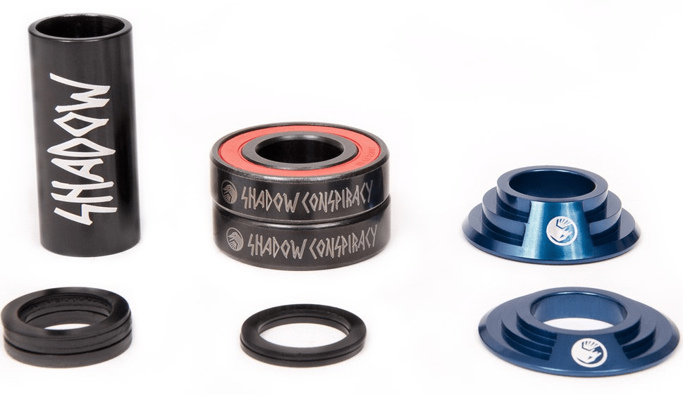

I've been running the same sealed Mid BB on my bike that it came with in 2005. OTOH, BMX tend to stand up to hard use...
They press in like on a car...
The seals are the reason for longevity, they protect the metal from moisture, and possibly salty moisture from roads covered with salt in winter.
Use good quality seals the next time you do maintenance...
Use them at both sides of the shaft., where it comes out of the frame.
And try to put FAG, SKF, Timken or NTN bearings, or those from a reputed supplier. Use the 2 rubber seal type as in above photo.
Like capacitors, bearings also come in different quality types, from superlative to scrap.

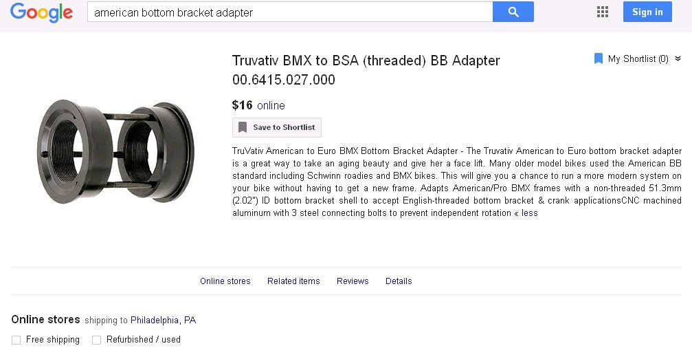

I had to switch out the American BB on my Murray bike in order to change the pedal arangement.
I got this, works great, easy to install, and can use the european cranks.

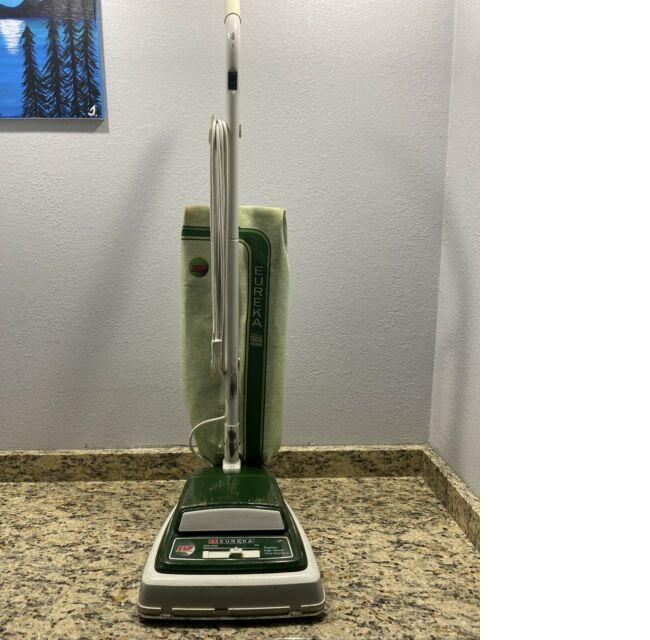

I'm Old School and staying there.

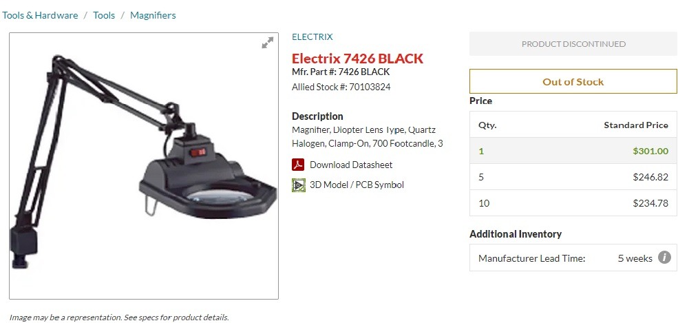

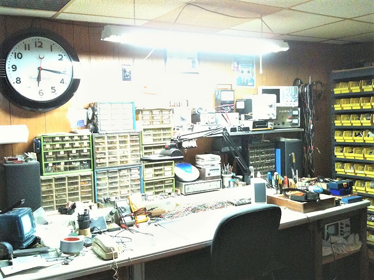

Well, the latest thing on ON THE BENCH today is my over-the-bench swing-arm lamp/magnifier.
I've had it ever since at the shop, and now use it over my basement workbench.
Industrial design Electrix model 7426. (West Haven CT.)
The lamp uses a DC bayonet halogen 100w bulb - they cost $17 each to replace.
The fixture itself is expensive, I'd bet no one on here has one on their bench.
But for the price, it has its design issues.
So, after 2 bulbs overheated and died, I decided to.... OMG!..... Modify the damn thing.
For a standard 100w screw in bulb. (much cheaper)
There is enough room "under the hood" so why not?
Now it puts out the same amount of light, and uses the common lamp bulbs - and I'm happy.
