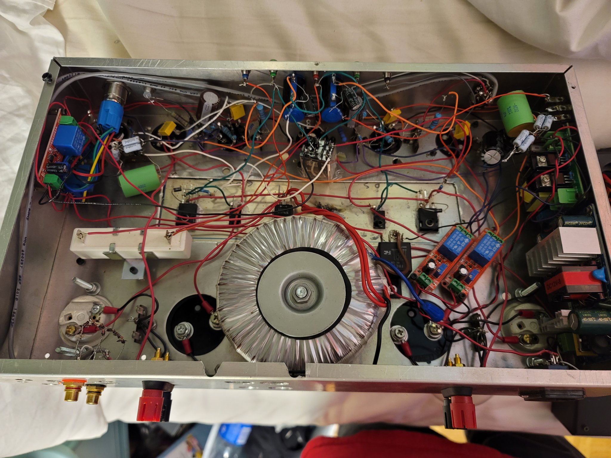

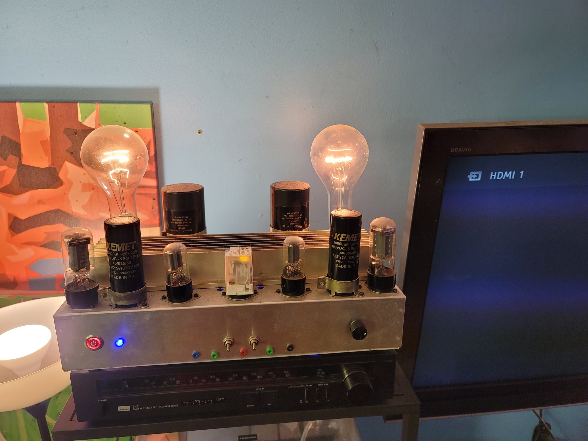

I just got to repair my "light bulb amp"... I didn't ground the jacks to the case on this one so when I decided to swap left and right RCA cables, I got a 60Hz buzz at full blast and it too out the left channel MOSFET... I had a spare so 15 minutes later it works again
The burn mark on the heatsink is why I'm using that giant cement resistor - apparently the TO-220 doesn't like the start up surge...

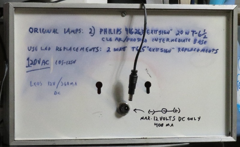

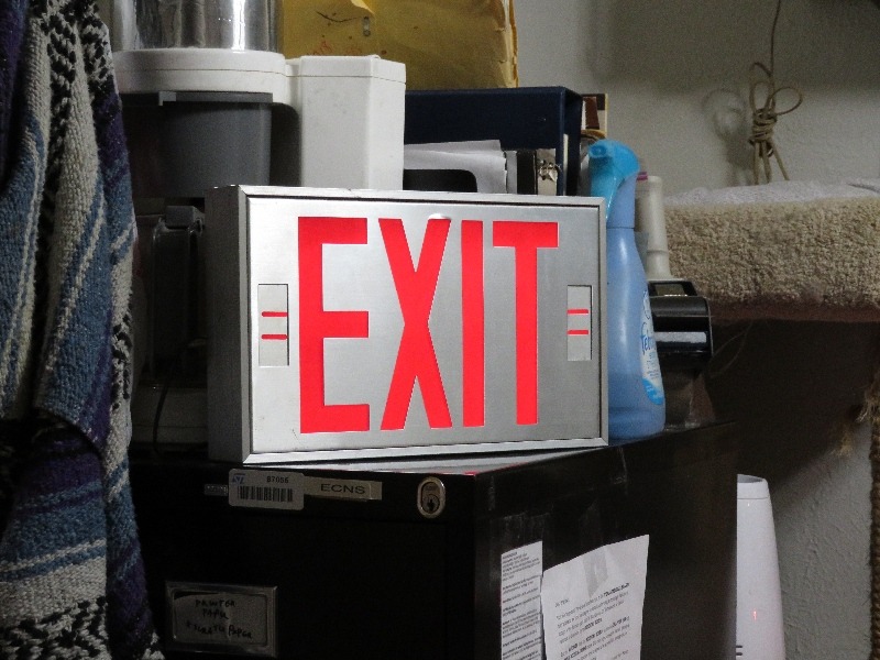

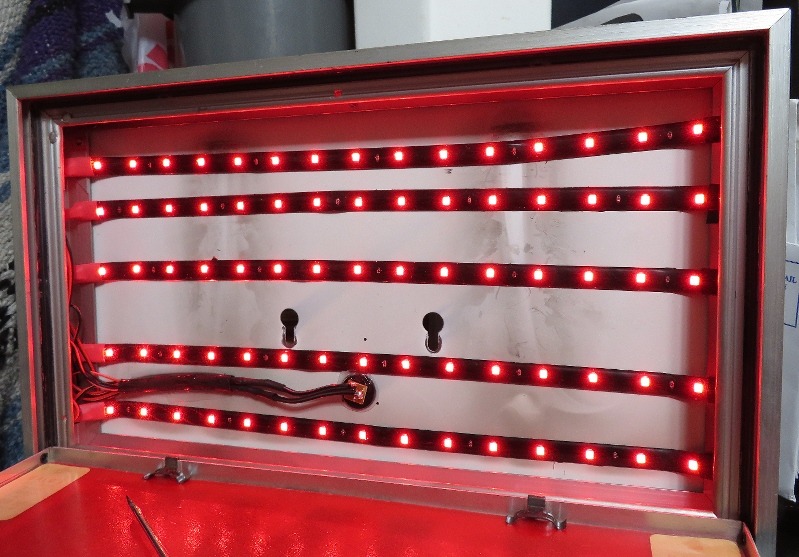

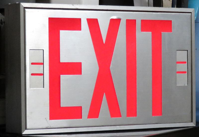

Recently I "repaired" a pile of old all-metal 1960s illuminated theatre exit sign to disuse the original 20W frosted T-6 1/2 intermediate base tubular lamps, which are an odd size and now costly, at $4 to $7 each, as are the replacement screw-in LED replacement bulbs. The signs themselves were free from a cleanout of an estate. They were to be thrown out.. Not so fast!
After the lamps and their sockets were removed and the fixtures completely disassembled, there was so mych dust and dirt. Every piece was totally cleaned including the red translucent panel that forms the letters through the cutout aluminum front. Five rows of 12V 70mA 12" red LED strips from ebay were installed in the back of each sign, for more uniform back-lighting. The original lamps had given an uneven distribution of light across the red letters of the sign. A DC jack was added on the back of the sign to fit the plug on a brick-type 12V 1A power supply.
