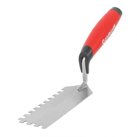

I used a very good quality wood glue between my two panels. I then clamped them together. Then I also used enough wood screws to ensure a uniform binding force. I did use a trowel with spacings like one would use when cementing ceramic tiles. Perhaps the is the main difference here???
