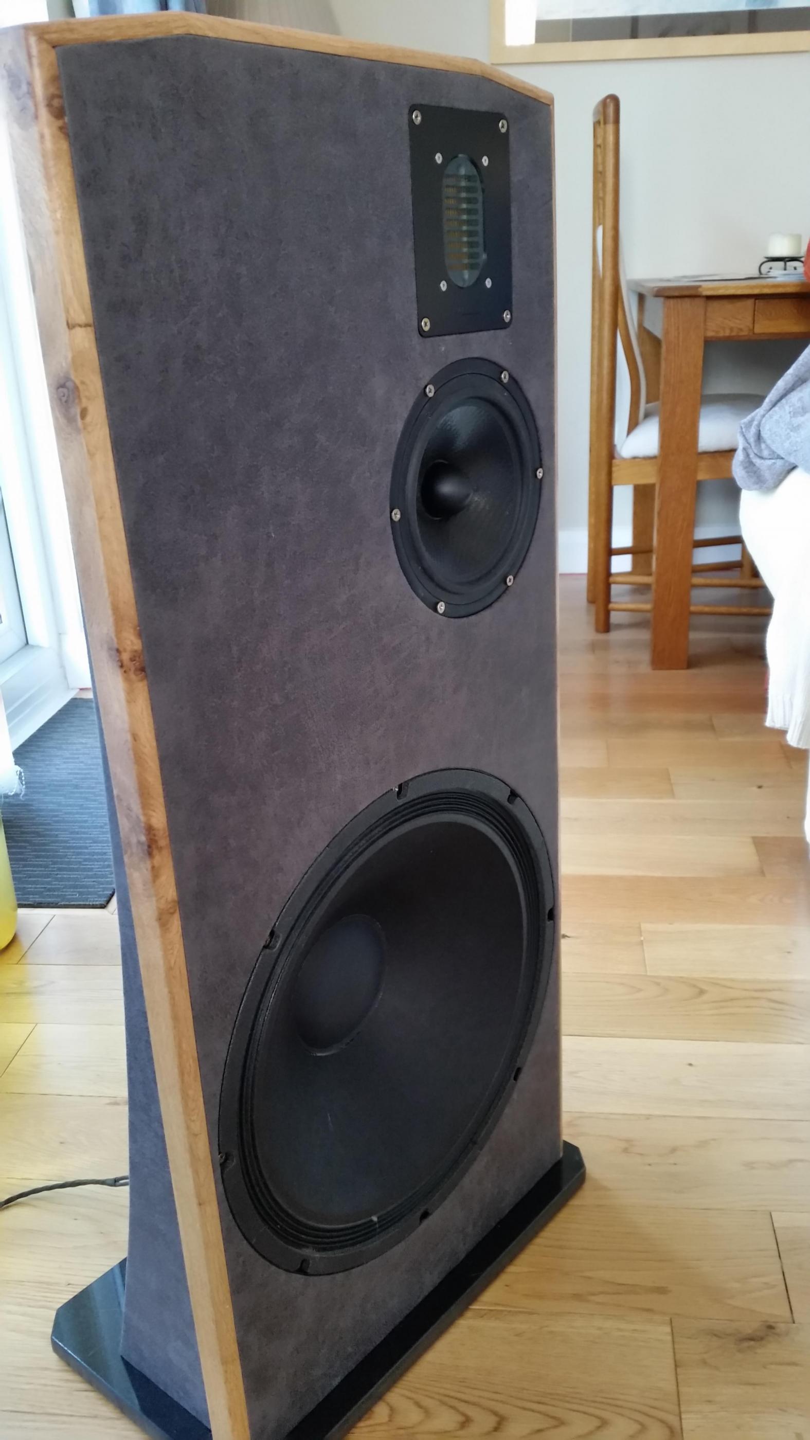

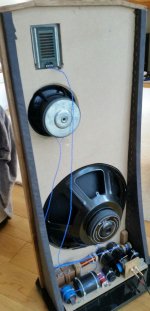

This is my first open baffle design, recently finished.

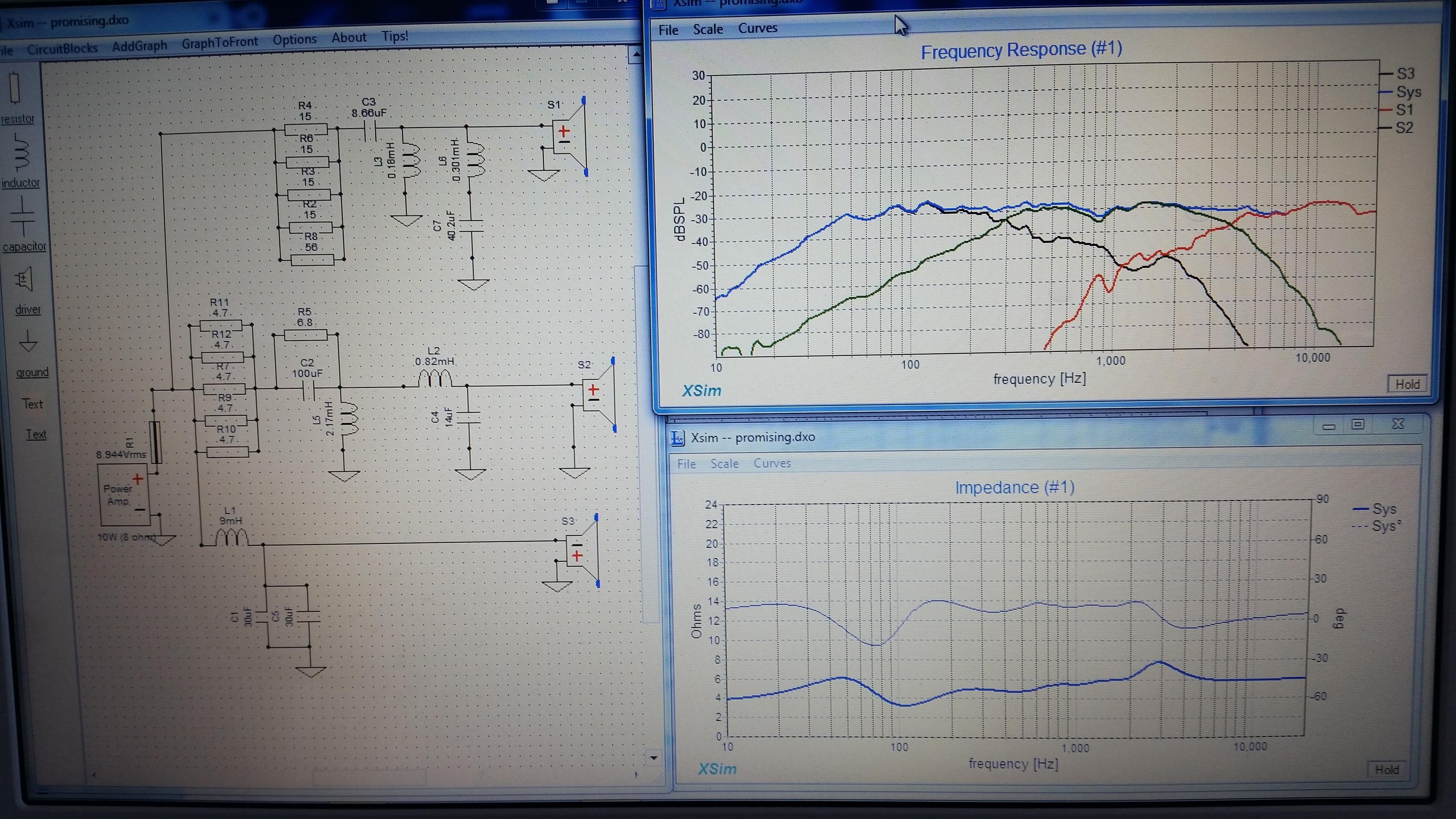

Drive units are Alpha15a, Seas U18 and Mundorf AMT. Measuring the responses on a prototype baffle was tricky and took a few attempts, likewise for the three way crossover design but the end result was worth it.
My own take on the subject of this thread is now...get rid of the box if you can. This has ended my search for a Quad ESL63 replacement.

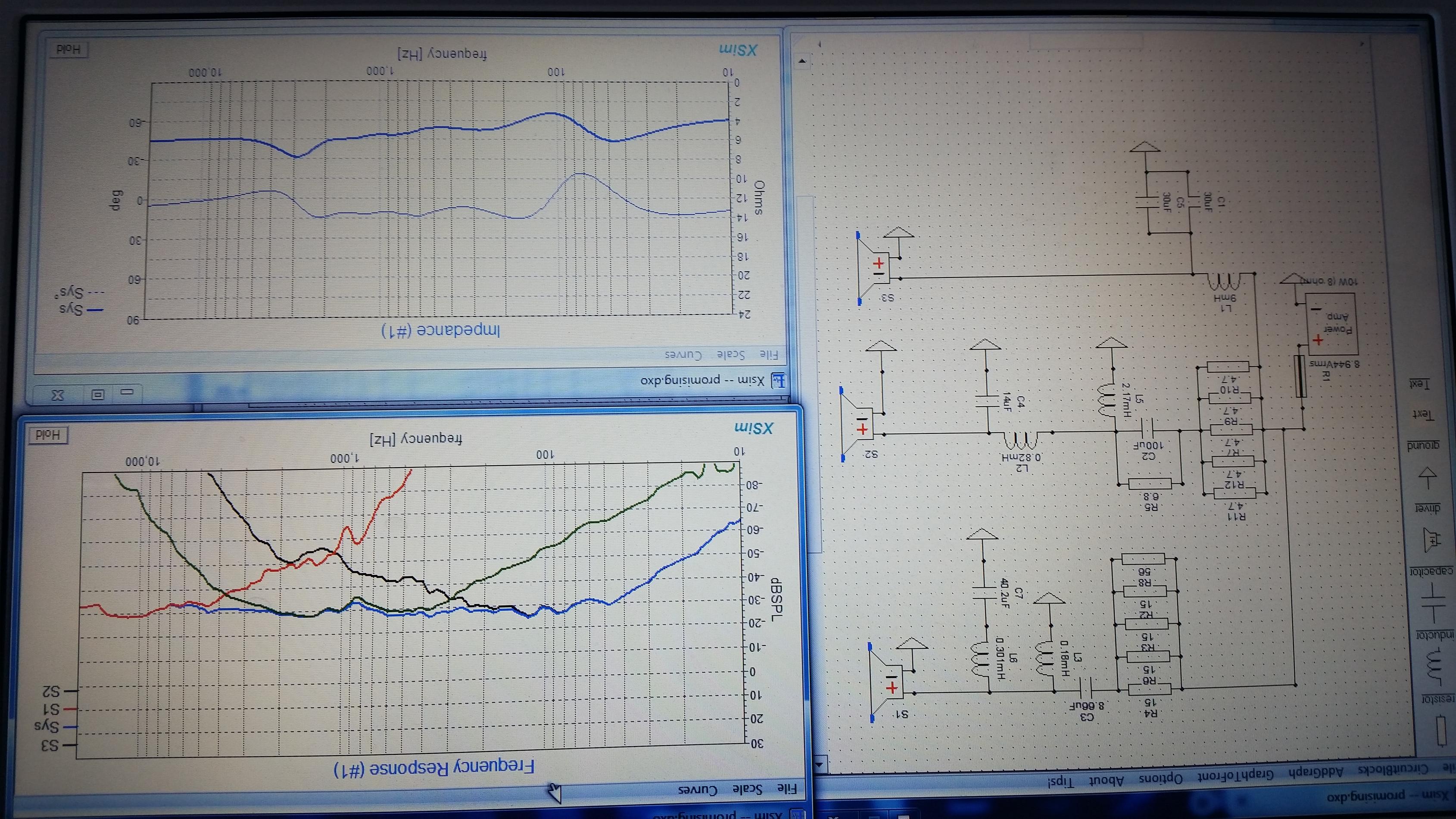

Thank-you for your additional pictures !
say, if I am to understand this *simulation* correctly, this is what the program predicts it will measure like?
If so, how about some actual acoustic measurements to see if theory meets reality ?
