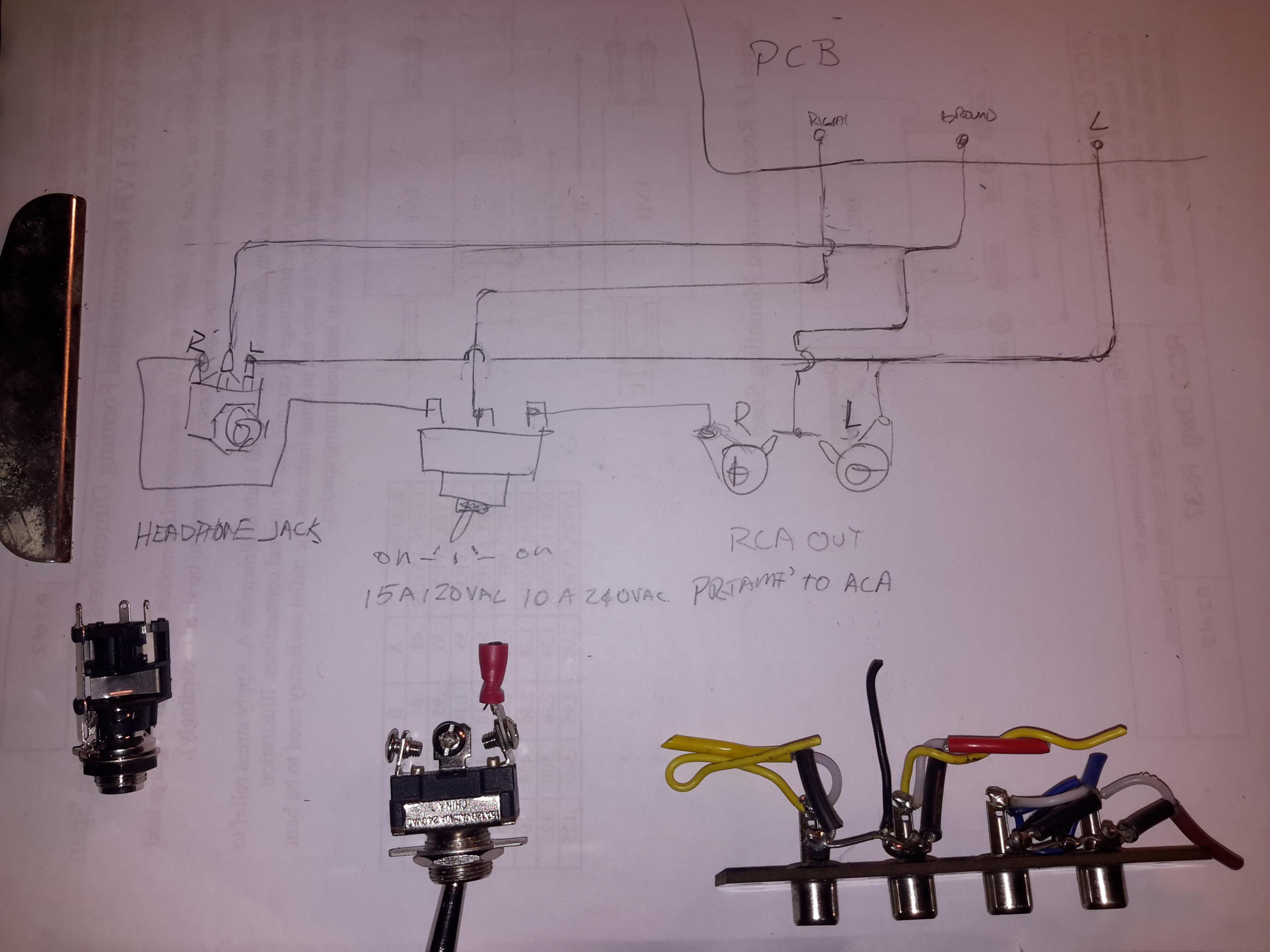

Am I thinking correctly with this setup? Will my diagram work? I want the 3prong 3way toggle to switch between headphone jack output and RCAs for use as preamplifier for ACA. Thanks for the help, I am learning a lot with this project.

You dont need a toggle switch. Just a switched headphone Jack. When you plug your headphones in the preamp output will be muted. Unplug the headphones and the preamp can be used. This is how I wired mine.
