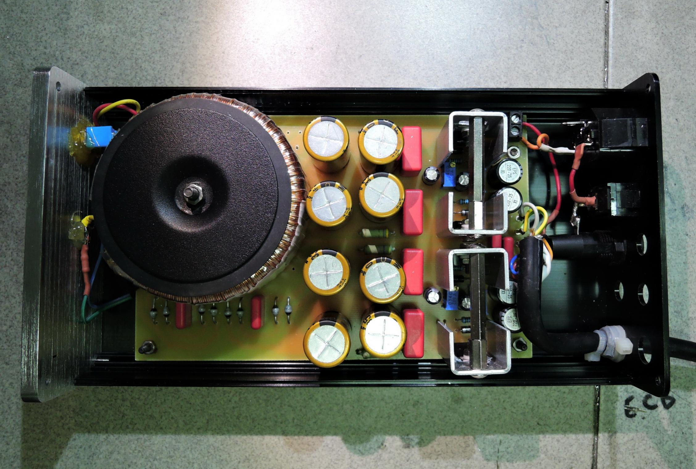

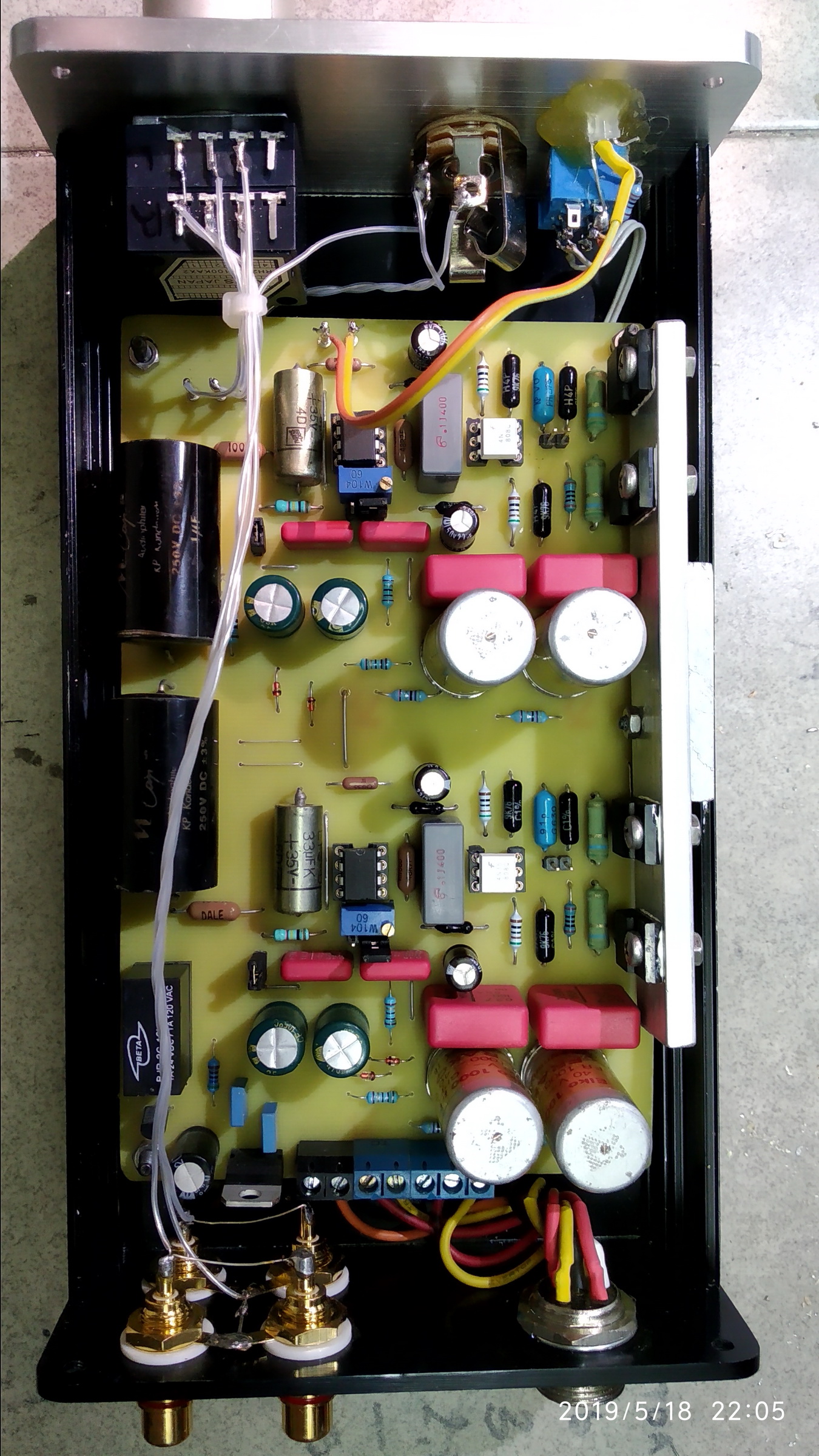

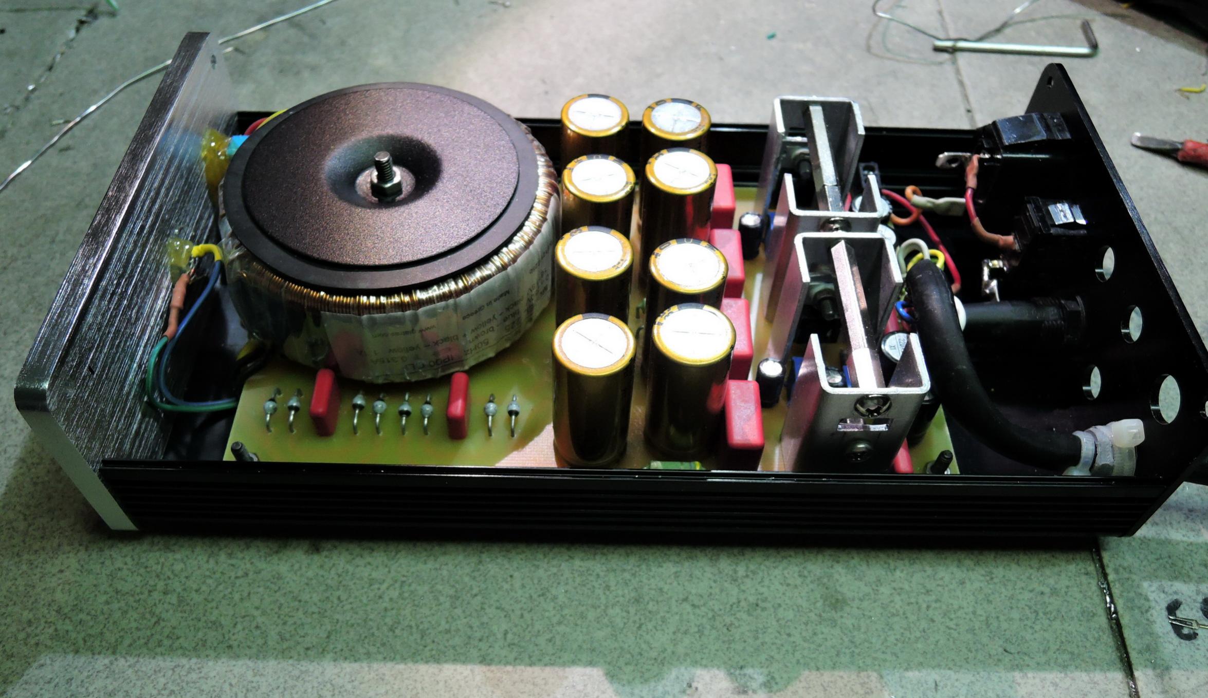

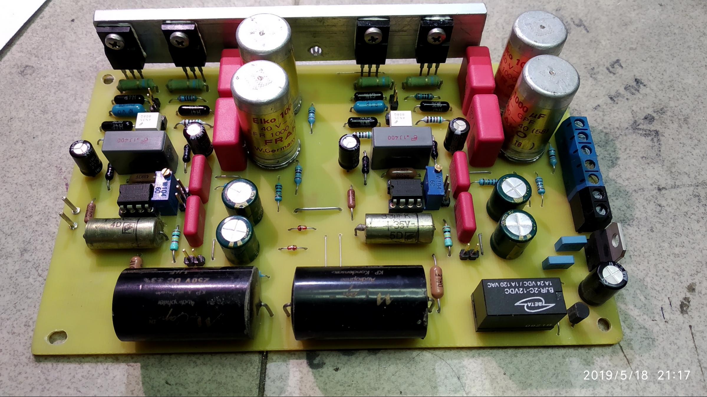

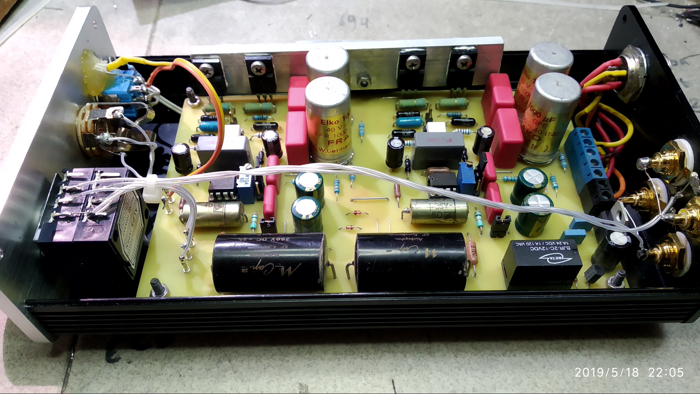

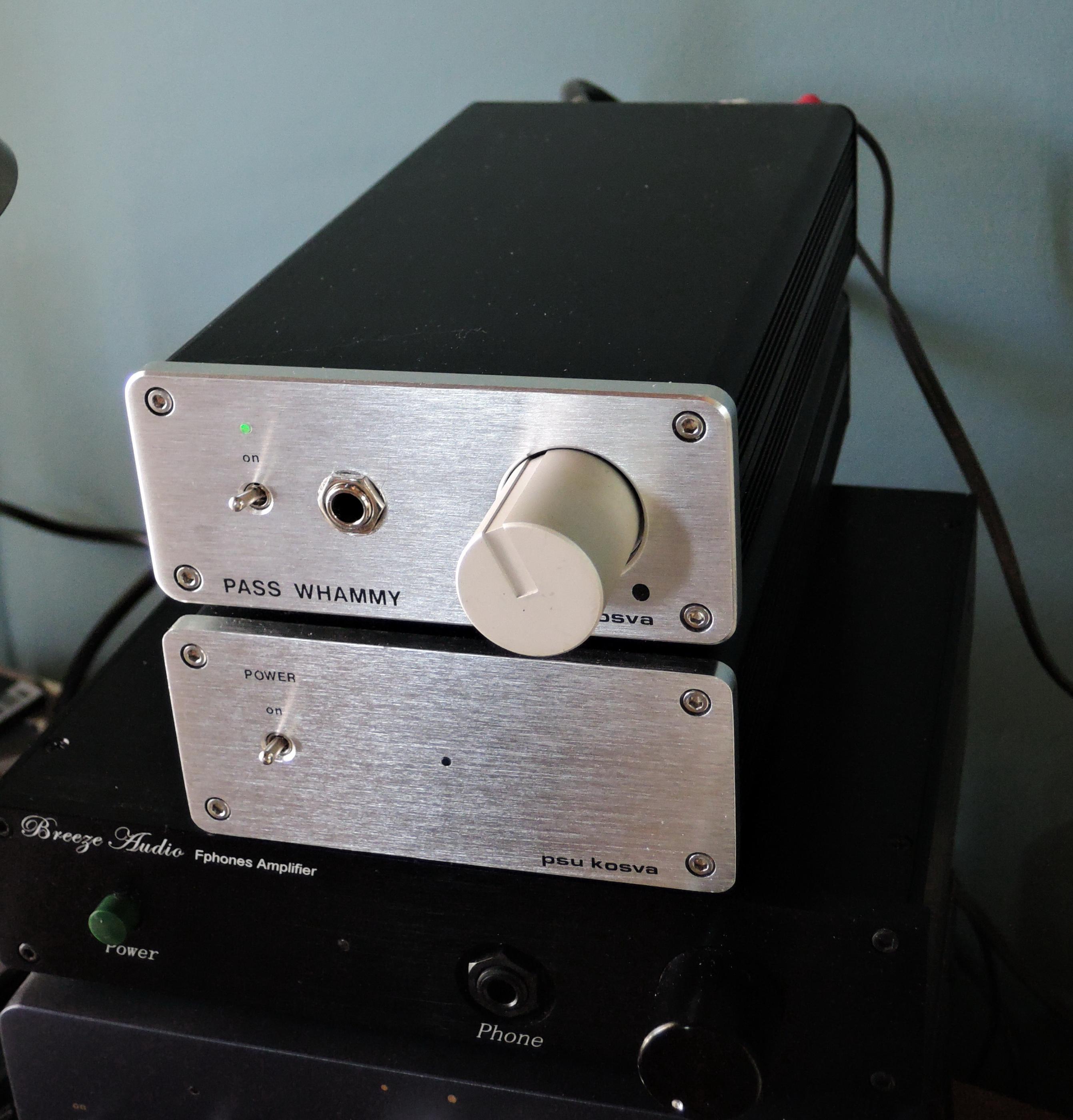

MY WHAMMY
Hi
This is my WHAMMY in a different PCB and two single OPAs with offset adjustment.
All the components are from my shelve, that's why the resistors and the capacitors are different brands.
The PSU is seperated from the main amplifier, in it's own enclosure. It is dual with LM317,337 and 50VA (2x18v) transformer.
The R16, 22, 29 and R32 are replaced with 5.6 Ohms so as the bias is about 0.11 A.
The quality (using my old SENNHEISER HD540 Reference gold) is great with detailed sound and great focus of the stage. From all the ICs I think that OP627 is the best sounding.
It is the quietest phone amplifier I 've ever heard.
So I'd like to thank Mr Wayne for sharing his design with us.
Kostas A. Vazakas
Aigio
Greece
