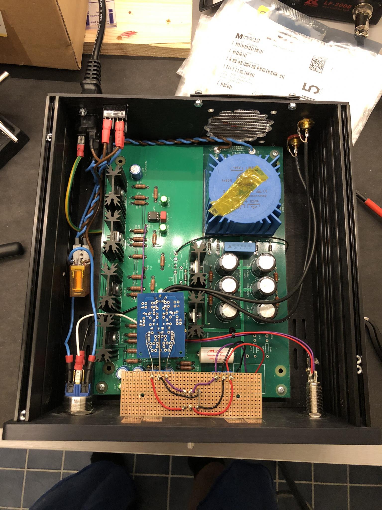

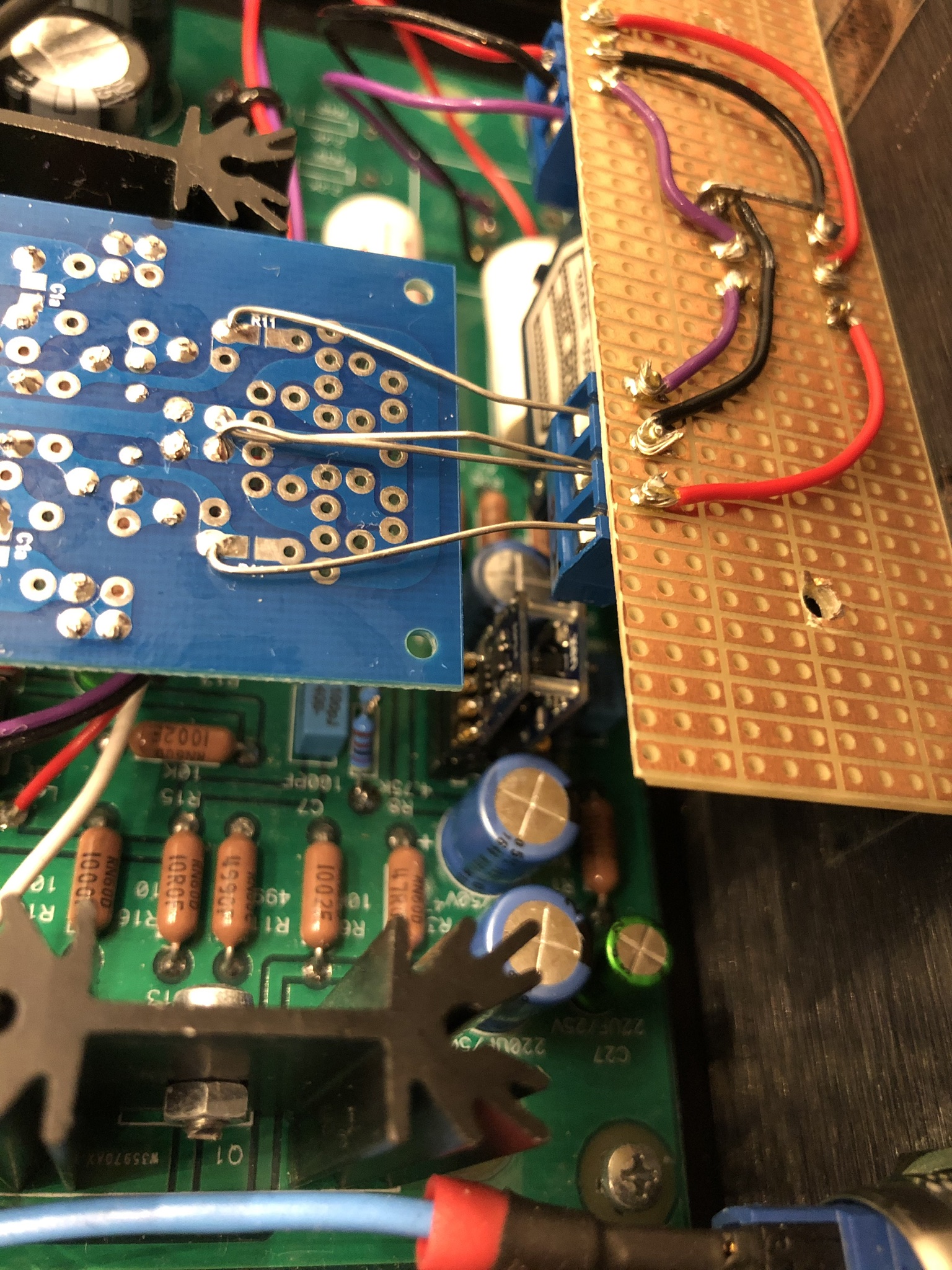

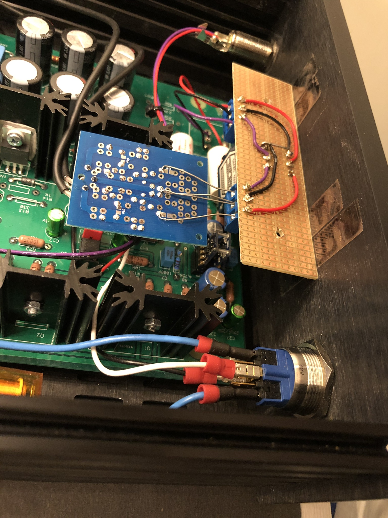

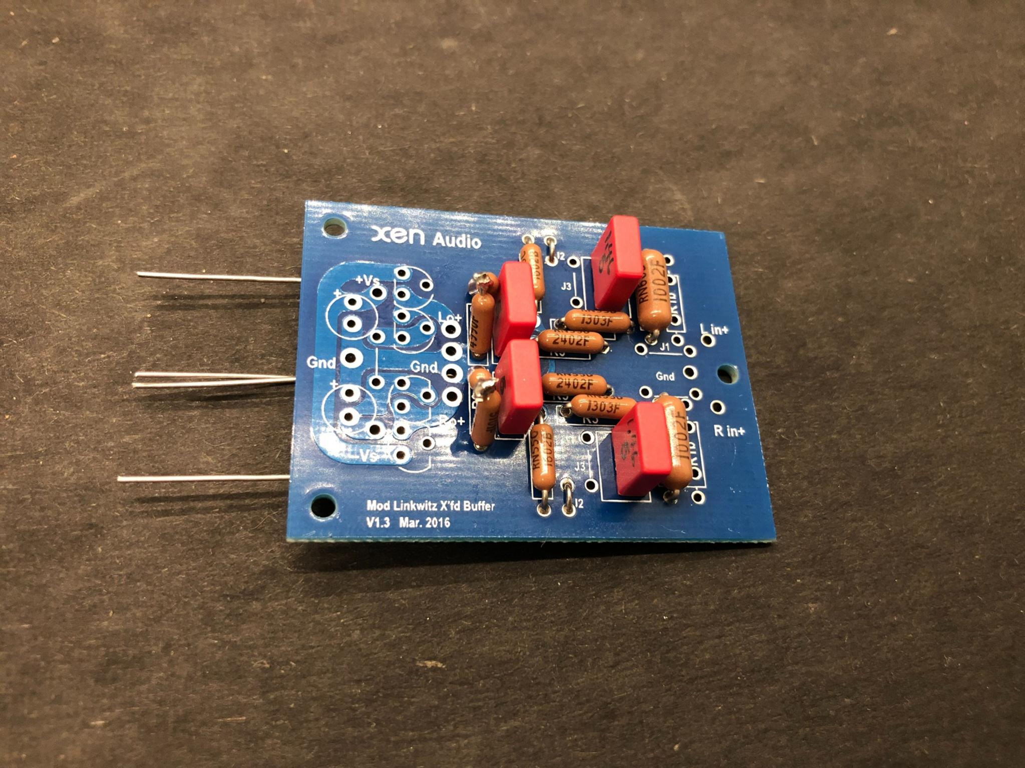

I had the pleasure to do some listening tests with Patrick’s discrete opamp design as a beta tester.
I used my Whammy build for the testing and tuned it a bit according to Patrick’s advices. The gain was set to 10x to compensate the Xen passive Xfeed and it’s attenuation. With the Xfeed installed gain is 3x. See the attached pics of Xfeed board (quick and dirty temporary installation) and discrete opamp in place.
The listening test was done between OPA2131, OPA627 and the Xen discrete. The source was RPi with Ian Canada’s ESS9038 dual DAC, FiFoPi, and opamp IV board, feeded with Ian’s battery board. You can check my DAC build here. Headphones were Audeze LCD-2f and music files ripped CDs in FLAC format played with Moode Audio player.
The discrete one was better with especially female vocals. Xen discrete opamp seemed to be also more fluent and easier to listen to. Then the OPA627 was a tiny bit better with male vocals, maybe due to the fact that it sounded a little warmer in mid region. As in comparison to OPA2132 I found no differences with bass depth/fastness or with high frequencies. Both the discrete and OPA627 were better than the OPA2132.
The differences were small and the back-to-back comparison is difficult since you obviously have to switch the systems off to change the opamp. But all in all, I can surely recommend the Xen discrete opamp with Whammy.

Glad you like it.
It is your turn to build your own. 😉
There are two more different topologies to come.
I shall open a new thread at the "Analogue Line Level" forum and publish circuit details later.
Patrick
Patrick
