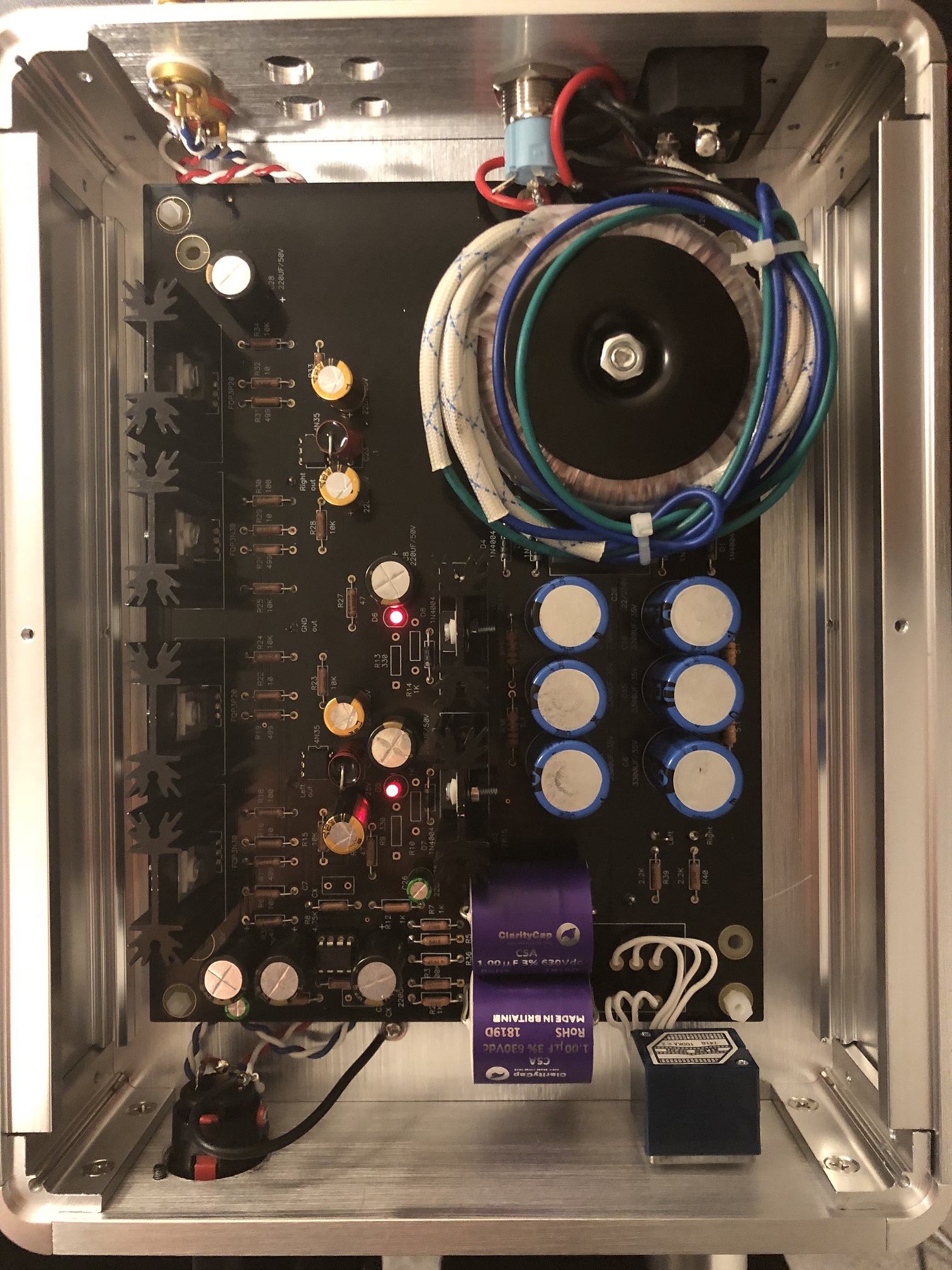

My first post at diyaudio. Thanks to Wayne for the design and to 6L6 for the detailed guide. I got the transformer from Antek and the enclosure from Aliexpress. I used the recommended parts except for C13, C23 (Audyn instead of WIMA), C12, C17, C22, C25 (Audio Note Kaisei instead of Nichicon MUSE bipolar), and C1, C5 (ClarityCap). The power filtering caps are also different but I don't think they will have as much influence on the sound. I found that replacing the WIMA significantly improves the sound. This is consistent with my past experience--most of the time WIMA film caps seem to introduce some hardness to the overall sound signature and make it less lively. The Audio Note caps are a little overkill but they also improve the sound by a large margin compared to the Nichicon bipolar caps, although these are polar. I have built another WHAMMY using Nichicon KZ caps for these positions, and found they also sound better than the bipolar ones. By building this I also learned that having large bias currents does not always lead to good sound. Initially I set R16, R22, R29, R32 to 5 Ohm, making the bias current 120 mA, but the sound was just terrible. I was very disappointed and accidentally tried switching them back to 10 Ohm (60 mA current). The difference was night and day--the sound is very warm and soothing, but with enough punch and speed. For the opamp, I tried a number of different ones and finally chose OP249 by Analog Devices. I found that it has a good balance between warmth and accuracy. BTW I have been using WHAMMY with Sennheiser HD650 and Massdrop HD58X. The WHAMMY easily outperforms all my other headphone amps.

I used Vishay MAL225050332E3 as shown in my picture.
