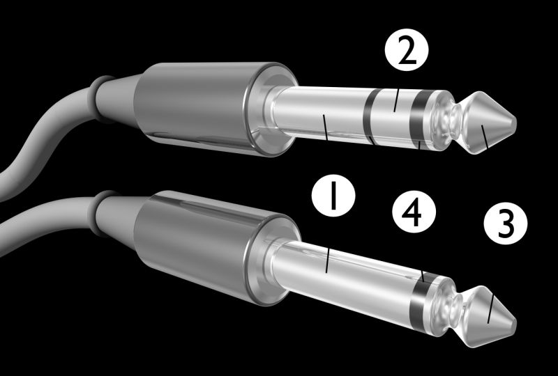

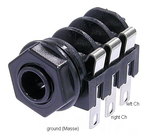

I have added a foto of the contacts at an 6,35mm jack / plug socket (stereo).
For the foto of the 6,35mm jack plug: 1 ground
2 right channel
3 left channel
I hope that helps you.
Greets Dirk
