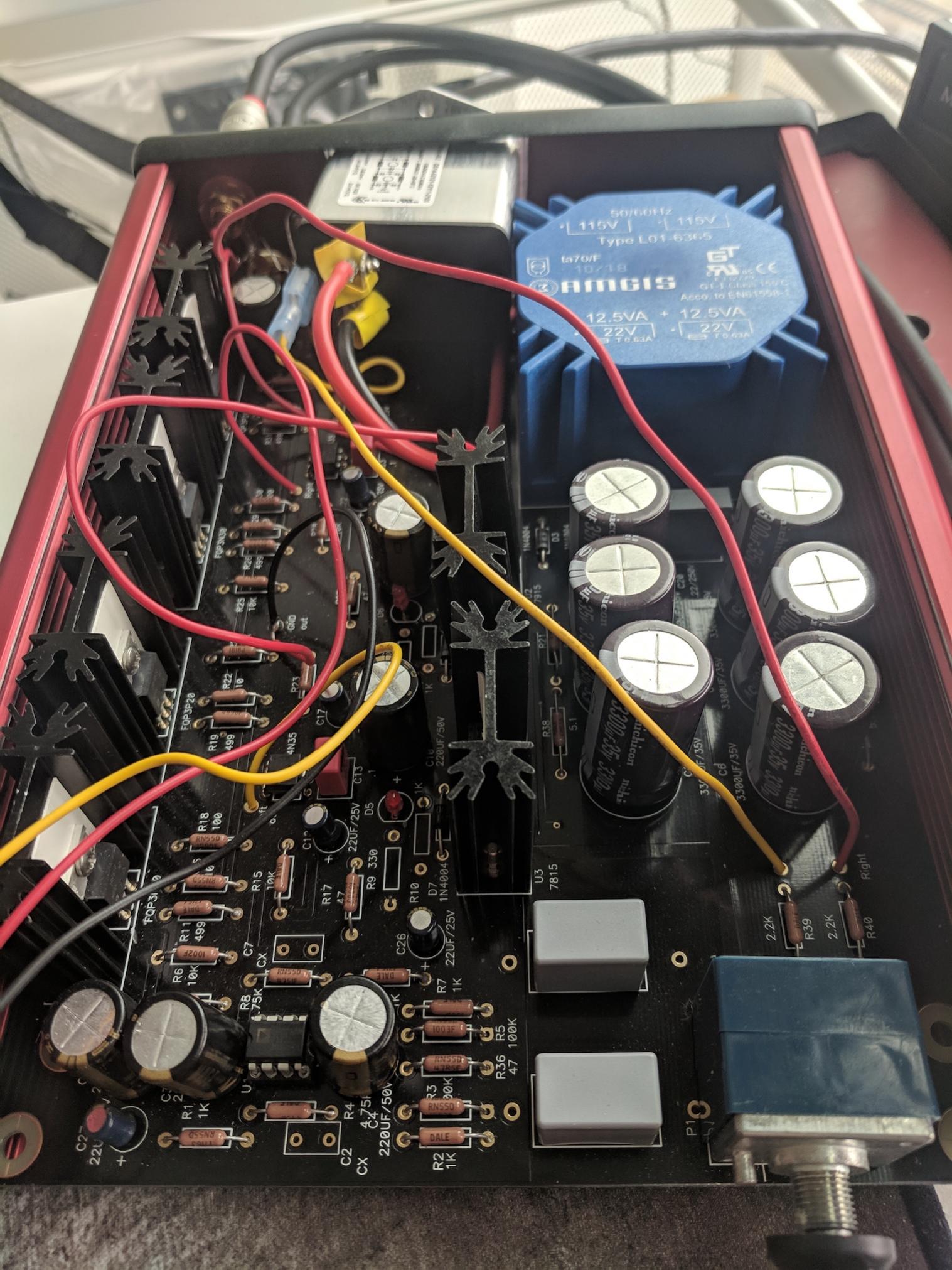

circuit is so simple that it must be either bad solder joint or wrong resistor value or bad resistor
of course , volume pot must be checked with ohmmeter too, and do your signal measurements with volume pot at max
edit: waidaminit .... you fixed it finally with LM 833 , or not?
Mark60615 - I agree with ZM and suspect you have a bad connection/solder joint somewhere.
I’d still like to see well-lit, in-focus photos and see if there’s anything amiss.

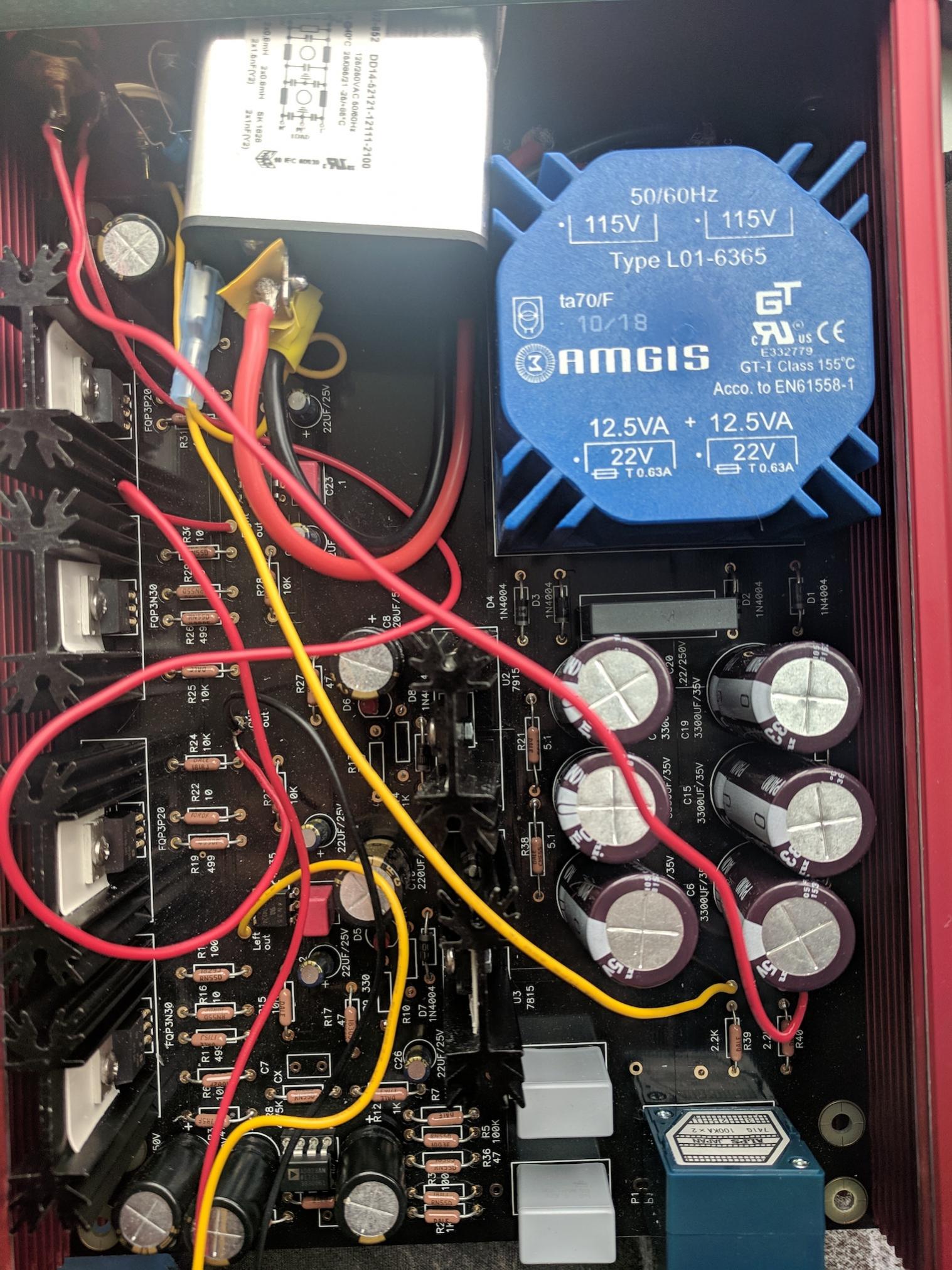

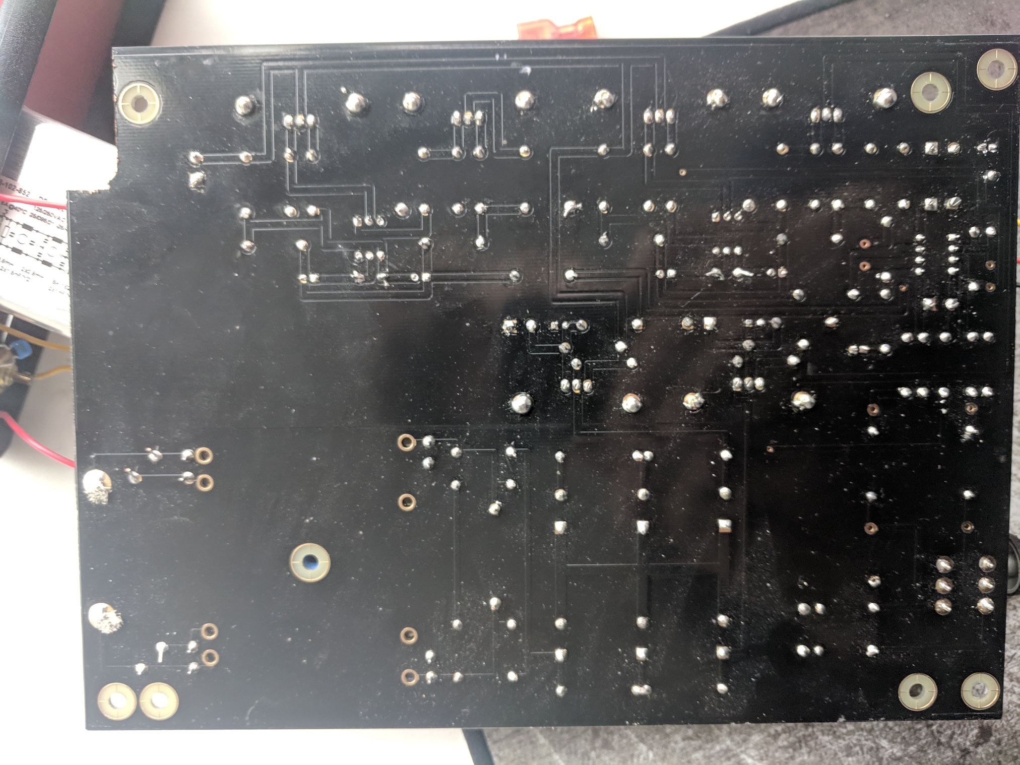

Attached are a few pictures of the build. Summarizing a few of my previous posts, this build is a little weird because I had hard time with the chassis. I used a hacksaw to cut out a corner of the board to get everything to fit. After that I was getting a loud ground hum, so I connected the RCA ground directly to the output ground. That fixed the hum, but I'm not sure why.

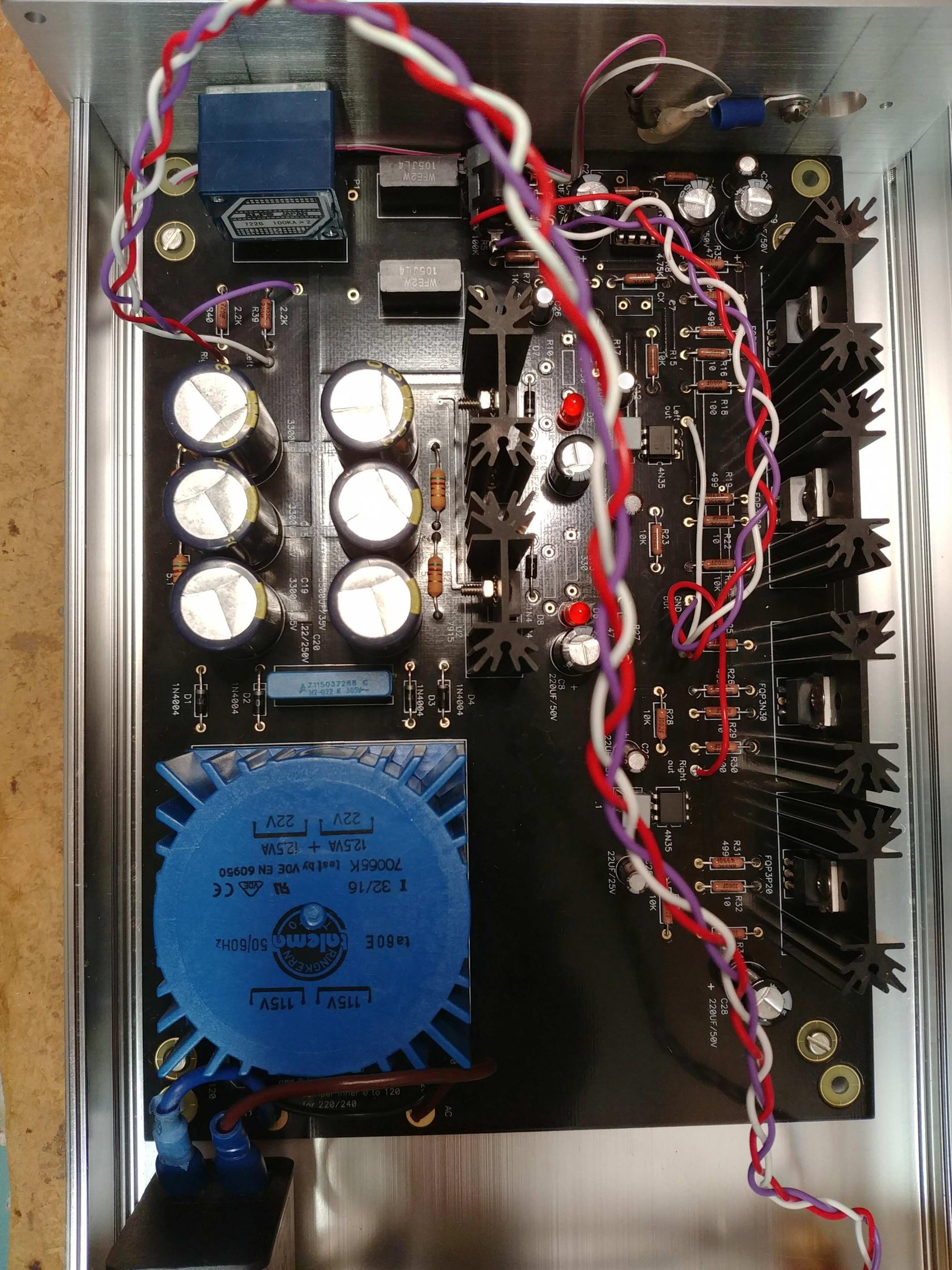

I bought this kit with the parts included. I had no issues and it played on the first attempt. however, using Sennheiser Momentum 2, I felt my LG G6 with the quad DAC sounds better connected directly to the headphones than via the amp.
I have two issues, and I would appreciate any advice.

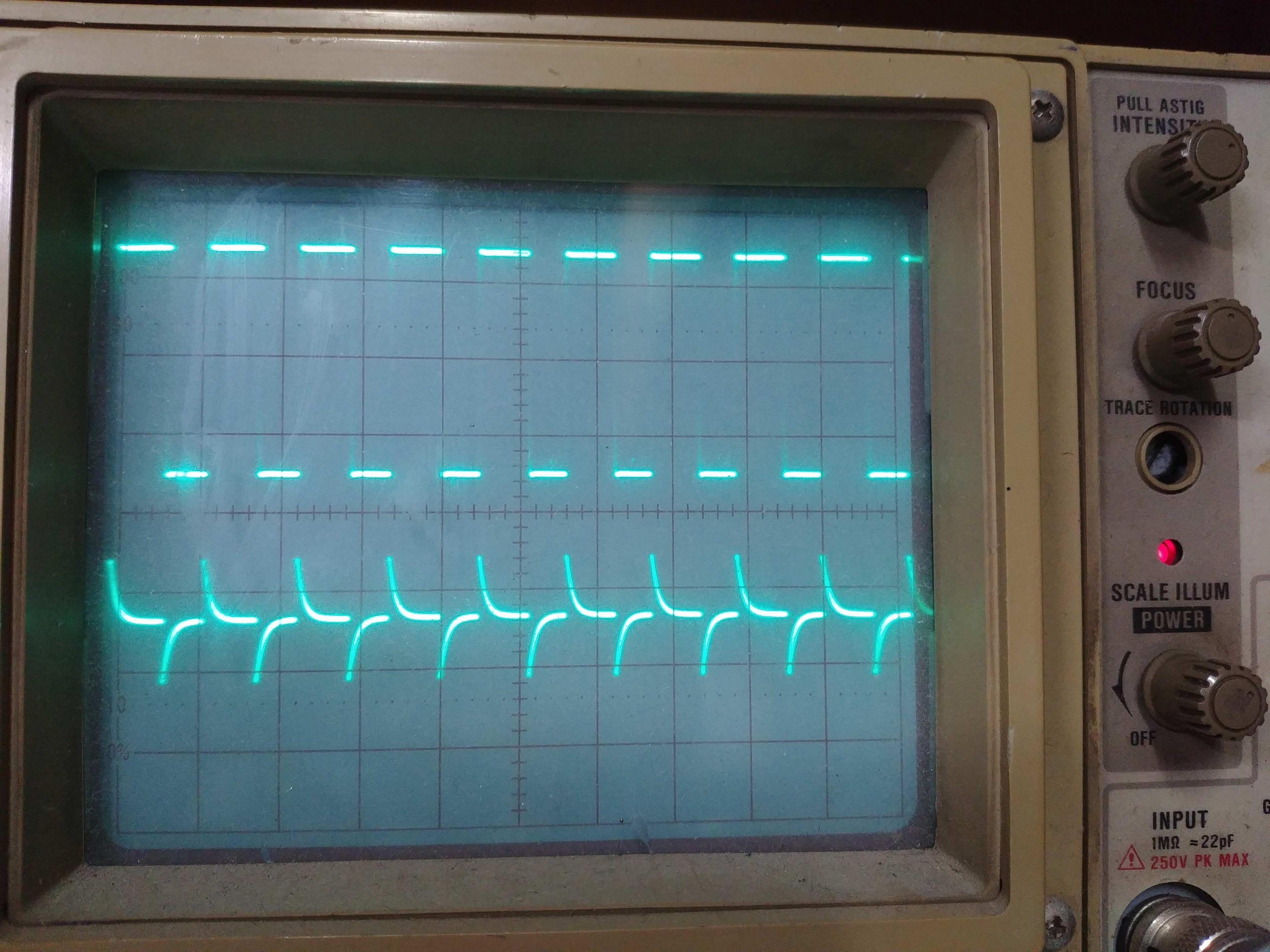

  1. looking at the scope, entering 8.3KHz square wave, there is a strange rising edge. it worsen as the volume is turned down
  2. there is a HUGE amount of crosstalk between channels
please take a look at the attached images. on the scope image, the higher trace is the output. it becomes more similar to the input if I rotate the potentiometer towards lower resistance.

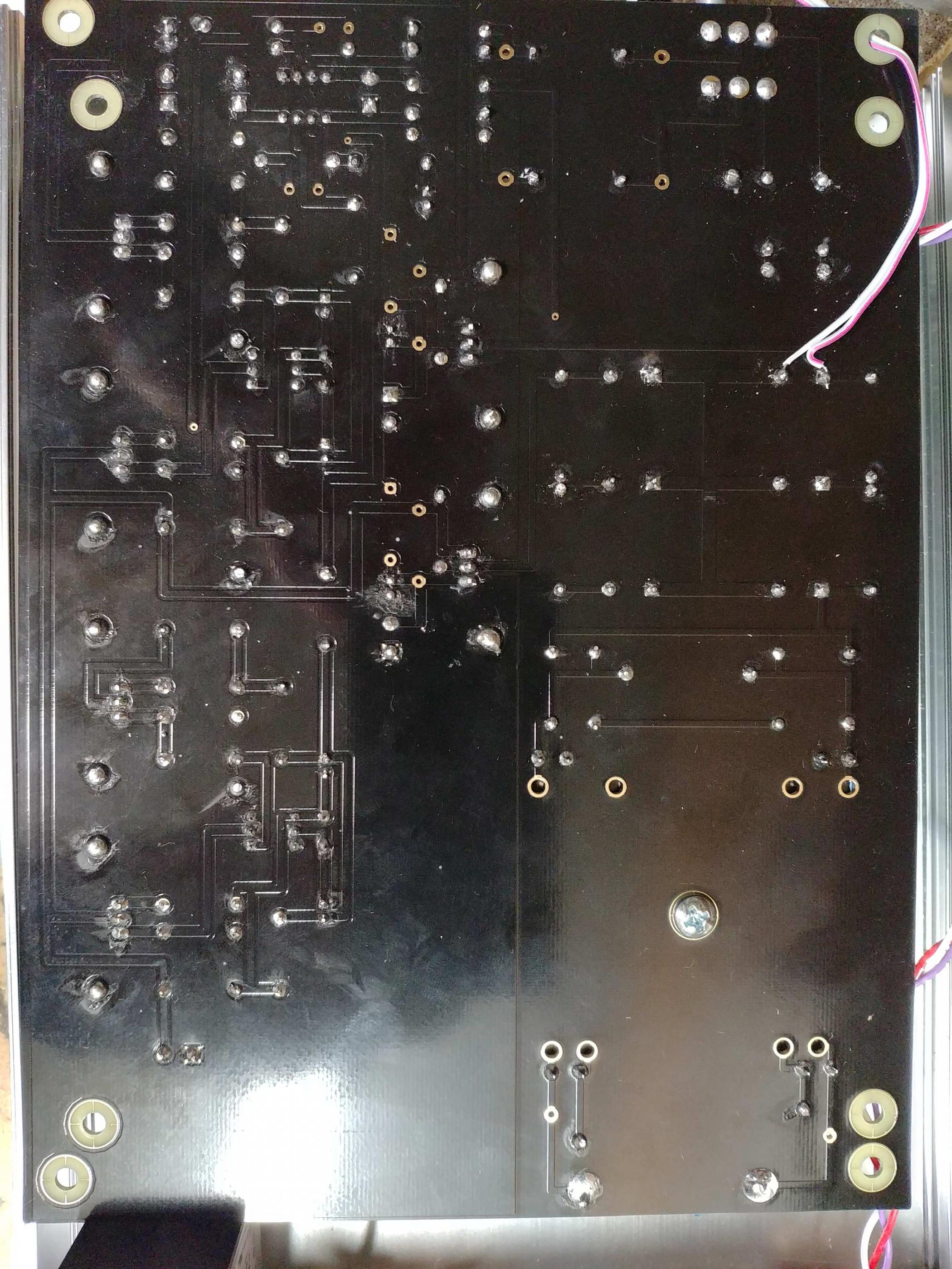

mark60615 as bk856er mentions take a look at R5 and R3 and also on one of the regulators and a bunch of other holes where there looks to be with no solder coming through from the underside.
Reflowing your joints with a hotter iron setting and wider tip is going to help get those nice little fillets will give a better connection

here is the back side of the board. I don't see something there that suggests crosstalk, so I'll have to work my way slowly from input to output.
I'll also try the out-in drill of the opamp, though I don't see something wrong there at the moment.
any other ideas are more than welcomed,
Shmulik

It looks to me like your wires are twisted or braided together and this will give cross talk.
crosstalk
I completely removed the wire from one input connector to the board, and kept the generator connected to the other RCA input connector.
I attached one probe to the live input connector, and the other one to the input resistor of the disconnected channel.
you can see both channels on the scope's screen. the input is ~1.5Vpp, ~8.3KHz. the induced signal is ~30mV peak to peak.
if I connect the wire I removed from one channel to the probe, and just lay it along the still-connected wire, with the square wave on, I see the signal induces to the free wire like to an antenna. I guess something like that happens in parallel traces. I also had to lift the potentiometer by ~1cm, so some parallel wires there also.
besides avoiding parallel input wires, I don't have a good idea how to deal with this.
