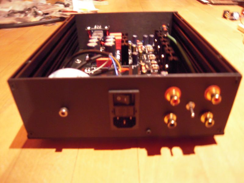

answer to MASHMAN
Hello Tom,
you can add an switch and the RCA / chinch-outputs for an amp pretty
easily. Output + (left and right) from Whammy - PCB to switch / from the switch to headphone output or to the RCA output. So you need a 2-pole-selectorswitch. You also could run the headphone-output and the RCAs parallel.

Hello Tom,
Was discussed in this Whammy-thread. Have to check which post#.
Greets
Dirk
Check Photos in post #877 for connecting RCA / headphonejack in parallel

Could you not use a pair of rca outs with a sorting TRS jack (I think that's the right terminology) which disconnects the rca output when phones are plugged in?
Yes. Place resistors of 27-50ohm (whatever you have in your box) in series with those RCA's output.

Also, there doesn't seem to be a bypass for an amp here. this seems like an oversight. is there a reason for this or is there a simple way to add one. I think it would be a bit annoying having to fiddle with cables every time i switch between headphones and loudspeakers.
Absolutely an oversight, and will be remedied with the chassis kit when that becomes available. A switching jack can be used and an output set or RCAs installed on the panel. Place some resistance in series with the outputs, 27-50 ohm or so. A "build-out" resistor.

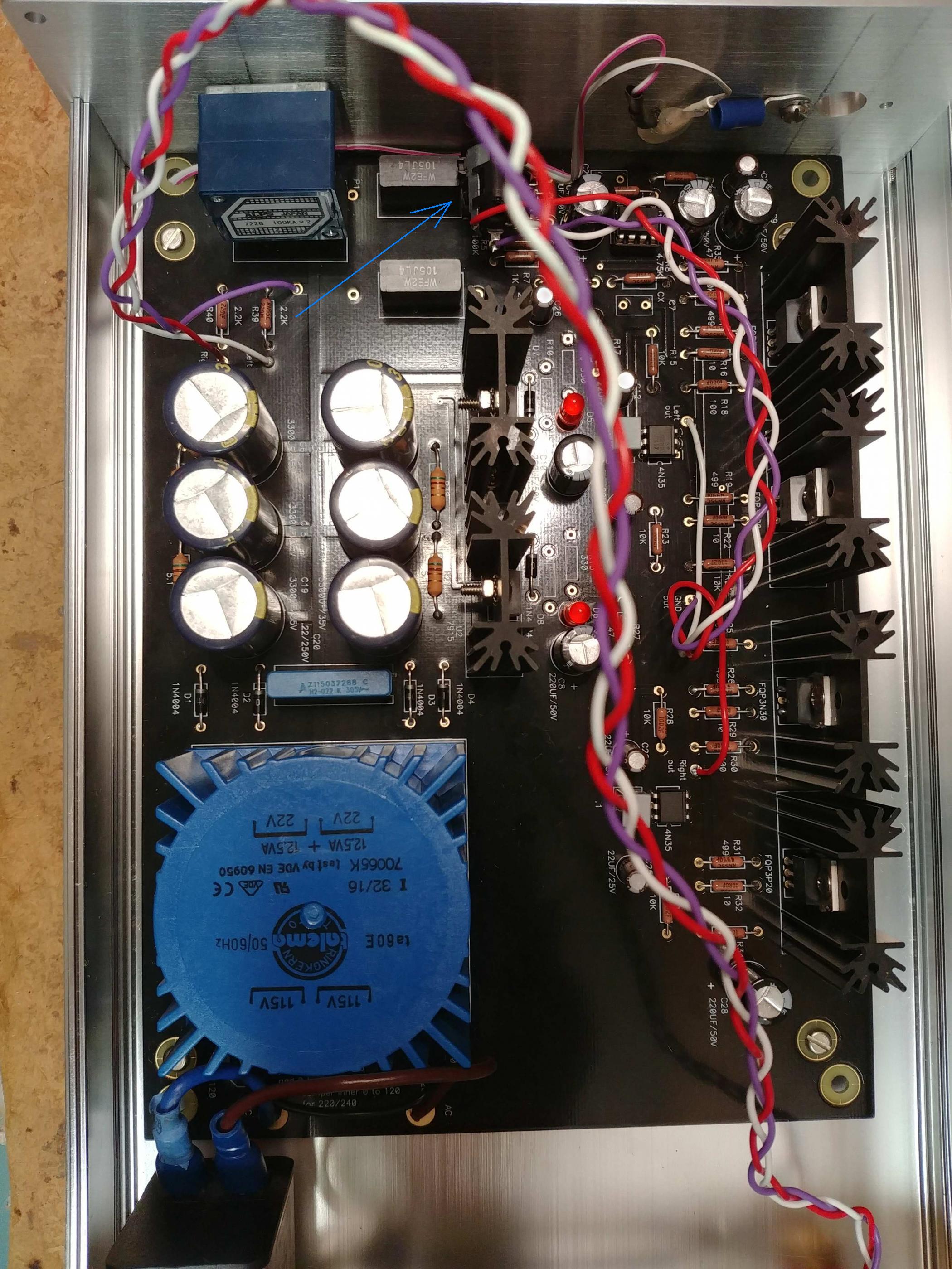

Finally finished my build after weeks.
But I have no audio coming from the left channel.
What are some things to check for? I have tried swapping up the op amp from a AD8397 to a OPA1612.
With the OPA1612, there is no right channel audio, and the left channel seems to give an output but still pretty quiet.

You will get crosstalk when the input wires of both channels a braided together.
I replaced the braided input wiring with a shielded wire, separate for each channel. each shield is attached to (the common) ground on the RCA side and at the attachment to the board.
before using this wire, I tested it for leakage. I connected one end to the signal generator (square wave, ~8.3KHz, ~1.5Vpp), shorting the other end with a 100kohm resistor. like I did with the unshieled wire supplied with the kit, I wrapped around the shielded one another, bare wire and connected to the other scope channel. unlike the kit wire, this one leaked no signal to the wrapped wire.
this also reduced the crosstalk between one input to the other from 30mv pp to about 10.
I still see imperfect leading edge on the output for the above input square wave.
any further ideas are more than welcomed,

Does this mean it plays fine with the AD8397?
