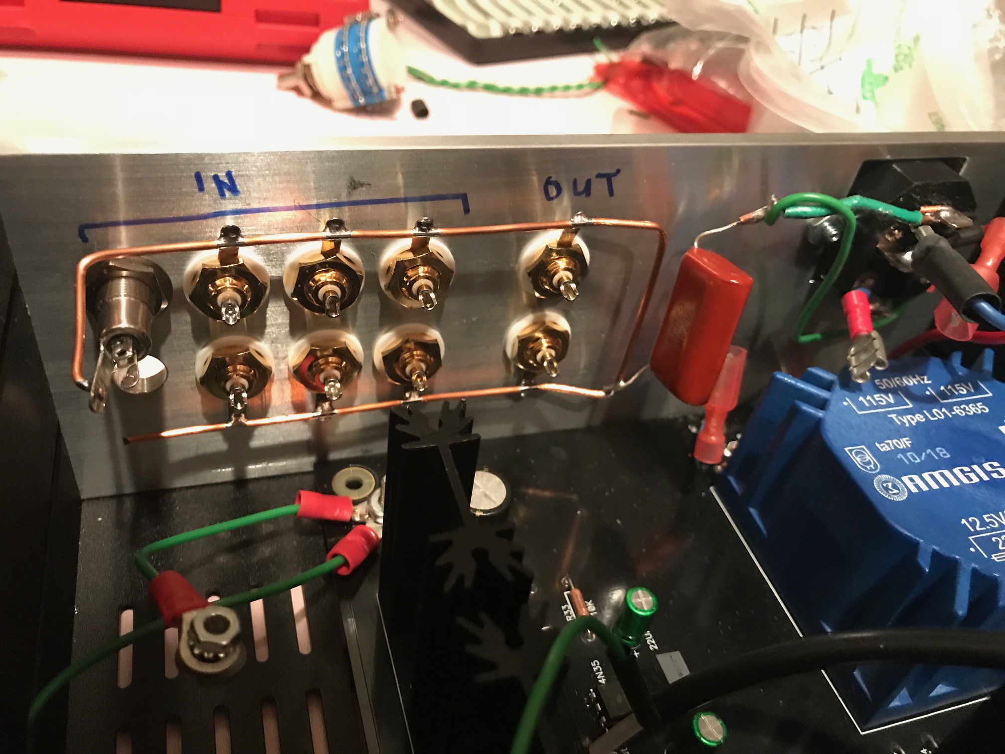

I've had to redo a number of things but am getting pretty close to finishing my WHAMMY preamp. Before I go further, I thought I might avoid some more desoldering by asking for some advice.
I have connected both my input and output RCA grounds to the same buss bar that includes the orange capacitor. Is this ok, or am I creating a problem by doing so. I think the attached picture shows pretty clearly what, Ive done.

I thought of that myself, and took another route: I made sure that only the input audio ground is connected to the earth ground through to the CAP. The outputs use the audio ground from the PCB and are isolated from the chassis.
What strikes me as odd is that you have not connected the chassis to the AC earth, but directly the earth ground through the cap to the audio ground.
Therefore, you don't have a grounded chassis. I would not like to have that in my setup. As per the guide, i would try to connect that third leg to the chassis, and the audio ground through the cap to it.
Also, what is the leftmost input connector? It appears that its ground is directly coupled to the chassis, and that would 'bypass' the cap for all audio ground once you get that third leg connected to the chassis.
That is what I can pick up from my very limited knowledge. I may be completely mistaken, so take my observations with a grain of salt!

Thanks for helping out. You can't see in the photo, but the chassis is also grounded to AC earth. There's a lead from earth side of the capacitor to one of the bolts holding the AC terminal to the back plate. All the chassis plates will be connected to ground by leads going to the bolts that hold the pcb to the bottom plate. A star ground I guess. The bottom plate will be tied to the back plate so that it is connected to AC ground.
Is there a reason to ground the output to the Audio ground? Is it because the input ground signal causes noise in the output, when connected to the same ground? I dont think I fully understand the difference between the audio ground and the AC ground. Isn't everything eventually going to the AC ground?
I can easily modify what I've done to tie the output ground to the audio ground, just curious about the reasoning, I need to understand grounding better. I've found it a bigger challenge than building the PCB.

Rafa, the jack to the far left is an 1/8 inch auxilliary jack, I can see now that the phone jack shell ground also grounds to chassis, so will create a ground loop. I'm going to replace with RCA jacks and use an adapter cord for iphone and ipod input.

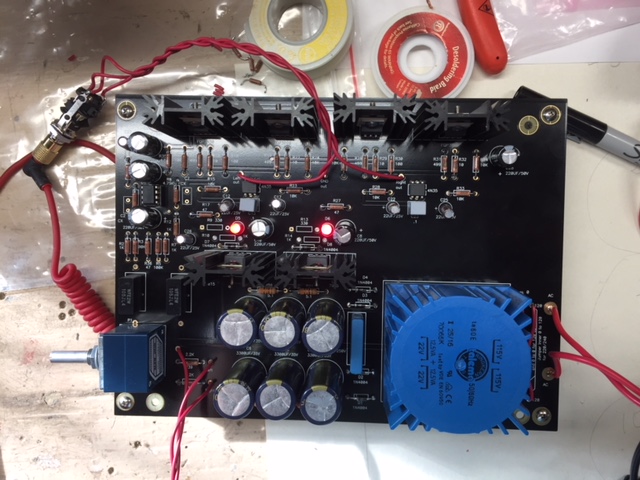

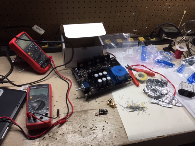

Hey, All. I just put this thing together based on the parts kit I got a few weeks ago. I got the email to comment about the kit, but hadn't put it together yet, so I thought I'd show up here now and log my feedback...
It was an afternoon and a morning to assemble it. I didn't have any issues, everything worked out first time. 14 ma DC on each channel. The voltage regs heat up to ~125 F pretty quick, the other power devices are cooler 90 to 95 F. Sound is quite nice, I don't have much listening on it yet having just sound through it an hour or two ago. I get a bit of buzz when I touch the volume shaft.
When I got the kit, the leads on my power transformer were a bit bent up. It would be nice if that shipped with a bit of protection there.
Looking through the instructions, the LED voltage reference setup (which I executed) is mentioned on the schematic (@ beginning of thread and included in the kit) as omitting R9 and R13. R10 and R14 also appear to be omitted.
C20 - the actual device that shipped to me was a blue rectangle. It didn't seem to give any hint as to what kind of device it was or what value it had. Eventually I figured out it was the only thing that had lead spacing to fit in the C20 spot, but I stared at the thing for a while, wondering what it was.

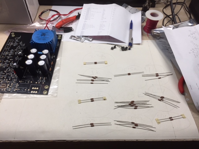

Thanks to DIYAudio for putting the kit together! I bought the circuit board earlier, but wasn't looking forward to sorting out the BOM to actually assemble. This was quite convenient.
Next is get a case, and consider if I want to try and get a stepped attenuator.
