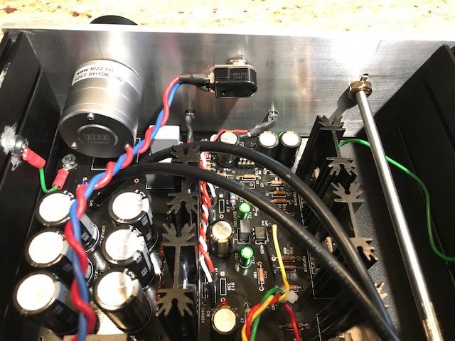

Now I'm trying to diagnose the hum. It's still there after putting everything in the chassis, and I noticed that I'm getting only music in the right ear and only the hum in the left. The hum is completely gone when the volume knob is at zero, and it gets very loud as I turn up the volume.

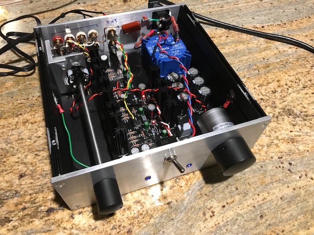

Completed-but noisy
After many hours working out the hookup wiring and layout, I'm almost finished with my pre-amp build. I've found that preamps require a lot more knowledge of grounding and are very susceptible to picking up stray noise. I could use assistance in sorting out my noise issues as I'm new to this, and have a lot to learn.
The board is a standard build with one of the recommended op-amps, I don't remember which one offhand. It powers up fine and produces good gain in both channels. But, I am getting pretty strong 30hz hum (measured with my phone's strobe tuner app) in the input channels that have any source connected to them, whether sending a signal or not. For instance an RCA adapter and aux cord produce little or no 30hz noise, however when the phone is connected the 30 hz starts. When the phones is unpluged the AC hum disappears or diminishes greatly after a second or two delay. As well, I get radio noise from input channels that are connected to something, the radio noise ramps up sharply in the last few steps from wide open on the volume control.
I am guessing I have not properly handled grounding or have left too much untwisted wiring at the input selector switch. It is quite difficult to solder all the connections and leave only a little bit of wiring left untwisted, what you see in the photo is about the best I could do, with the 18ga stranded wire I used for hooking these up. I suspect a lighter gauge might be easier but I'd be surprised if it the difference would be significant. Channels with nothing connected are silent, there can be some bleed of radio noise from an adjacent connected channel (crosstalk?).
That there is no noise from the fifth position of the selector switch which is not utilized at all leads me to believe the problem lies upstream of the selector switch.

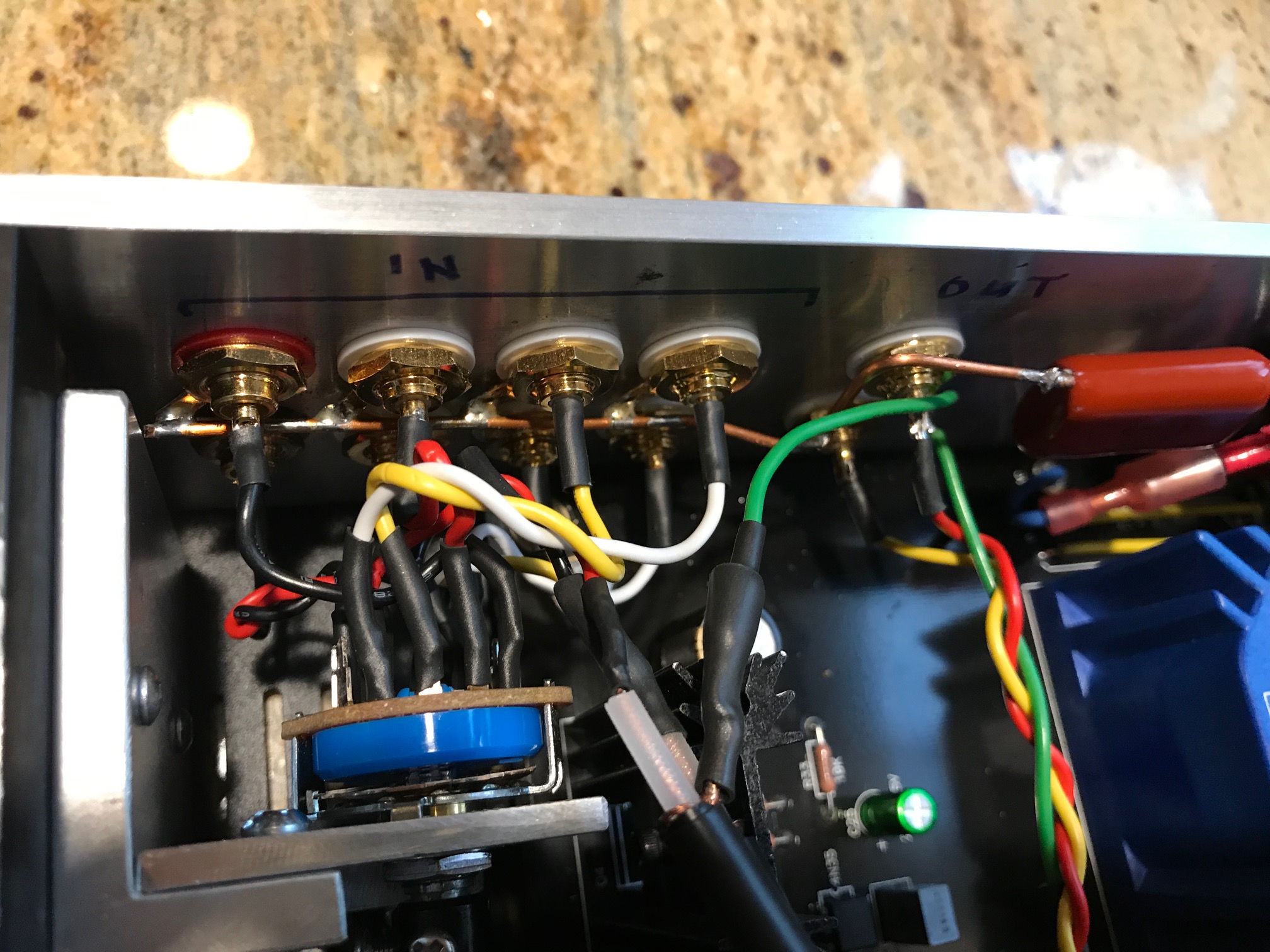

The grounding is handled as follows:
-Input grounds are tied to the safety ground via a .47uF capacitor.
-Chassis is grounded to the safety ground via a lead from the AC input terminal screw to the AC input ground terminal. The sides of the chassis are tied together either by sanding the anodizing (or paint) and using a star washer to connect the panels, or by tying together with wiring.
-Output terminals are grounded with a common wire to audio ground on the board.
-Input cable sheilding is tied to the audio ground. (Should that go instead to the safety ground or to the input jack ground upstream from the capacitor?)
The only nonstandard part of the board is adding blue LED power indicators on the front panel from R10 and R14.
Finally on a positive note, aside from the noise issues, the preamp sounds good and has slighty better highs and a slightly better defined soundstage, than the Carver CT-7 that I have been using. This is going to a Nirvana Electronics Works A-20 amp driving Shahinian Obelisk speakers. I would recommend a pre-amp project to any newbie as it forces much more careful consideration of layout, wiring and grounding issues. I've found these to be much more challenging than stuffing a through hole circuit board, or following an example that someone has already worked out layout and wiring.

As I'm working to troubleshoot the noise in the left channel, I've discovered two more things:
1. The noise is mostly high frequency, with peaks at around 2khz and 12khz, and a dip at around 6khz.
2. The noise doesn't change when I unplug the cable that was plugged into the left RCA input.
You're so far off stock at this point that you need to be sure wat you think works actually works...
First, disconnect all the input/output wiring from the Whammy and use one set of inputs directly to the PCB's input, and wire the headphone jack, and make sure the Whammy first and foremost works as designed.
With that verified we can continue forward, without knowing that it's all just shoveling sand into the tide. 🙂 We'll get it figured out. 😀

It is not quite clear from this what exactly is your audio ground. I guess maybe the input ground, which is lifted from chassis/safety ground via the .47uF cap?
If so, then it is incorrect to connect the input shielding to that. It should be connected directly to chassis/safety ground. However, this would also depend on how the source component is wired to prevent a ground loop through the cable shielding.
I’ll try 6L6’s suggestion to use one input to check the function of the PCB . First I’ll relocate the input shield to the safety ground to see what effect that has. That will be really easy, and I would like to try one change at a time. To answer Henryve, the audio ground is the output ground pad on the PCB, the GND halfway between left out and right out.
Then again, scrap what I said about shield. I was thinking of XLR connections. My mind not yet in gear for new year.
