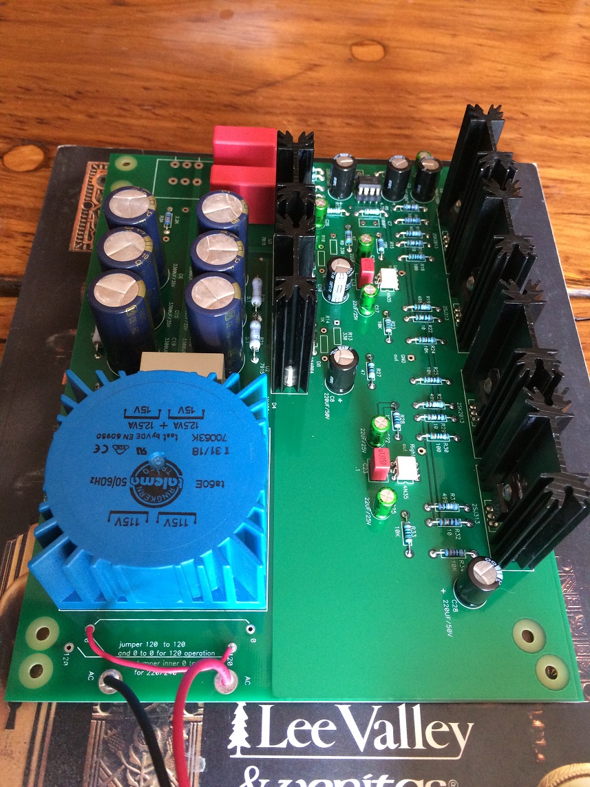

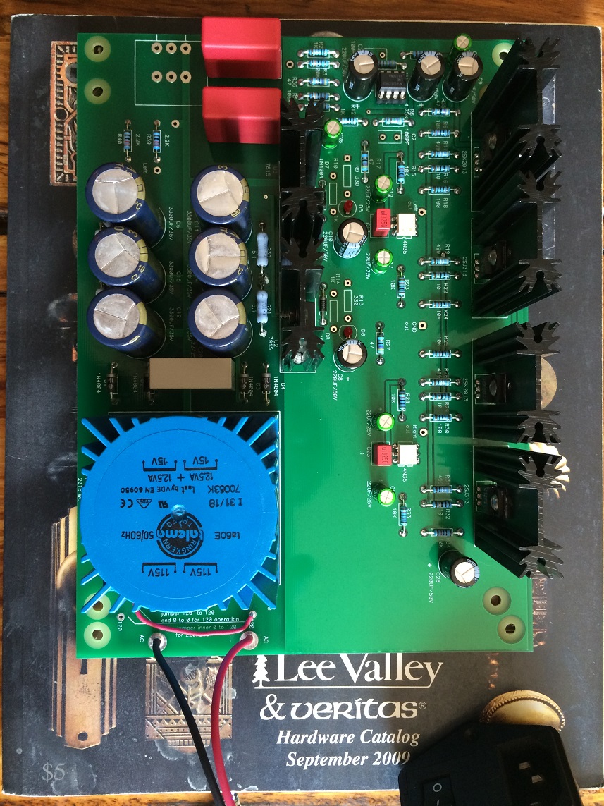

Populated the PCB yesterday on the dining room table while my wife was preparing Christmas lunch. Tested the PSU and all seems to be fine. Now waiting for my Alps pot to come so that I can test the rest of the project.
Used Toshiba 2SJ313/2SK2013 outputs. LME49720NA as Op-Amp. Also have OPA2134PA that I can use for comparison.

Offsets with LME49720NA: -0.8mV and 2.0mV.
Offsets with OPA2134PA: -1.2mV and -0.2mV.
Now I just wait for pot to test with actual music on inputs.

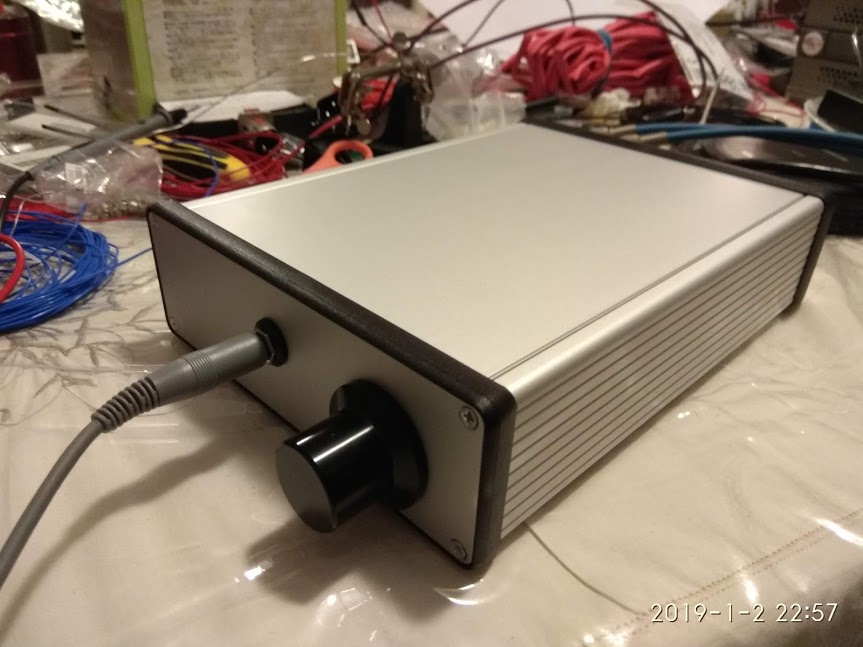

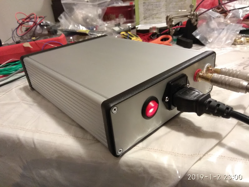

One small step away from completion or so I thought. Start up with Variact set at 30V and 0.125A slo-blow fuse. Instant fuse blow.
Previous start up with temporary wiring to check power supply was successful. Wiring of input socket is correct and nothing appears to be grounded so assume fuse value is too low.
Is there a recommended minimum?
The kit came with 1A slow blow fuses, and that is what worked for me. I have some 0.5A as well, but I have not yet tried them.

Thanks for input.
At this stage I have checked all the logical points including putting insulating sheet between underside of PCB and bottom of chassis. Multimeter shows no obvious path to ground. Since the only change from working condition is wiring an input socket any problem should be limited to that area.
As a next step I will get some 0.5A and 1A and hope (never a good strategy) that will solve the problem.

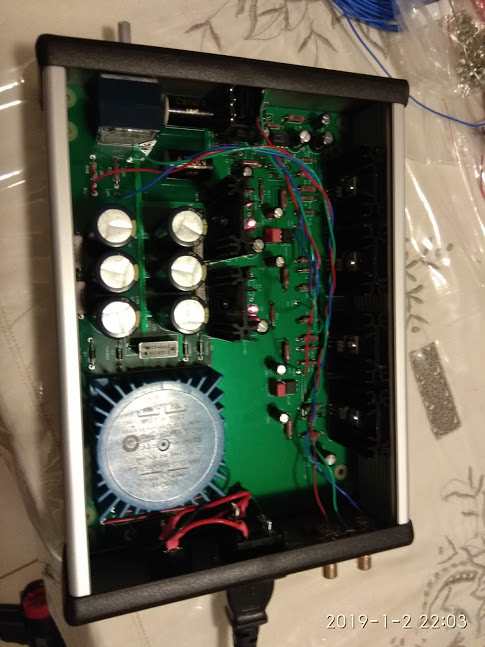

I finally finished my WHAMMY. Big thanks to Wayne for the wonderful
design and for supplying the PCB. Thank you Jim for the build guide.
The build is pretty standard. I'm using a 2x18VAC transformer,
100K Alps pot, Fairchild mosfets and LM4562 opamp. The passives
are mostly Panasonic and Dale. Bias is about 60mA.
I measured about 0.8mV and 3.8mV offsets on the two channels.
(I'm assuming 3.8mV isn't too high?)
I'm now using AKG K701 through the WHAMMY. So far so good.
