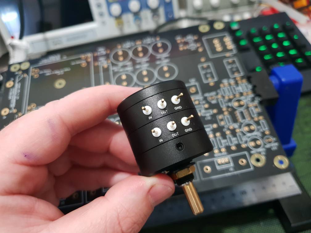

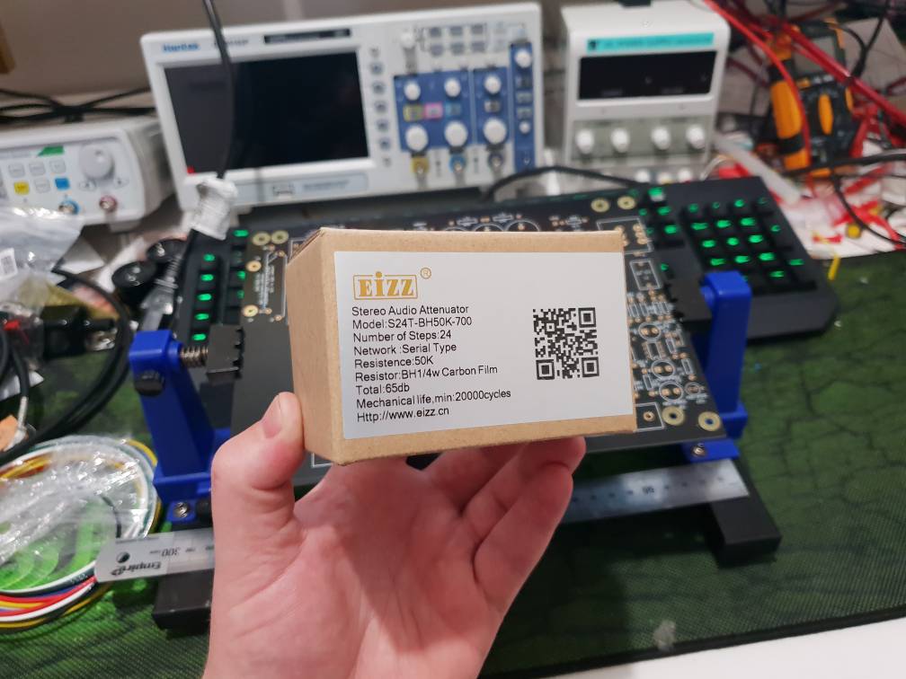

It looks like at very fine 50k pot you have. The kit I got has a 100k ALPS. A 50k should work fine also.

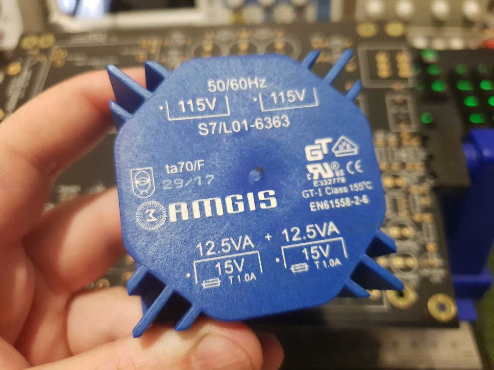

The trafo in kit is 2 x 22.5 V so yours is 2 x 15V …...don't know if this will work. May depend on which opamp you use. If the AD823 can handle the lower voltage it may work but experts should comment here.

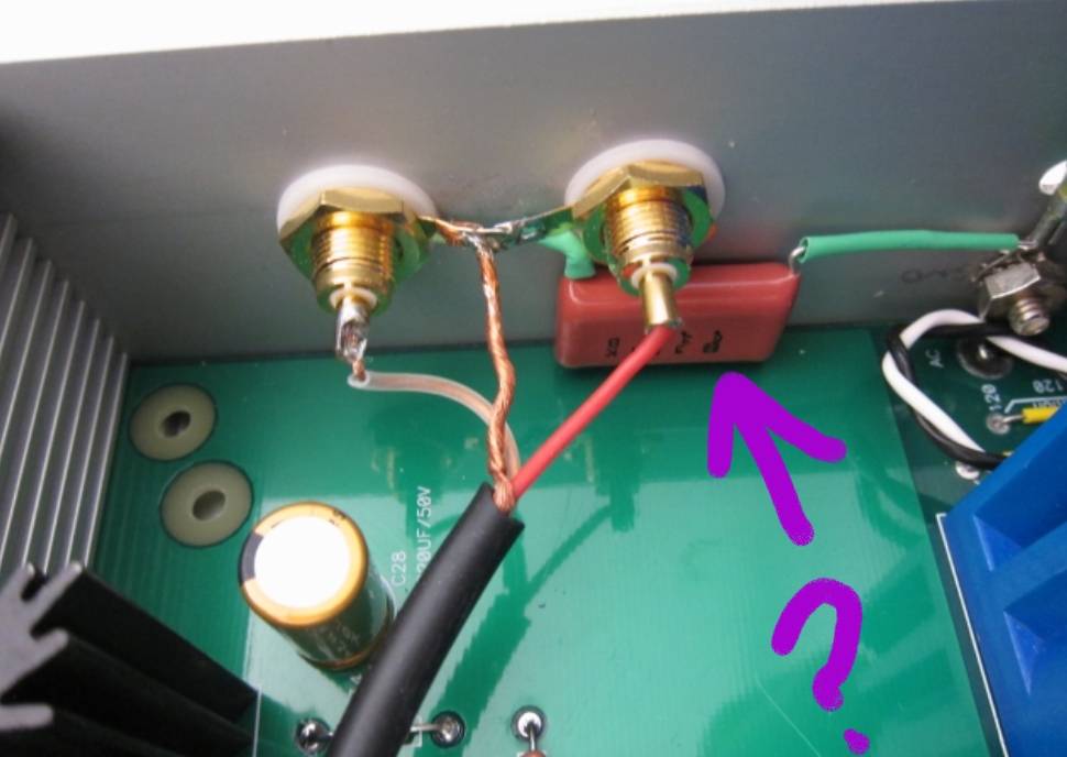

The capacitor is between signal ground and protective ground (chassis). It is to decouple noise without having a galvanic connection from to PE which could cause other problems. Some use CL60 (NTC resistor). Hope I got this one right.....

the transformer will work fine. only difference will be a little less heat on the regulators.
50Kohm pot is better then 100Kohm. 10Kohm would be even better.
the cap in the last pic you can use a 0.1-0.47uF 63V-630V filmcap of any kind.

All your parts will work beautifully.
Of note, the original transformer (22.5v) was speced for those who want to run 24v rails with the 2604 opamp and have the ability for very large voltage swings on the output, as one of the design goals was to have the ability to use the Whammy to drive an F4 amplifier.
For headphone use and using Whammy as a preamp into essentially any power amp that has some gain, the 15V transformer will be more than enough. 😀 😀 😀

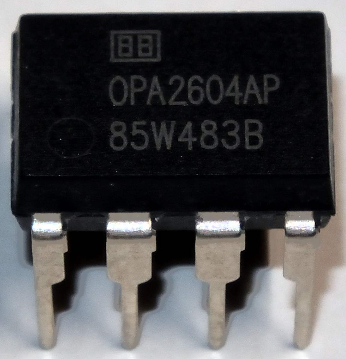

I just got OPA2604. Should be the original Burr Brown. I am 99% sure it is the original and not a copy from China. If somebody can recognize something from the printing which can confirm this I will be happy and also happy using +- 24V. Then it should be good for the MoFo also.
What was the reason to select a 100k pot for the Whammy kit instead of a 50k?
