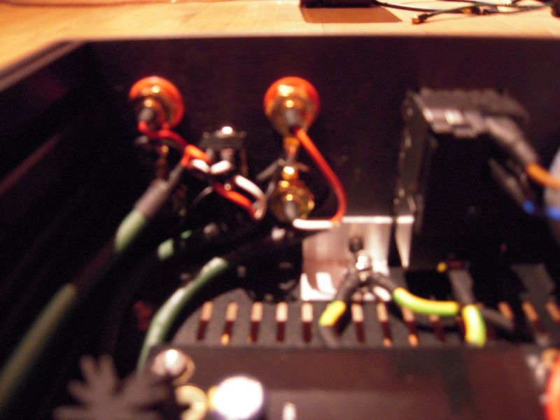

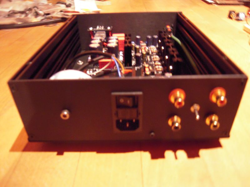

I'm contemplating picking up a Whammy kit from the store - one quick question: I'd like to use this as a preamp (driving an ACA) as well as a headphone amp. For wiring the preamp outputs - is it as simple as just connecting some RCA jacks in parallel with the headphone jack??
TIA, Rich
Whammy output
Hello mpeg2,
in my opinion you can parallel the output to the headphone jack and the rca-
jacks. But you should not drive a headphone and a poweramp simultaneously.
(Perhaps i am wrong?)
I did it with a switch. I used a japanese MIAYIMA- switch. (2-pole changeover
switch). Simple and effective. Also if you forget to pull out the headphone jack.
Will send you photos later. Battery of my camera is low.
Greets Dirk

Normally the headphone impedance is very low (30-60 ohms) and the preamp impedance is very high (10k or more), so the line impedance doesn't really matter. However, you may get massively different volume levels between the line amp and preamp if they are driven simultaneously ;)
Dirk: Thanks - I figured it would be that simple.
I'd guess that there won't be any problems driving both simultaneously (the power amp would show a high input impedance & not really load down the headphones) - however, as long as you are in the habit of unplugging headphones while not in use, then a switch wouldn't be needed anyways.
I think I'll jump onto the pre-order in the store.
Rich
Whammy output switchable

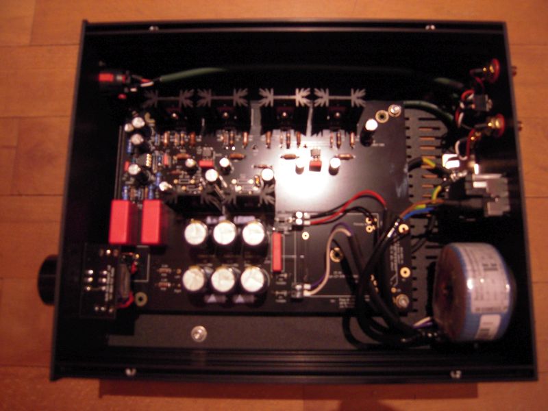

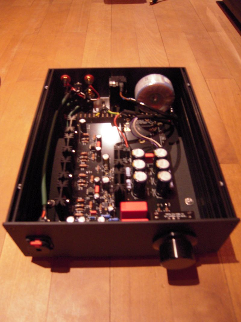

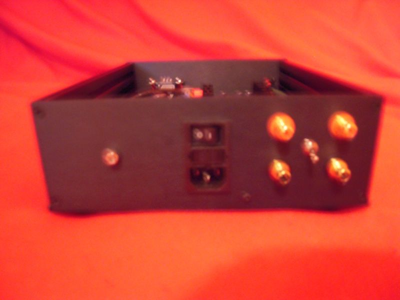

some pics.
My WHAMMY sounds super! As a headphoneamp as well as driving a
poweramp.
And I am challenging! I was used to listen to a STAX-headphone on a good
poweramp.
Big Thanks to Wayne Colburn

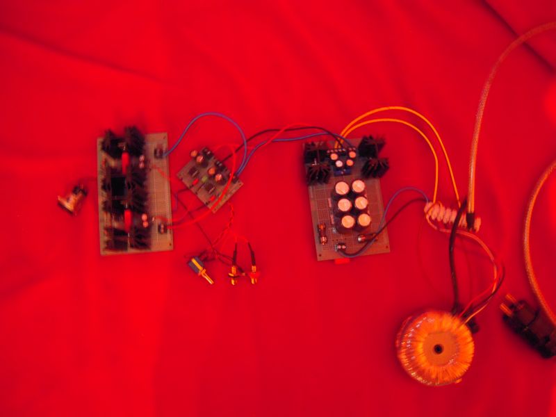

Hello labjr,
I tried different voltages on my WHAMMY-prototyp before the official pcb
came out. I have built a regulated PSU very similar to Waynes design.
I used the 'oldtimers' LM317 / LM337 to make the voltage adjustable. You can
see the blue trimmers on the photo.
My opinion is: it was very difficult for me to hear a difference in the sound
depending on the rail voltage. I tried between +-15 to +- 17.8 volts (depending on the opamp). But i am pretty sure you can measure a difference.
But I could hear a big difference in using different opamps at the inputstage.
Every opamp had its own 'character'.
And I am a friend of high rail voltages.
But that is my experience. Yours can be different.
My opinion is: build the WHAMMY and try it. You will like it.
And try different opamps....
Greetings from Dirk
