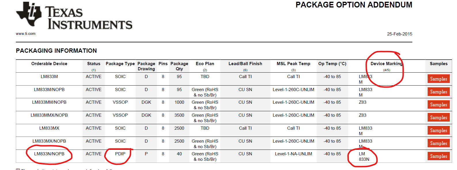

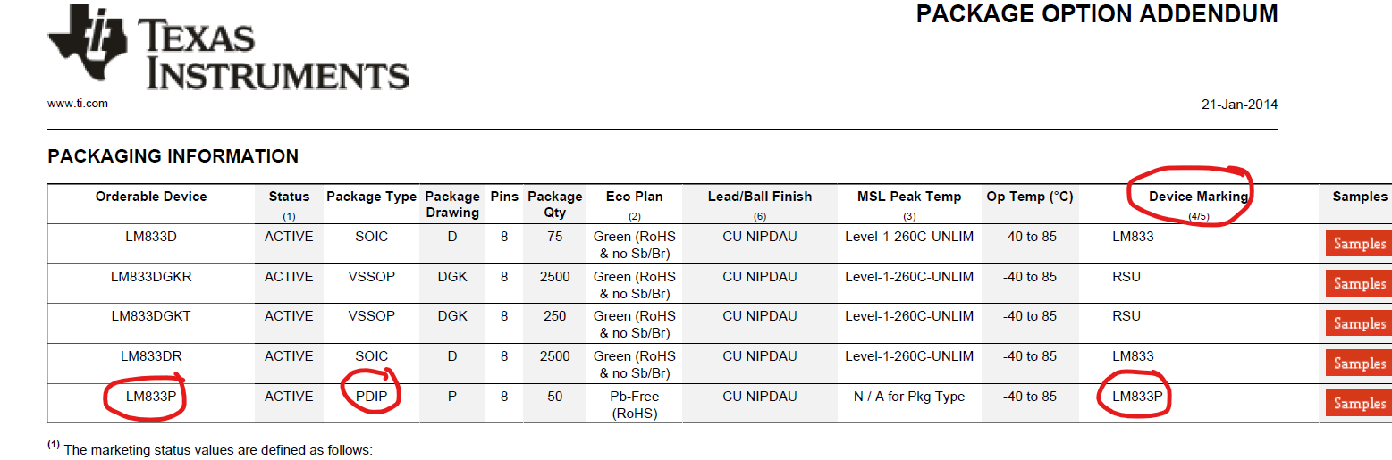

I have the lm833-N, is it right?
If it is Texas brand it is the old version. Any old stock National Semiconductor versions are all the non Quasi type.
This is the reply I received many years ago from TI.
LM833-N is an op-amp originally from National Semiconductor. NS named this device as LM833. As for the package, LM833N means a PDIP package LM833-N. NS calls PDIP package as “N” package.
TI developed another LM833 as 2nd source device and named it LM833. When TI made LM833, TI changed its output stage to NPN type from VPNP.
After TI acquired NS, TI renamed NS’s LM833 to LM833-N in order to differentiate the LM833-N from TI’s LM833. Please don’t be confused by LM833-N and LM833N.
This is the Quasi:
This is the original:
Thanks Mooly.
I have the LM833N/NOPB
original. The acronym 833N is printed on the operational amplifier.
Is this the right one for the Whammy?

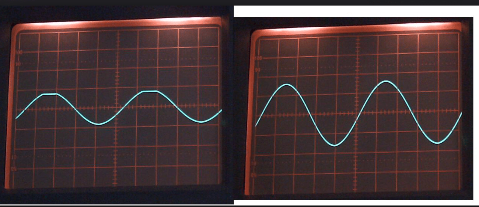

NOPB simply means no lead (lead free). Either type will work and the original was still very highly regarded. LM833N was the original NPN/PNP outputs stage.
This is something I posted a few years ago. Original vs Quasi LM833 driving a 100 ohm load. Scope on 5v/div. The WHAMMY won't come close to needing this drive ability.
