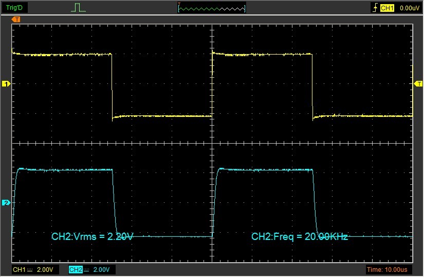

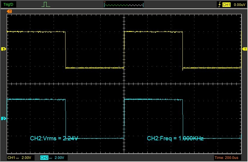

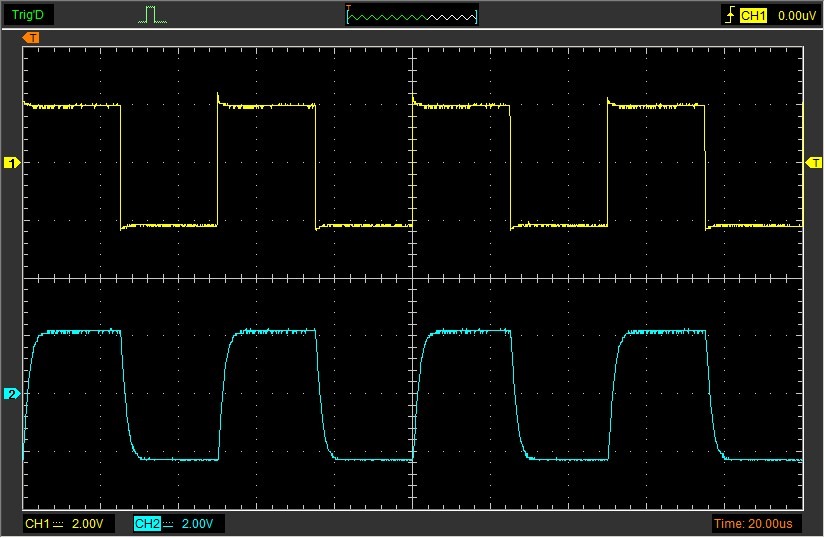

LME49720 & OPA2604 do not oscillate without C2&C7, no compensation is required. When even 22pF is added for compensation, the LME49720 oscillates.
The OPA1612 does not oscillate only if a Zobel network 10ohm+47nF is added to the output. Compensation even with 22pF causes oscillations with or without a Zobel network, so this OPA should be used without compensation.

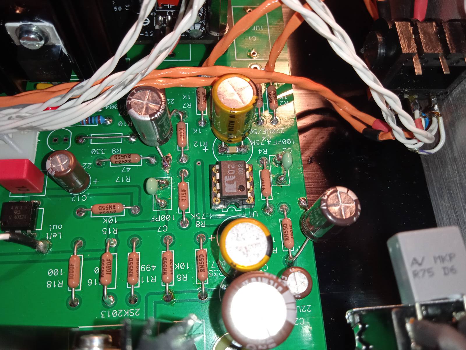

100uF &100 uF Low ESR caps added in parallel to C26 & C27. The result is that the lower cutoff frequency has dropped from 8Hz -3dB to 1.5Hz -3dB.
The input signals from the potentiometer are fed directly to R2 & R7 and the cable shields to the grounded ends of R3 & R5. I did not use input capacitors, everything is DC coupled.
When the potentiometer slider is on GND (0R - min. volume) output DC offsets are -0.7 to -0.8mV. When the pot slider is in the end position (50k - max. volume) the output DC offsets are +3.1 to +3.2mV (with the Muses 02).
Quiescent current on both channels is 58mA and does not change with heating.

The schematic shows 220 uF / 50 V for C9 and C28 at the regulator outputs, which is fine since they're low enough impedance that ceramics aren't needed in the regulator passband.
However, I bypassed C3 and C4 (220uF/50V) at the opamp rails with a 10 uF ceramic at 50V (still pretty cheap at less than a buck) which deals nicely with electrolytic series inductance.
More: bypassing electrolytics with 0.1 uF is counterproductive since that sets up a parallel resonant tank which jacks up the impedance right where you don't want it, close to the opamp's unity gain where typically phase margin is at a premium. 10 uF is large enough that the electrolytic's series resistance is high enough to swamp out the resonance, not the case with the smaller capacitor.

Though I said earlier the WHAMMY didn't need ceramics, mikorist's comment reminded me that I played it strictly according to Hoyle: the LM7815 got 0.33 and 0.1 uF ceramics at the input & output respectively, while the LM7915 received 2.2 uF tantalum at the input and 1 uF tantalum at the output, just as the spec sheets say. For kicks & grins I put in a 3.3 uF ceramic on the 7915 output, which made the thing oscillate at a few hundred kHz. The 7815 is more forgiving, whereas the 7915 uses a different circuit more sensitive to low ESR capacitive loads.
I'll have to put the thing on the hoist to check, but I'm pretty sure the last electrolytics in the power supply also got 10 uF ceramics in parallel. Incidentally, the PSU is LCRCRC. Since it's Class-A the current draw is steady enough to keep an inductor-input power supply happy.
