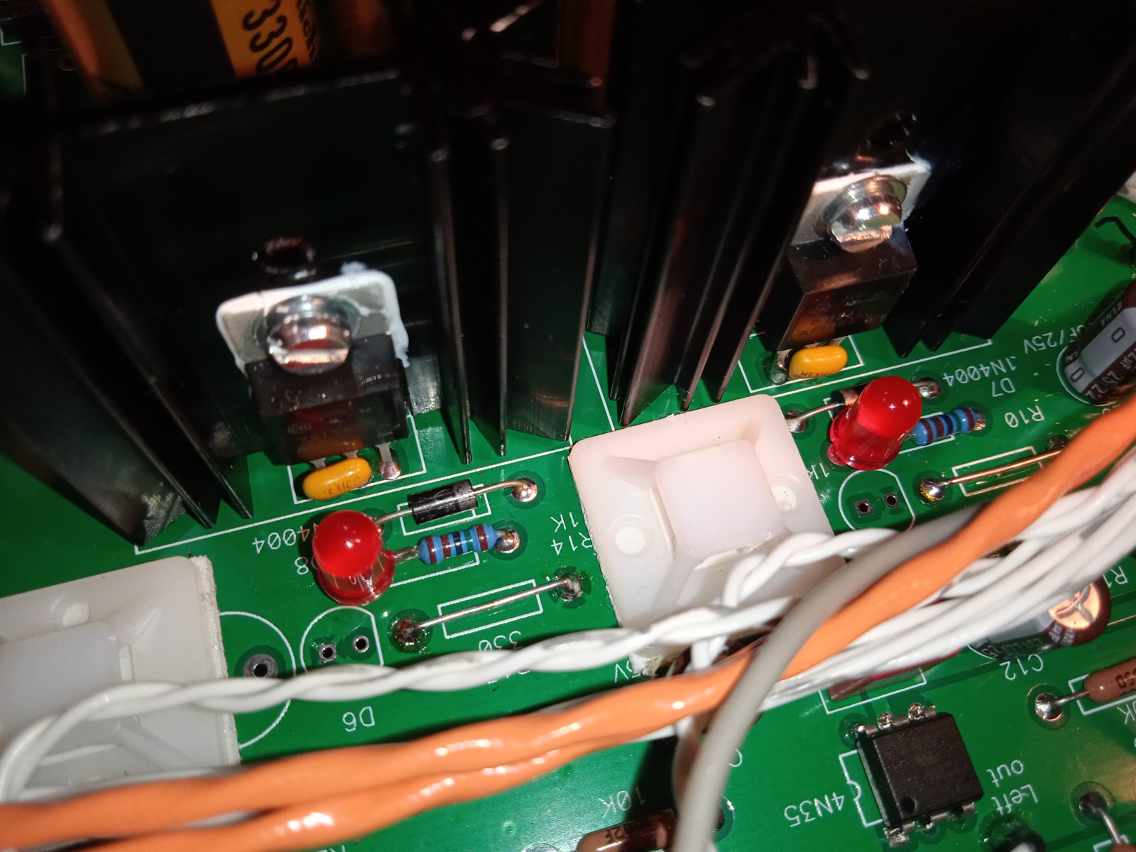

I use a current of 0.2-0.3mA for blue LEDs, even that is quite bright. So for a 15V power supply, take a 47k-56k resistor.

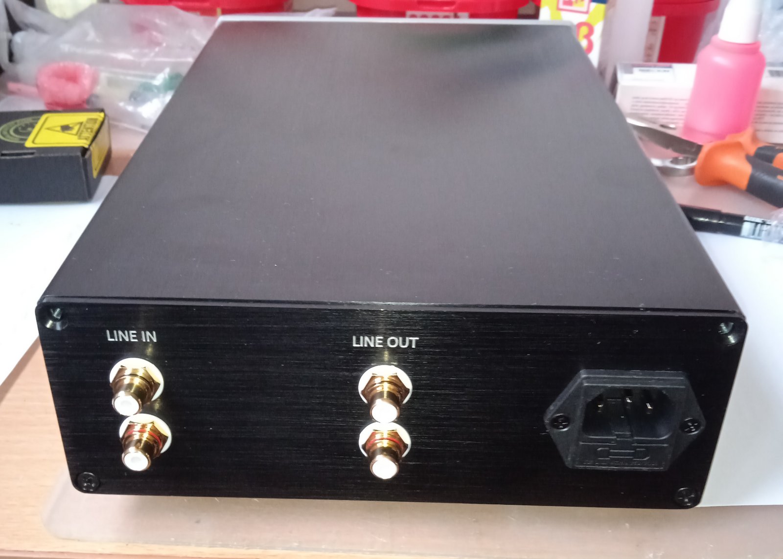

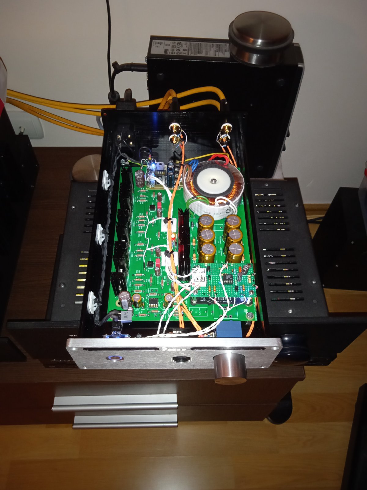

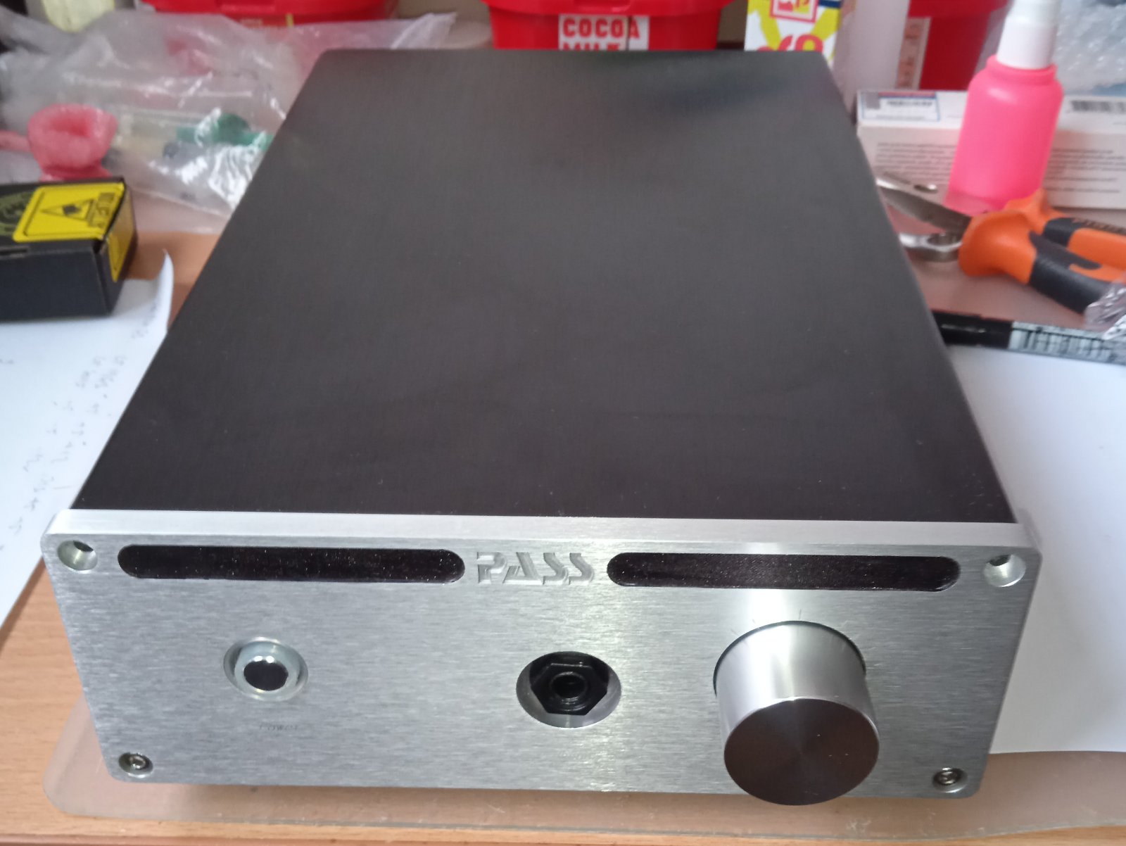

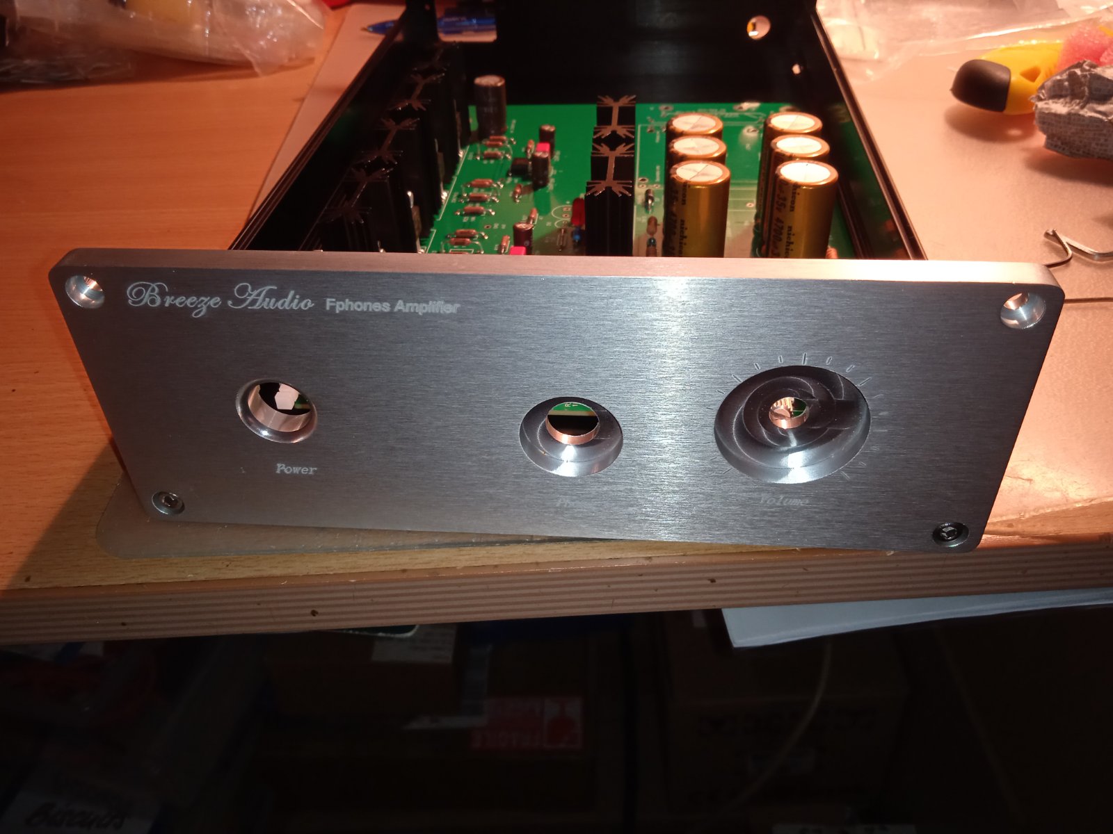

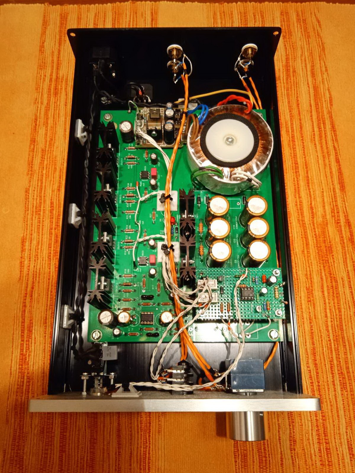

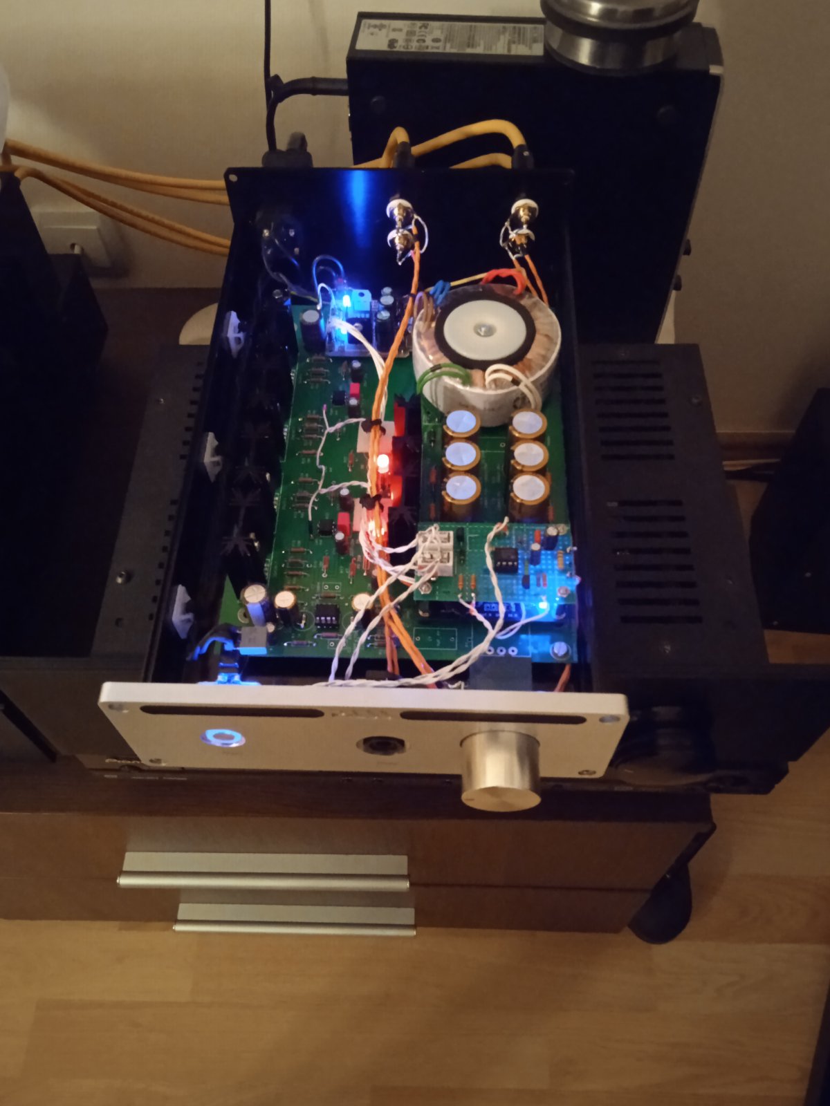

Another Whammy came into this world yesterday. For now, I have no complaints, the device is completely silent and plays well. LME49720 was used for the first test, and there will be better OPAs on the test. I enriched it with DC voltage protection for headphones and a Mute circuit for a delay of 5s from switching on. The transformer is 30VA custom made, with a blind thread and a magnetic shield. It is also excellent as a Line preamplifier, although it is slightly overkill for that purpose. 🤣

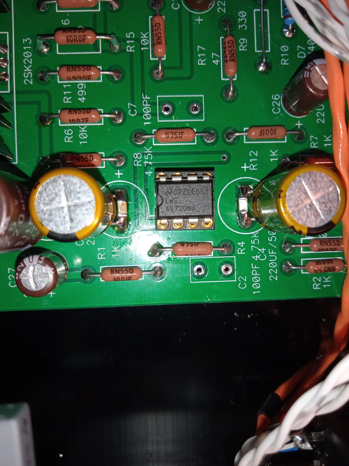

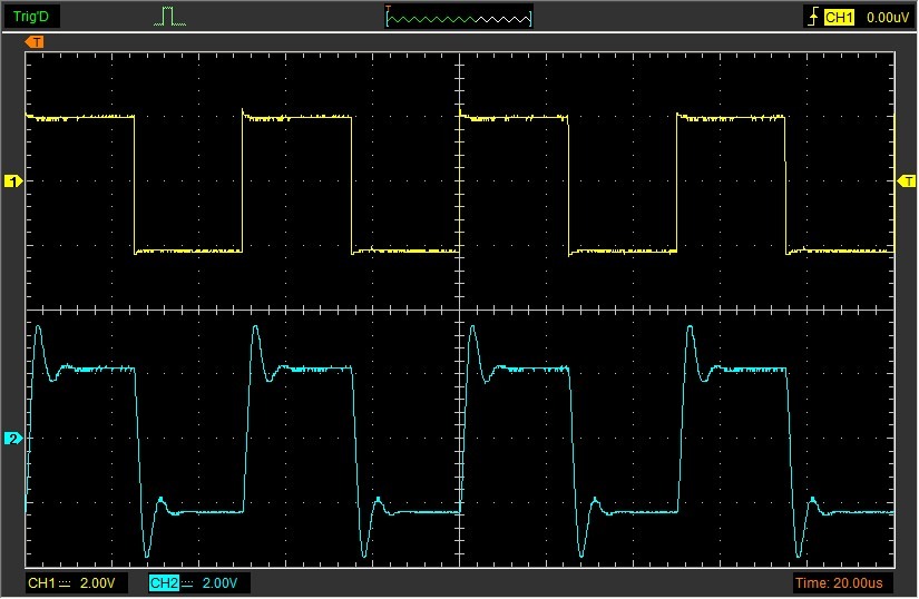

Oscilloscope testing revealed oscillating problems. The first opamp I tried the LME49720 oscillated slightly with any compensation value (C2&C7) so I removed them and add a 100nF decoupling caps to the opamp supply and to the 7815/7915 input pins. The oscillation in operation stopped, but a strong low-frequency oscillation appeared when it was turned off (just for a few seconds).
The next test was with the OPA2604 in the same configuration, there were no problems.
Then the OPA1612, it oscillates like crazy no matter what you do to it.

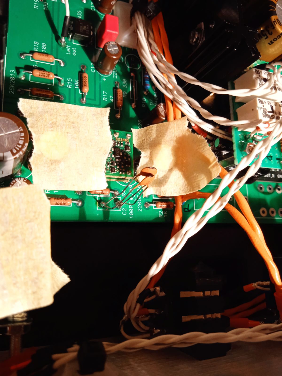

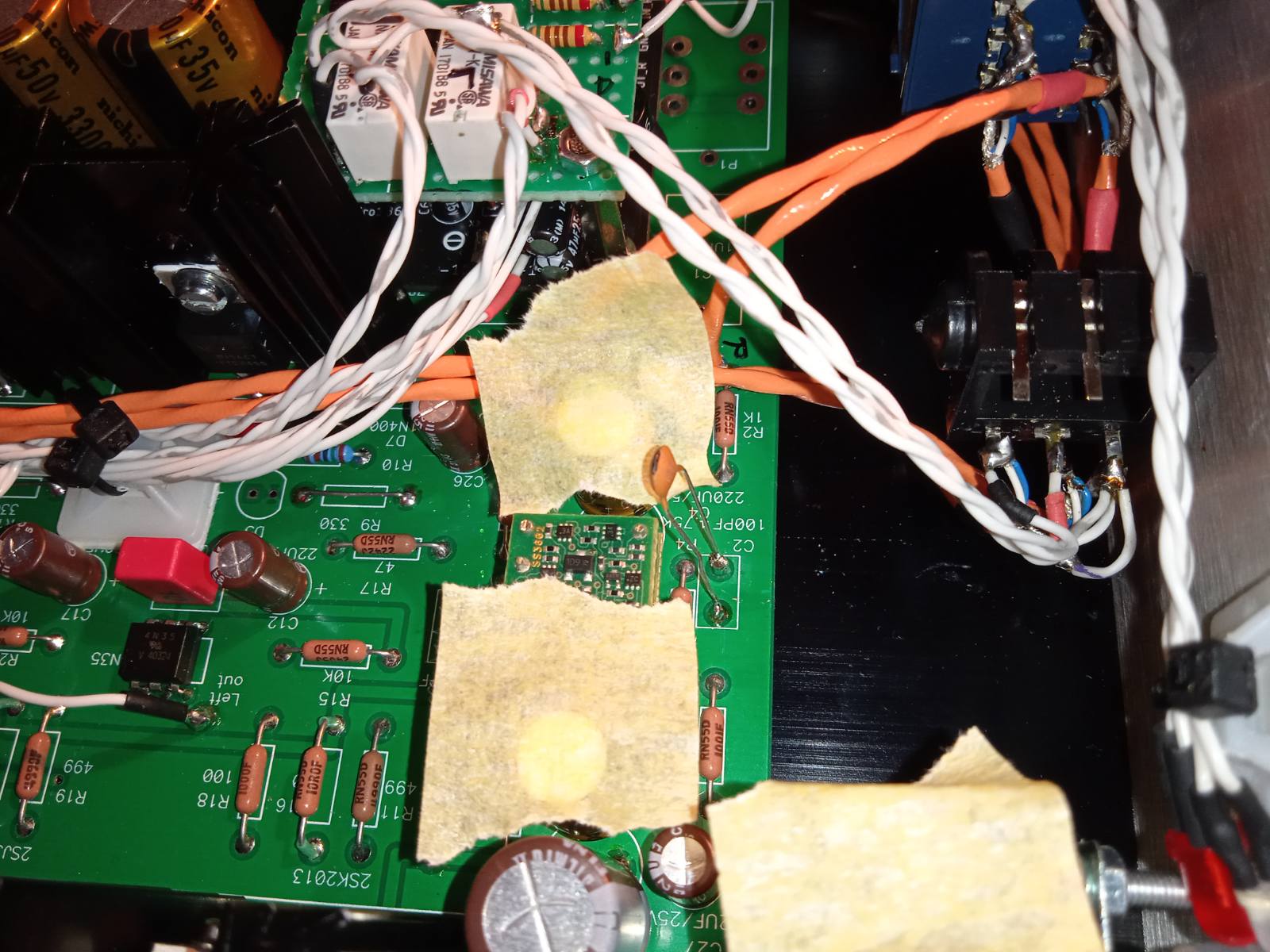

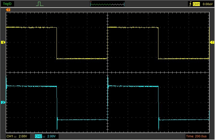

I was then able to get the Sparkos SS3602 to work nicely, it needs 68pF compensation to reproduce proper squares without overshoot.

I successfully tuned the amplifier for the OPA1612 by adding to the output a Boucherot cell (Zobel network) 10ohm+47nF. Everything is perfect now, regular squares without any compensation. The frequency range of the amplifier is quite wide, it goes up to 650kHz -3dB.
On the lower side, the limiting frequency of 8Hz -3dB is determined by C26 and C27 (22uF). I think that is too high and at least 100uF should be put there.
Then I return the Sparkos opamp, because that is the ultimate goal. Now he oscillates like a fool. I take off the Zobel, the oscillations disappear.
The device is a real challenge, it has to be tweaked for each opamp separately. 😎

I forgot to mention that the Muses02 was selected because it sounds more refined and aesthetically pleasing than the Sparkos. Additionally, we were unable to achieve proper square waveforms on the oscilloscope with the Sparkos when the volume was increased. It only functioned correctly with 300pF compensation (C2 & C7). In contrast, the Muses02 operates from 2 Hz to 350 kHz with proper square waveforms at -3 dB with 68pF.
