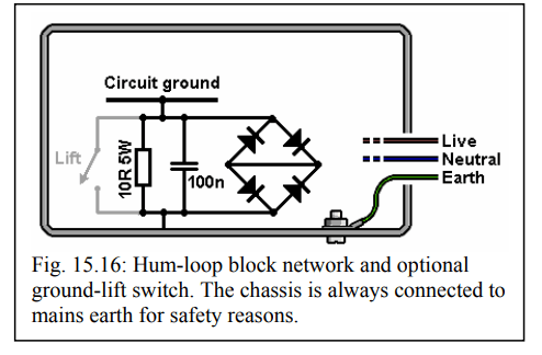

I built a WHAMMY last year that is working great. Now I'm building another WHAMMY for a friend. This new kit did not include the brown capacitor between the input shields and chassis ground (I'm not sure of the value since my old build has the cap buried where I can't see the markings). The new kit does include an otherwise unused yellow axial capacitor that I suspect is intended to be equivalent to the old brown cap. The markings are: ic 334K 1914 100V T MWR
Can anyone confirm that the new yellow cap is the one to use where the brown cap was in the old kit? And can anyone help extract the value from the markings on the yellow cap? I have tried searching this thread but I'm not finding any discussion of this cap.
Thanks in advance.
I put this in place of that one capacitor. R=22ohm 0,6W and without a ground lift switch.
