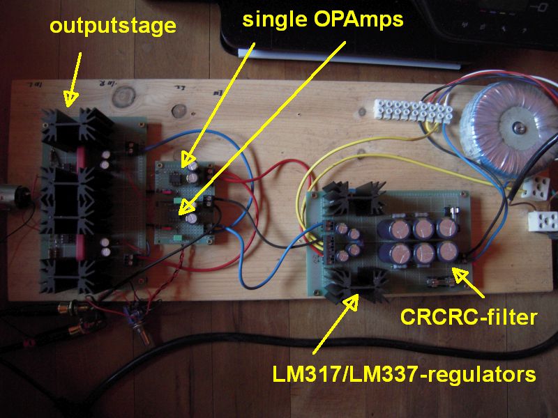

to kozard #4193
Hello kozard,
I did something similar as you describe it. I built a CRCRC-filter followed by
LM317/LM337 regulators (adjustable rail-voltages).
And I used single-OPAmps. But I didn't went much lower with the railvoltages.
Was depending on the max. railvoltages of the OPAmps which were used.
And yes, it doesn't look so nice on the wooden test board.... but it sounds great.
Cheers
Dirk 😀
