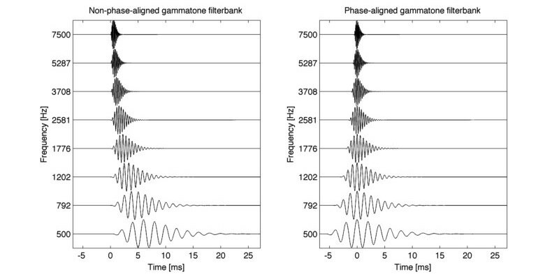

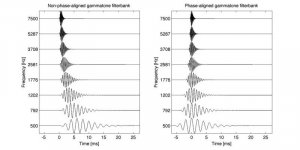

Earl, would this nice picture suffice? Way out of my depth here but I've seen you speak of the gammatone model before and I've wondered if this might be a good basis for a freq dependant window for in room measurements. Might actually get us "close" to what we actually hear. Of course I'm not going to do speaker correction based on that. As it is there are so many different ways to display that data in REW it's ridiculous. I can easily set it up so there is a nice in room curve or, with a few clicks, make it look awful just by changing the sliding window. In this case I set it up so that it follows what I think I hear but that's certainly not definite.
