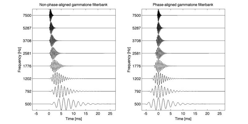

Earl, would this nice picture suffice? Way out of my depth here but I've seen you speak of the gammatone model before and I've wondered if this might be a good basis for a freq dependant window for in room measurements. Might actually get us "close" to what we actually hear. Of course I'm not going to do speaker correction based on that. As it is there are so many different ways to display that data in REW it's ridiculous. I can easily set it up so there is a nice in room curve or, with a few clicks, make it look awful just by changing the sliding window. In this case I set it up so that it follows what I think I hear but that's certainly not definite.
Nate - thank you very much, that is exactly the data that I was looking for and clearly points out the issue that I was discussing.
I do smooth my data using a Gammatone filter bank, but not as a sliding window. The sliding window is not precisely the same as smoothing with Gammatone filters. Admittedly, a sliding window is a lot easier. But I actually do use Gammatone smoothing (also known as ERB smoothing) to EQ my speakers.
Hi, I think the gammatone pictures has it backwards. ....
My understanding is that phase alignment happens when initial rise of all frequencies occurs at t=0.
Not with peaks being in sync.....
Maybe I should ask what a gamma tone is ?

My impression is that this looks like a depiction of tone bursts for a minimum phase system (left) vs a Linear Phase system (right). Group delay would then be flat for the chart on the right. Is this thought correct?
I think left is linear phase....with 0 deg phase and 0 group delay.
Took me forever to get this....that initial rise time is the alignment point.
Peaks occur when they occur, ie 1/4 wavelength past initial rise
