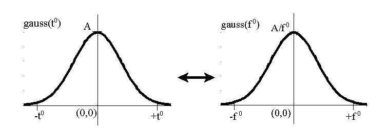

frequency spectrum, time envelope?
When people talk about frequency spectrum and time envelope, they actually are only skirting round the complexities of our 4 dimensional spacetime and the quantum theory. What about impedance, phase, dispersion and power response? Loudspeakers might seem to be an easy enough problem to solve, but IMO, you will run into the mathematical complexities of our Universe. 😀
Trust me on this, whilst we use 2D Fourier Transform to analyse what we are hearing, it's not the whole picture. For instance, how do you measure distortion? Maybe in terms of 2nd and 3rd harmonics. It's actually not the only way to do that. We old radio engineers used to use an entirely different technique called "White Noise Testing".
The idea, loosely, is to inject a bass frequency to the woofer and listen for noise from the tweeter. You do get noise from the tweeter, because the system is non-linear. A sort of crosstalk.
This whole thread is really about sharp changes in any parameter, versus gentle ones. And actually, if you want smooth, you use the 2D Gaussian transform. If you want sharp, you use 2D Fourier transform. TBH, something in the middle works for me. The correct theory, IMO, is Claude Shannon's idea about information. A loudspeaker is a channel that conveys information, and time and noise and bandwidth are factors in this.

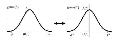

I only quote that since we are turning the page. I am assuming you've done the homework and know who Steen Duelund is: Articles by Mr. Steen Aa. Duelund – Duelund Coherent Audiodoesn't most DSP use Fourier?
Mathematically speaking, Fourier transform is about sine waves and brickwall filters. It's not the only game in town. AFAIK, there might be an infinite number of orthogonal (right-angled and hence linearly independant) functions you might use to analyse a linear system.

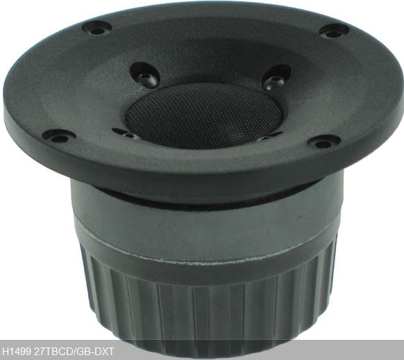

What is good about this one?
Or this one?
Or this one? (which is a Scan/RAAL combo, FWIW)
I could answer that. But if you asked me which one is best, I'd be struggling. 😀

Here's the thing about Fourier Transform. It doesn't actually work perfectly. Gibbs phenomenon - Wikipedia
It has some infinities involved which cause terrible problematic wrinkles. It's called the Gibbs phenomenen. The spike on the edge of the pulse never goes away.

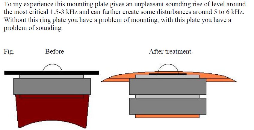

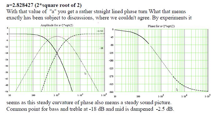

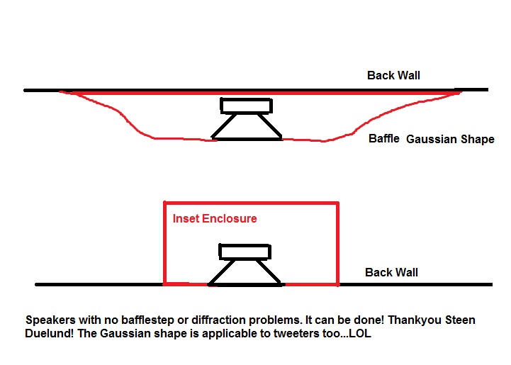

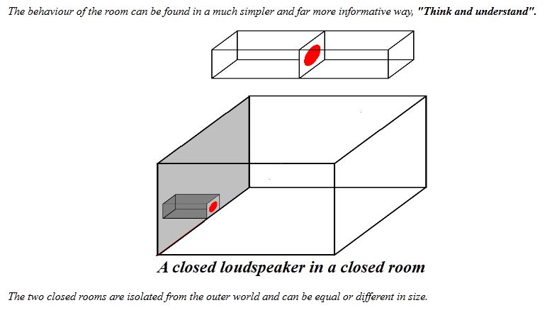

I have a lot of Steen Duelund images from his work. He was actually a fourth order LR4 designer in two ways, and would use something resembling LR2 or LR4 in three ways, but always with very good phase alignment. He seemed to favour closed box and ring radiators too. Third order BW3 was not one of his interests, AFAIK, but remains another part of the repertoire than can work well.
But Steen was interested in everything in the loudspeaker. This can be power response from a circular aperture which has some relevance to the dispersion aspect of a loudspeaker:

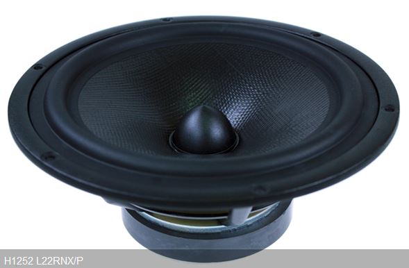

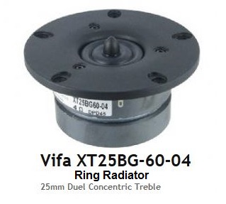

You can spend a lot of money on drive units designed along his principles. But in fact, SEAS and Vifa would get his approval. Perhaps they have read him? 😀

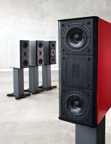

judging from Gryphon speakers that he allegedly designed (eg. Gryphon Cantata) it seems that he wasn't particularly interested in diffraction or speaker-room interaction (I mean the pattern of room reflections generated by the loudspeaker)... basic considerations when one aims at realistic sound
See, graaf, here I am trying to move things forwards into clarity and understanding, and you want to keep moving back into confusion. Read some more: Articles by Mr. Steen Aa. Duelund – Duelund Coherent Audio
It took me years to understand some of his ideas. But his methods apply to ALL loudspeakers. And, FWIW, the Gryphon designs can only be said to be based around his ideas. But I see a great understanding of MTM diffraction and lobing there, because that is actually an MTTM if you think about why a ribbon is used.
Duelund had great understanding of all diffraction and filtering. But thought about it in a much more holistic way that applied to ALL loudspeakers. This was his genius. You eventually realise that ALL loudspeakers are just varied solutions to the same problems. A spectrum if you like. More of this, less of that. And some issues never completely disappear. You compromise. 😎
I'll run you through his filter ideas in another post if you are interested. His discovery of how a two-way and a three-way is really the same speaker is very clever.
well, I only know what I can see, what has been shown.
So please show me some genuine/100% Mr. Duelund's designs or just link a paper covering the questions of diffraction and reflection patterns
It's really not my business to have to prove anything. You take or leave ideas in the end. I just reviewed the Duelund article about the cabinet, the units and the room. All made sense to me! 🙂
And, TBH, how is the Gryphon Cantata (since you bring it up) NOT true to some of his ideas? Am I missing something? 😕
