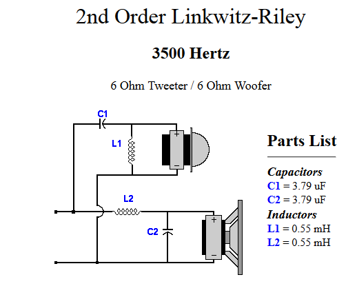

Part of the magic of this system is simply due to the fact that it's a solid LR2 design. Accurate 2nd order slopes are hard to pull off, and only very wide bandwidth drivers with smooth response and low distortion need apply. Make no mistake that shallow slope crossovers sound better than steep slope crossovers. But doing shallow slopes right amounts to much, much more than just throwing a cap and coil on the tweeter and woofer. My Waveguide TMM design was more of a hardware solution addressing some typical LR2 design issues. This Scan Speak / Vifa system is more of an electrical solution.
In the end, an LR2 design has 180 degrees of phase wrap through the crossover while an LR4 has 360 degrees. The lower phase wrap directly equates to an improved midrange coherency. Honestly, most drivers and system designs require LR4 or greater slopes just to work properly. But when everything comes together for a LR2 system, it's the sweet spot in speaker design.

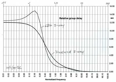

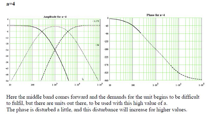

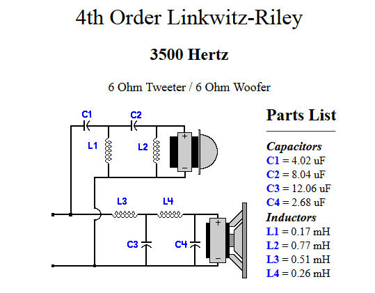

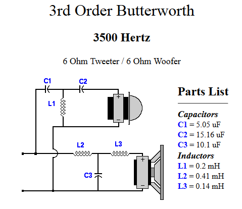

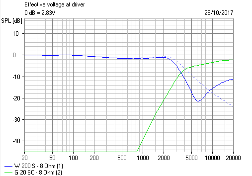

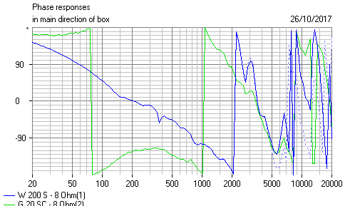

Well-behaved 8" paper bass on second order electrical has goodish natural 4th order LR4 rolloff, but is not without problems. Time-alignment is difficult. It breaks up around 3kHz, as you can see on the phase plot. IMO, this produces mushy and annoying 2nd harmonic distortion at 6kHz. So a notch filter (15R plus 0.68uF across 1mH) takes those out quite considerably. By 10db here. Which is a lot.
But you might as well use a steeper third or 4th order filter with the benefit of hindsight. As Harbeth do. LR2, BW3 and LR4 happen to be elegant solutions in filtering. As I see it, phase and group delay and dispersion issues are not distortion, they are more a transform or tonality with a slight ringing quality. Distortion or breakup however IS fatiguing. And you usually cure it with some steepness, and keeping drivers in their comfort zone.

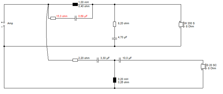

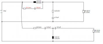

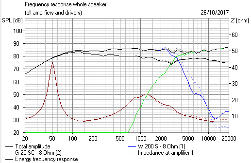

So like Dave says, context is important. A 5" bass is an entirely different animal. The breakup is much higher, around 8kHz. So LR2 might sound OK with a well-behaved driver. And 5" polycones are the easiest example.
