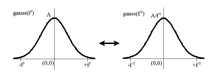

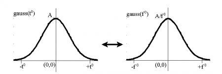

Gaussian response has the interesting property that the the transform is the same shape in the time and frequency domain, mathematically. It's a less sharp filter. It overlaps with adjacent bands in Radio.

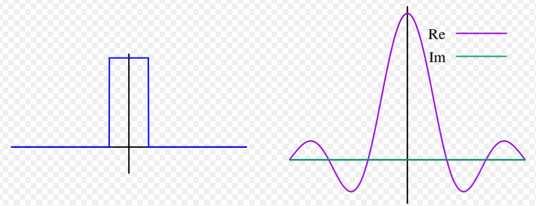

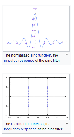

Fourier gets a bit wilder. When you try to put the frequency response in a square box, a steep filter with less cross-channel interference, the time response approaches the Sinc function. Time's arrow plays a part too, but I don't want to go into that here.

Here's more on steep brickwall filters. They have their issues. IMO, the Universe is saying: "Whatever tricks you do, we can always distinguish illusion from reality."

- A Bessel filter is not a Gaussian filter, as you suggest, because its Fourier transform pairs are not the same, as they are for a Gaussian function.
- All filters have Fourier transform pairs, there are not "Gaussian responses" and "Fourier responses"
