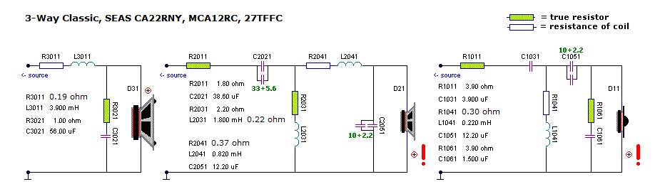

If I was designing my dream speaker from scratch, again, I'd probably go three way on second order LR2 slopes. Like Troels Gravesen's original freebie SEAS 3-way classic with 8" bass, 4" mid and 1" tweet, which seems to have disappeared from the repertoire. But don't worry, I have it documented and stored on my drive! And below. Some question whether he used the RNX or RNY. I think it was the CA22RNX.

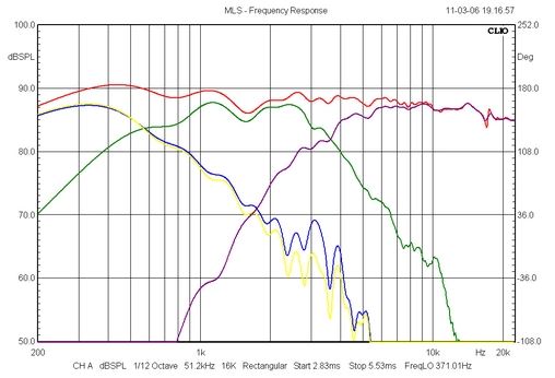

Shallow filters are great, but they distort with high level, especially in two ways. Little Girl With A Guitar stuff.
Steeper filters have great control over cone-breakup and tweeter distortion when well implemented.

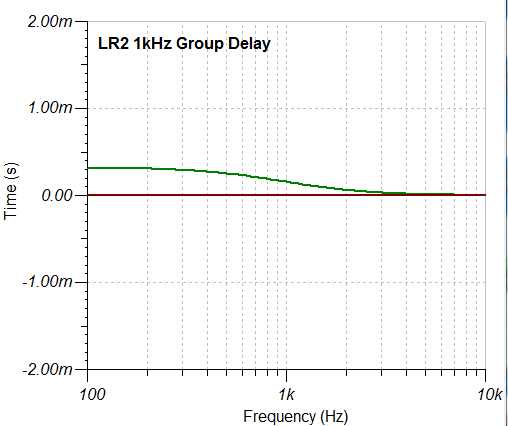

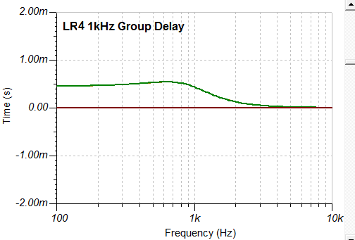

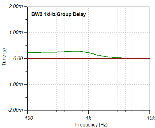

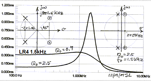

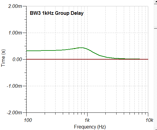

Here's the lowdown on Group Delay, which as any competent engineer knows is the big issue with filters. Can you hear it?
I just knocked this up in Tina TI, with a calculation by Linkwitz Lab to corroborate my results. Interestingly, and this is with time-alignment, typical group delay on 3rd and 4th order filters is almost exactly half a wavelength of the crossover frequency.
You can also see how two BW2 cascaded makes a LR4 with the pole-zero approach. 😎
We might add that reflex enclosures and bafflestep produce much bigger delays. And that there is a subtlety in the flat power response of odd order filters worth knowing about.
Much less so with the choice of appropriate drivers and 200-400 Hz XO points.
