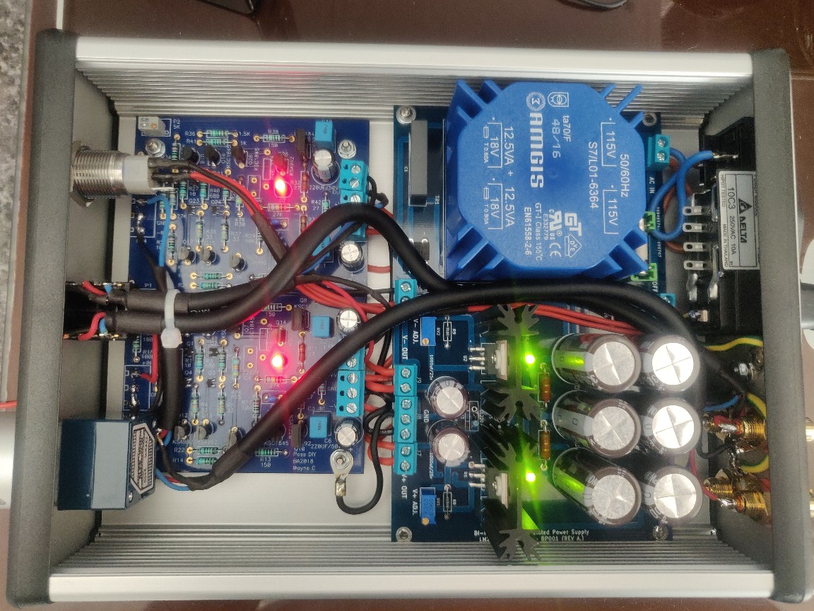

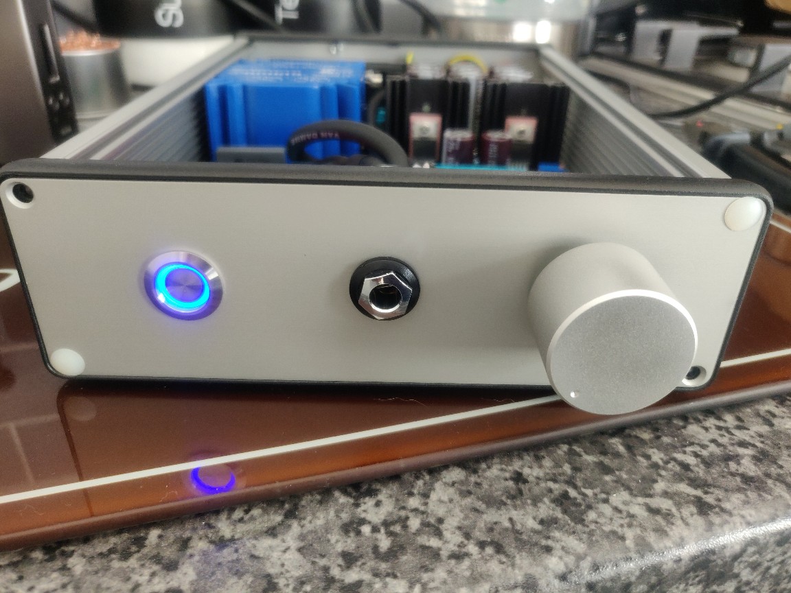

It's finally finished and it's sounds phenomenal!!! Just got the volume knob to change then I'm happy. Really pleased with how my own power supply performs too. It's super quiet! 🙂
Here is my version of the BA2018 based on the purple boards, right now using bluetac to hold the boards. Running with Silent Switcher using a mobile adapter and using the +/-15v. Works perfectly with a 50k TKD pot lots of gain and easily powers my HD598 headphones 🙂
https://ibb.co/r0Pc5Kv
Nice looking build you got there! I used 50K for my pot too but I find the gain lower compared to the whammy as I have to turn the volume up half way to get to my usual listening level. Overall it's awesome! 🙂
Thanks, this is simple DIY chassis from aliexpress which I got long back. Using some drill bit I could make some RCA holes and DC jack hole and the front panel pot. I found it to be clinical with good highs and deep sound stage. Playing Roon core and Pi as transport to my Soekris DAC its very good 🙂
Wonderful!! Nicely done!! 🙂 🙂 🙂
Silent Switcher is a great option for this circuit.
Yes Jim with a +/-15v the BA runs with so much gain and I can hardly think going above can easily drive any power amp.

Does anyone know what the current draw is for the build with the larger output devices. Earlier in the thread the base build was shown as 60 mA per channel, I wondering if I need to beef up my psu if I go with the other outputs.
Too much PS current availability doesn’t hurt.
I had measured this earlier. With the beefier outputs, it’s actually about 40mA/ch at idle.
I would aim for a PS that can cleanly provide 100mA (minimum)... this should suffice the idle current and light loads and nominal listening levels (assuming headphones). Understand a 600 ohm load can increase current requirements dramatically, like 50mA.
It really depends on how often you are driving the preamp to clipping (just at idle) and then adding the load on top of that.
The SilentSwitcher V3, provides +/- 15VDC and 150mA which is very good for this circuit.
