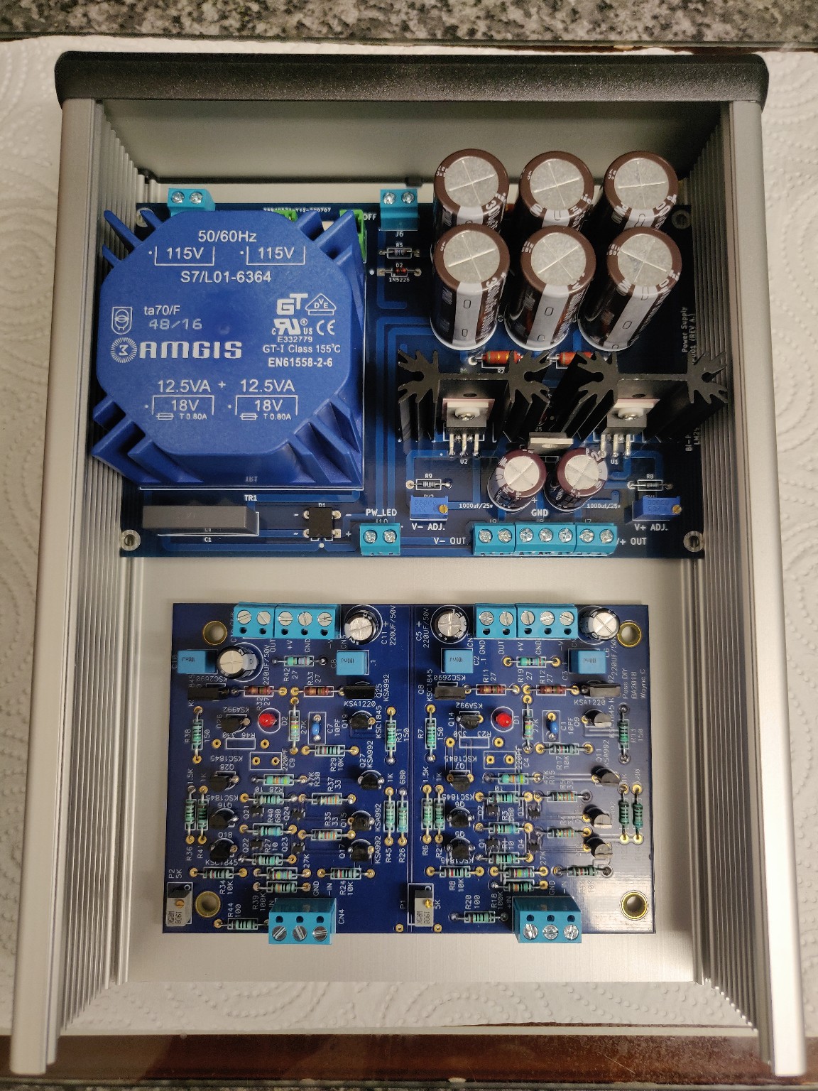

6L6 mentioned that Muffsy PSU earlier in the thread (found via thread search tool). He said "it works great and is very compact".
Thank you! Ordering....
PSU options!
There's also:
VRDN PSU
(compact)
and
Pete Millet's PSU
(You can find more about it on his site under his phone pre, which is what he made it for—I used this one in my BA18 build—VRDN wasn't birthed yet)(VERY compact since it includes the transfo)

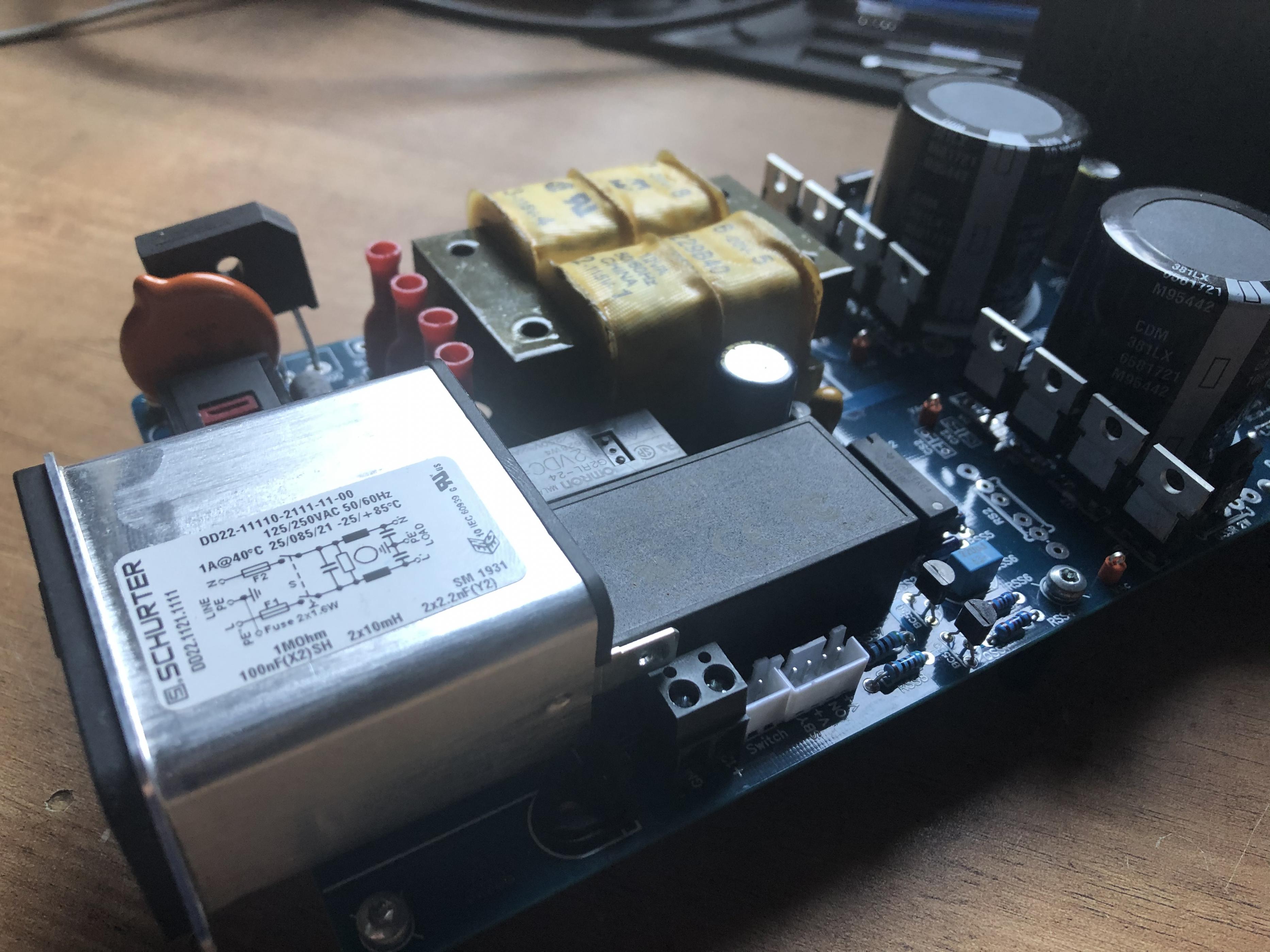

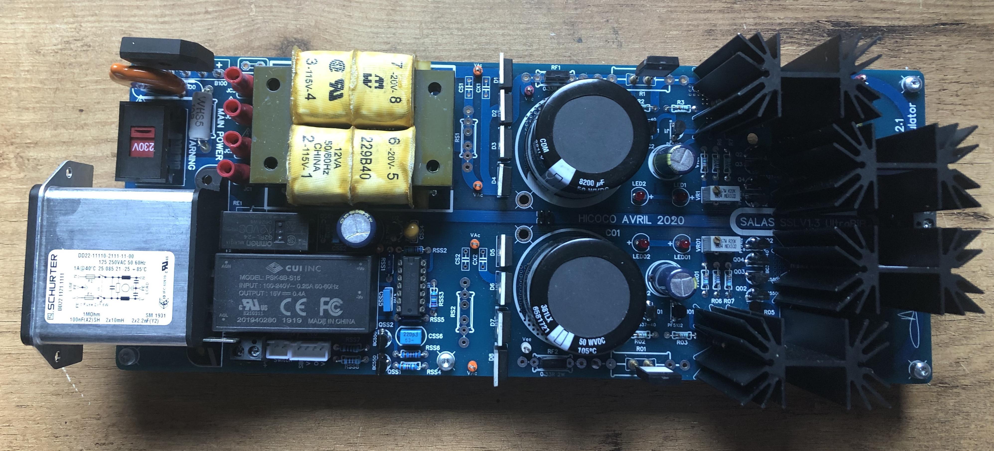

Just finish my adapted Salas UltraBib with on/off, tested with a 2X20V , 12Va 229B40 Hammond, will use it for the new UGC muse preamp with 2X28V, 12Va 229B56 Hammond.
I have cpl of board left, may be that will be good with BA 2018. if interested PM.

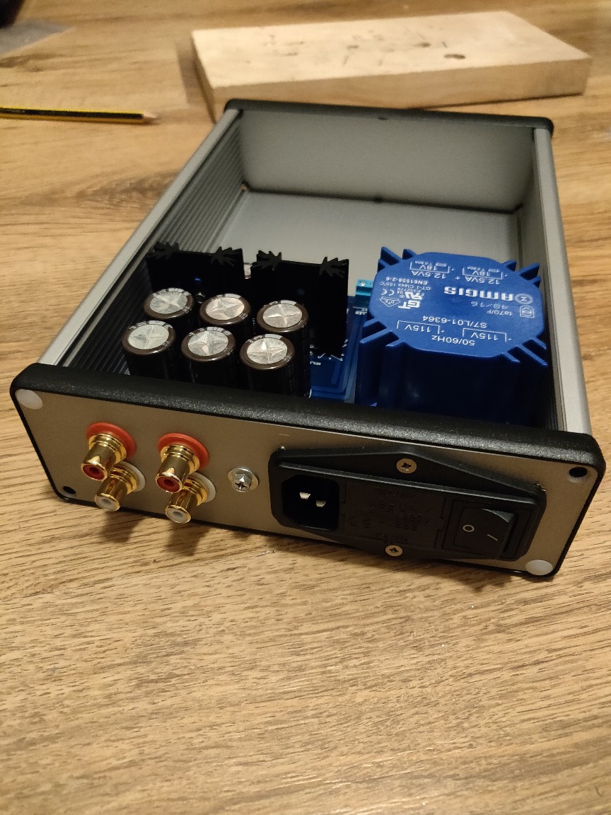

That's what I used on my build, very nice combo.
Here is my build so far. Just got the front panel to drill out and mount holes for the Linestage PCB then wire it all up. Should have it up and running by tomorrow evening all being well. 🙂
- Wayne's BA 2018 linestage
