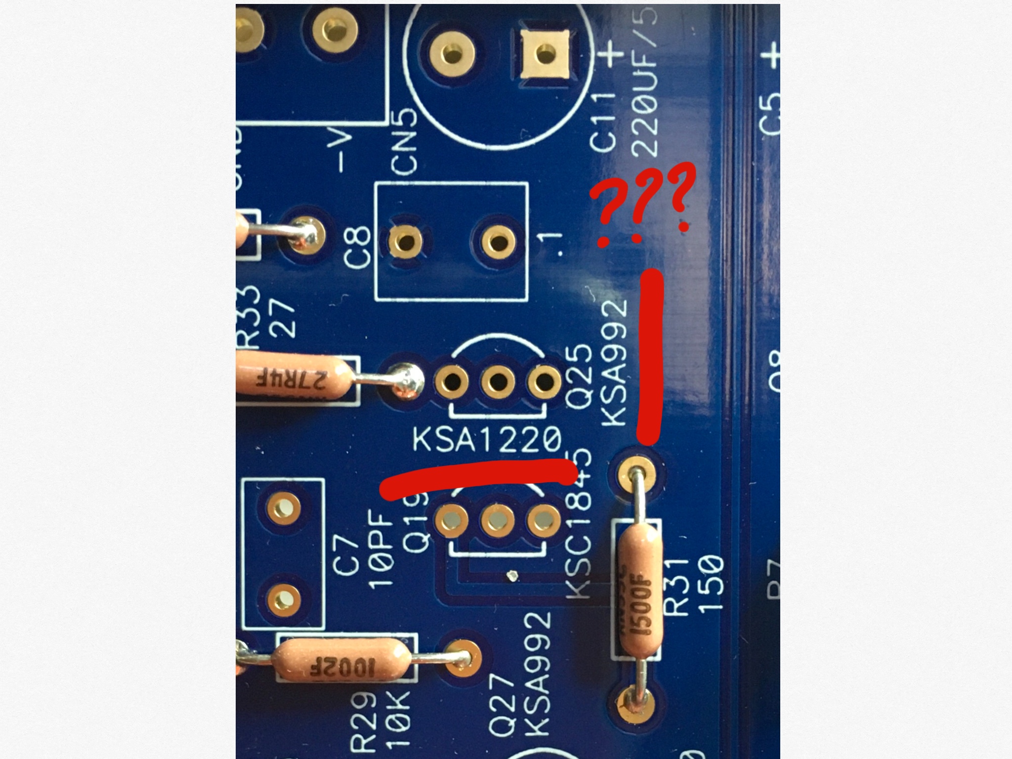

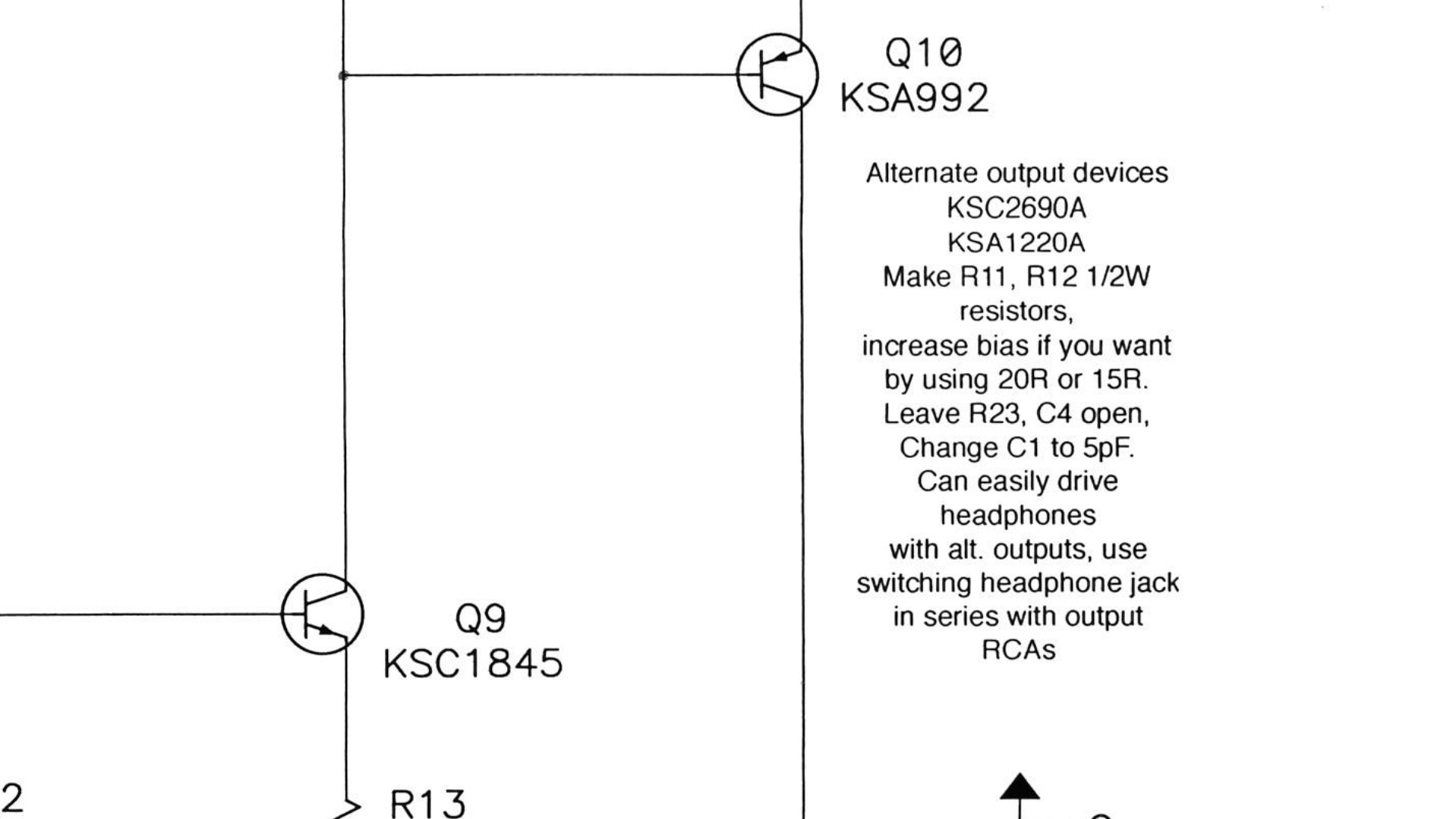

I‘m stuffing the blue boards, and there‘s on position Q25 which I‘m not sure which one to put in: KSA992 or KSA1220?
Aw. Schematic tells it.
Does that mean that it will easily drive headphones if I use all the alternates to the default, to be applied as a variation? (And thus if I stick to the kit, won’t have headphone-capability?
I sorted it out on my own. Sorta.
I‘ll just stick to the variant and see what it gives. [emoji2956][emoji1307]
Still don’t know what would have happened if I went the other route.

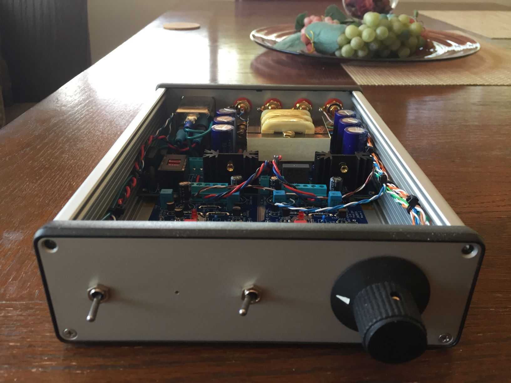

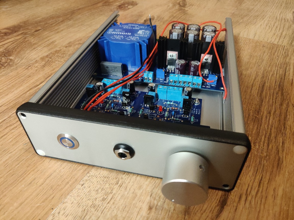

I decided to use the same Hammond 1455T2201 as I used with the Whammy. Everything fits nice and snug. I could have had the board centered but it was offset to allow board connector clearances for the front panel but I decided to remove the connectors in the end but by then I had already drilled the holes in the chassis.
Ahh well it's still nest and tidy and it gives me ample room for cable routing. Still got the wiring to do and I've got a couple of fancy touch sensitive latching switches on the way with halo LED so will test those and may swap out that mechanical switch yet. That volume knob isn't staying either got a more fancy raw aluminium one on the way. 🙂

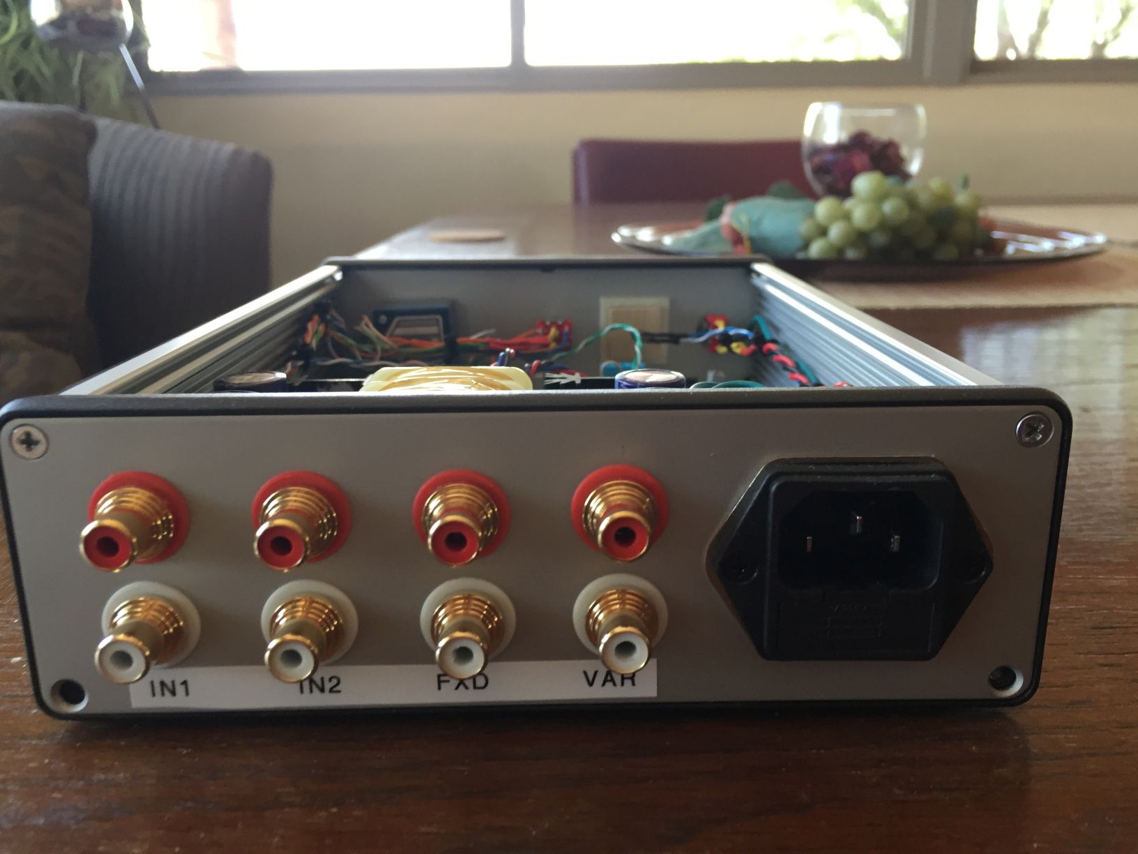

Who makes that plug inlet on the rear panel?
There are two which look identical made by different manufacturers.
Delta Electronics 10C3, DigiKey part no. 1144-1003-ND
Qualtek 764-00/002, DigiKey part no. Q307-ND
I used the Delta one this time round as it's cheaper than the Qualtek one. Quality are good and to me the same as each other. Previous projects I used the Qualtek which was before I discovered the Delta one existed. 🙂
Thanks!

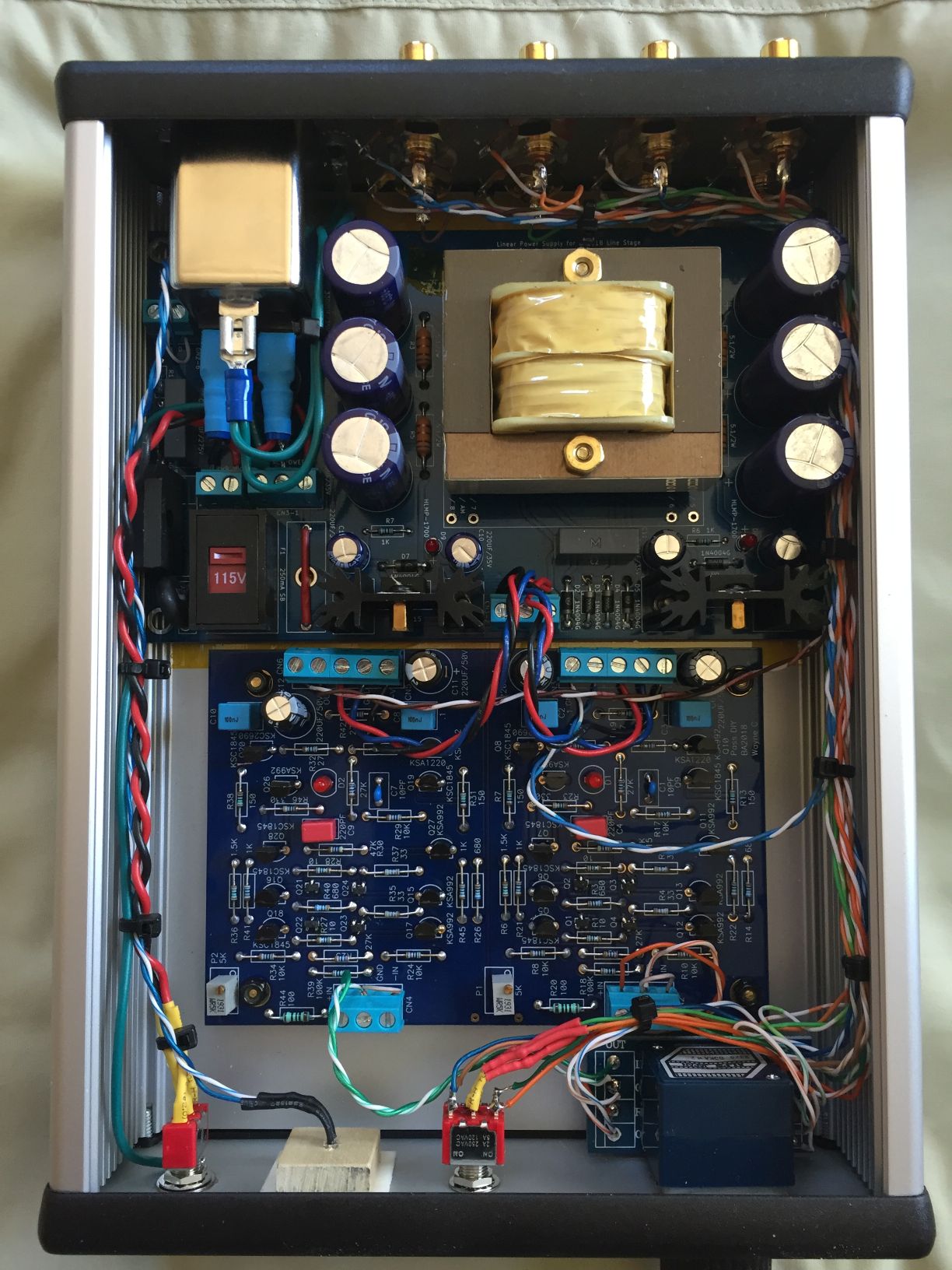

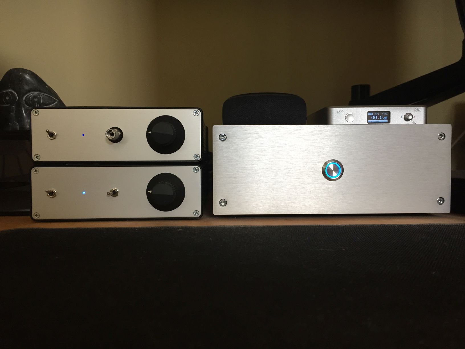

My Desktop System
BA2018 with Hammond chassis, 2 switchable inputs, fixed and variable line out, Whammy power supply with Triad transformer on custom PCB, Schaffner fused and filtered 2 amp AC inlet. Shown with matching Whammy HPA. Amplifier on right is a Millett NuClass D, connected to a pair of ADS L400 loudspeakers. No EQ required.

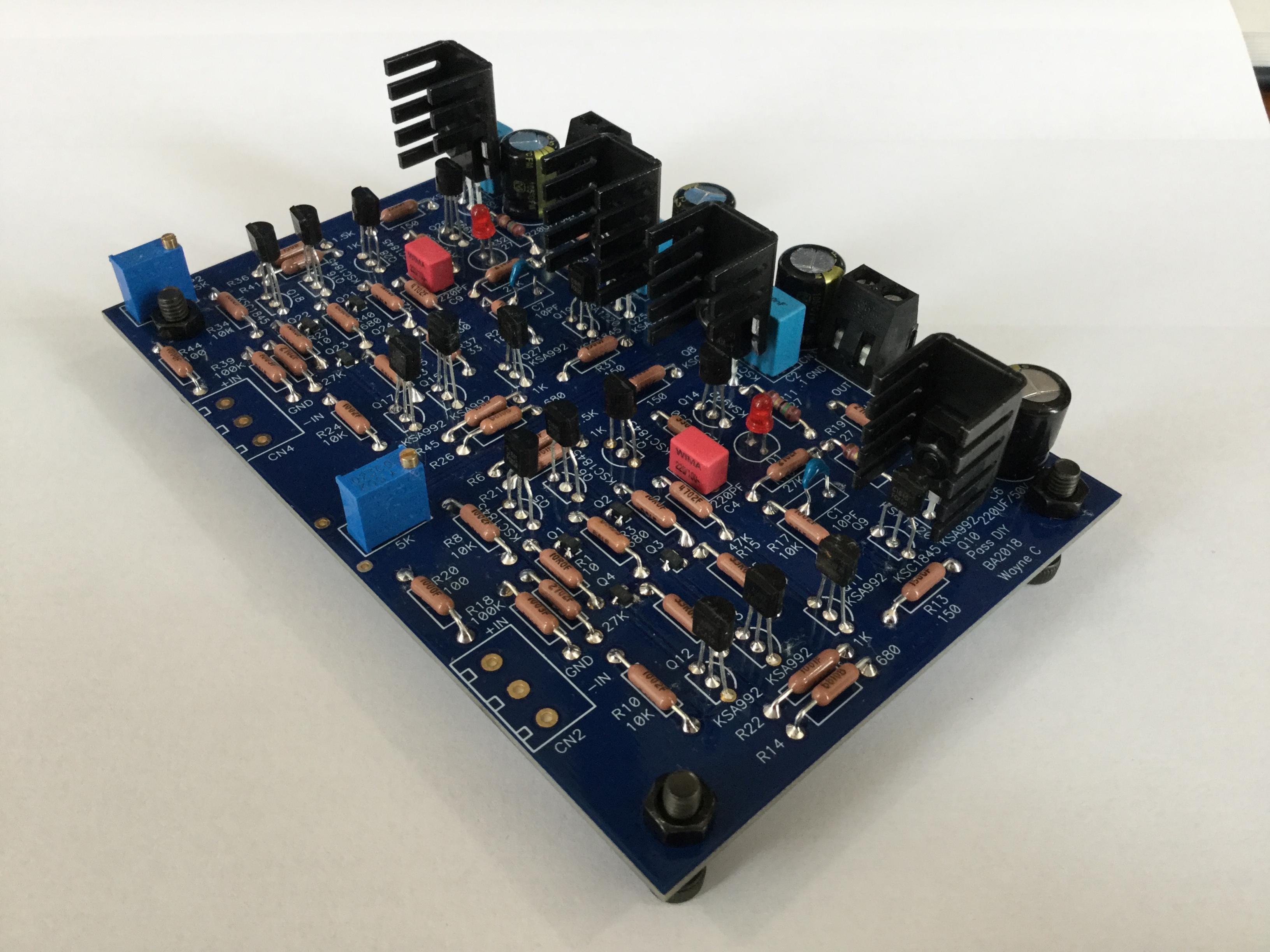

Some progress, slow but sure. I ordered the wrong 3-way terminal blocks so have to wait for yet another shipment from Mouser.
Big lesson for me (well, biggest so far) is to make sure I order everything in one go. This must be the third order from Mouser for this pre-amp. I think the shipping costs alone would have paid for a second set of components :headbash:. Ah well, maybe next time I'll get it right.
Hopefully by the end of next week it'll be making music and not smoke.
I see you are using the bigger output caps. I read that C4 and C9 should be left vacant and C1 and C7 should be changed to 5pf. Also I didn't get heatsinks for mine as I didn't read anywhere that they even get hot. I'll see when mine is up and running and add them if needs be.

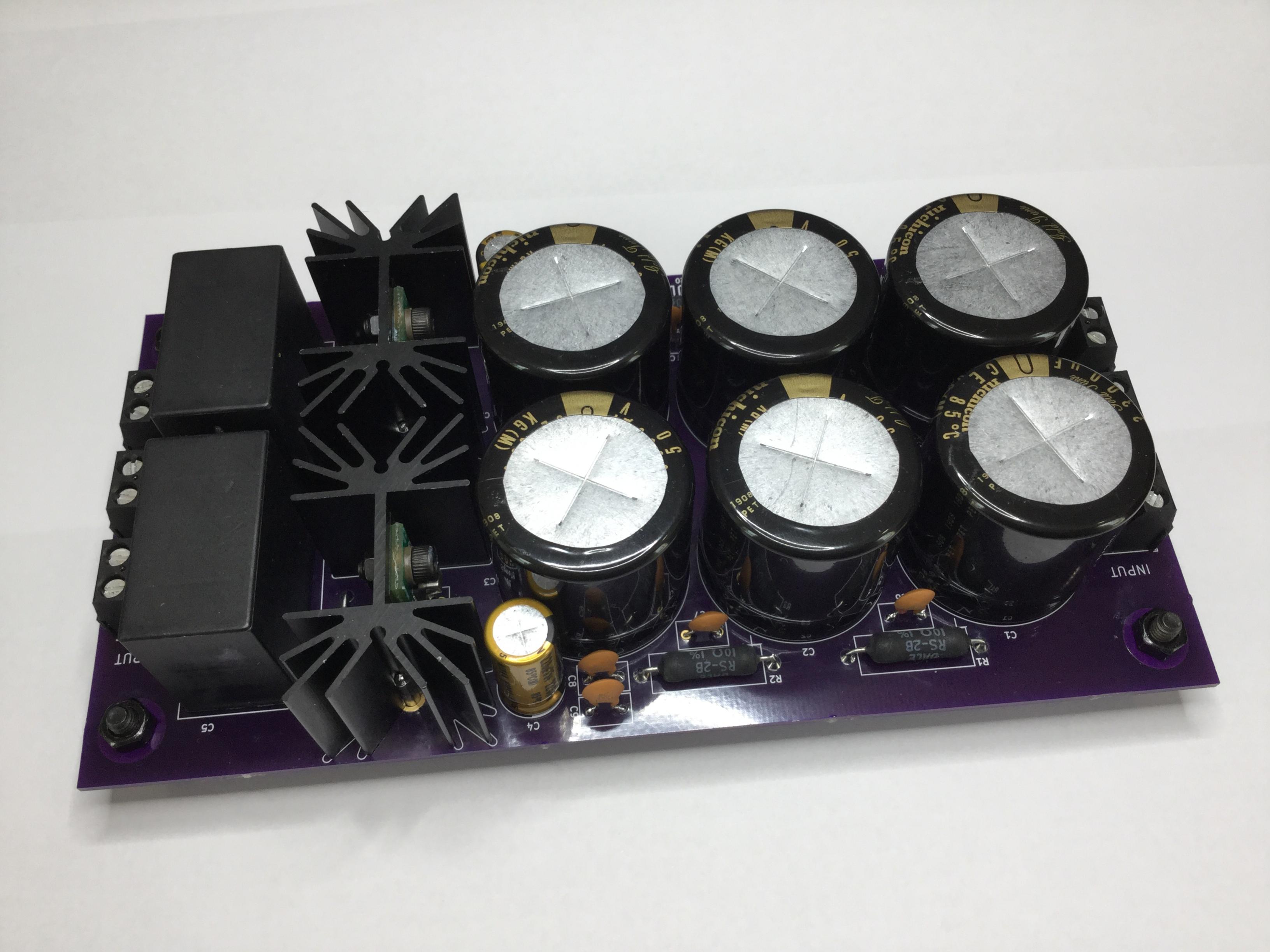

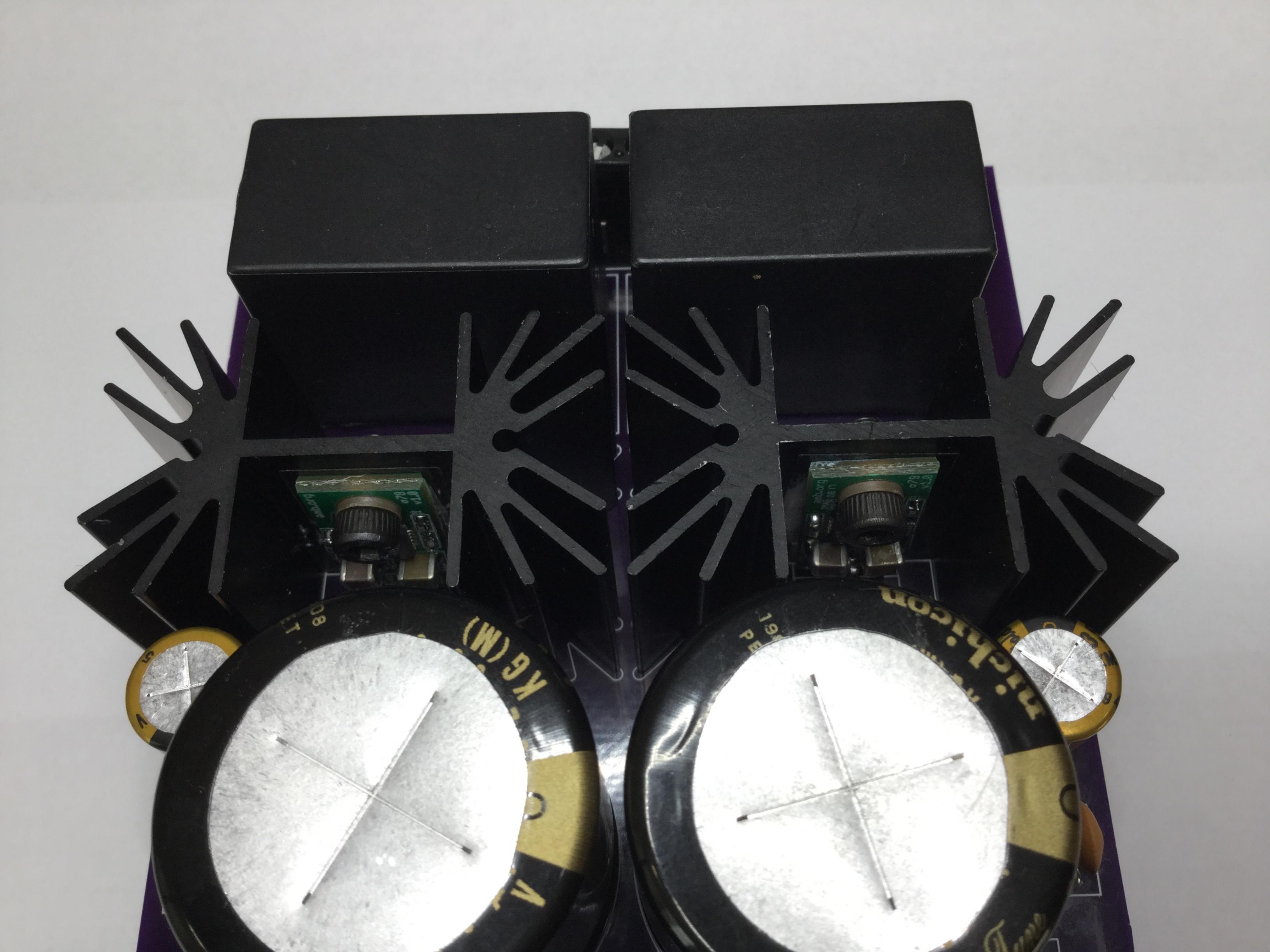

And here's the power supply regulator board I'm planning to use. It's designed around the AMB Labs sigma-78 and sigma-79 low noise regulators. It gives a nice stable +/- 18Vdc output, and no smoke 🙂
I did change C1 and C7 to 5pF, but must have missed the bit about leaving out C4 and C9. Should I definitely remove them?
I had the heatsinks lying around, so thought .... why not, can't do any harm 🙂
I followed the notes I had. There's more changes too like a couple of resistors to change. Take a look at the notes in the pic. You should use the 15R resistors with the bigger output transistors for maximum bias.
