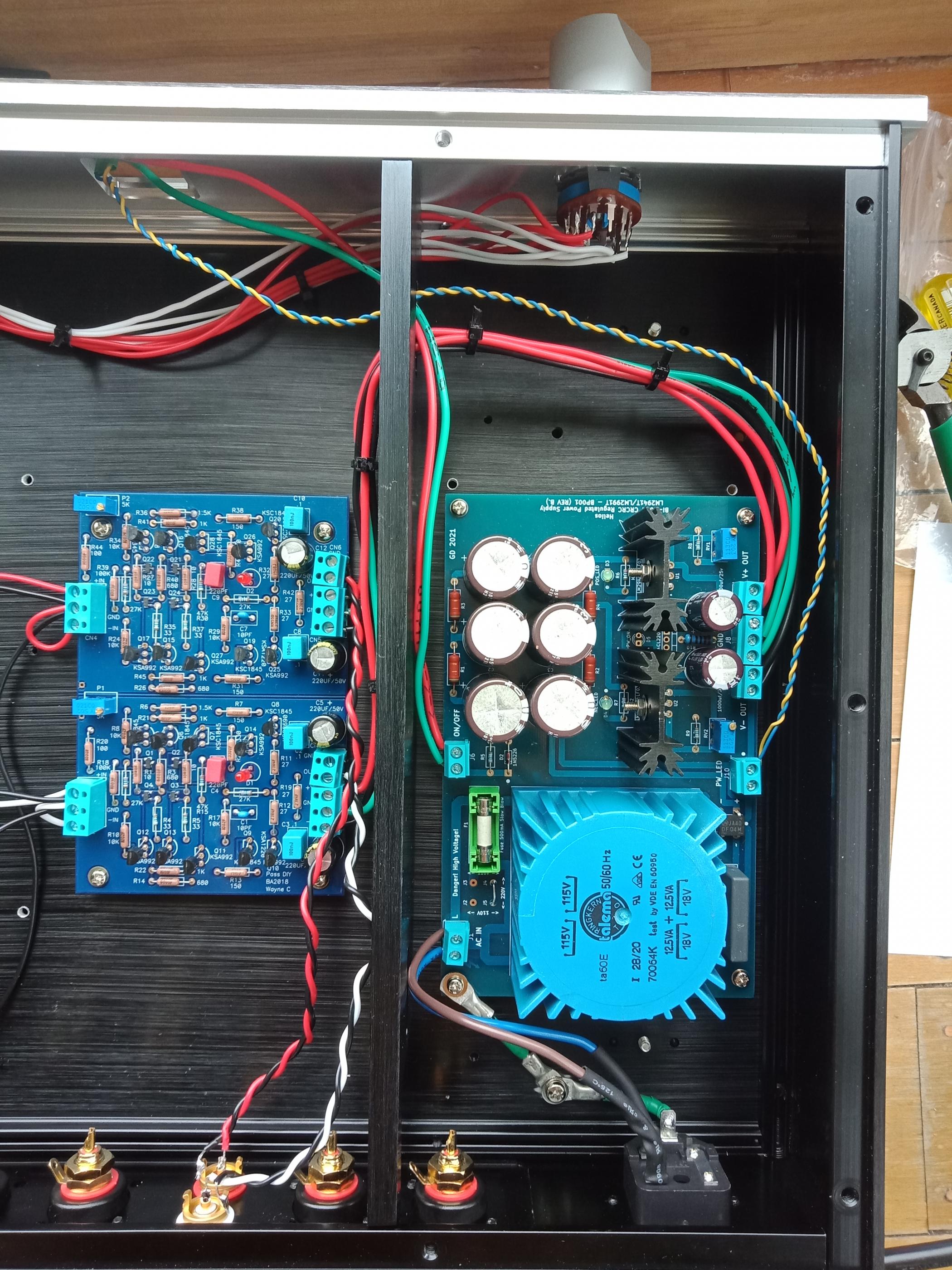

Elwood, I was thinking of doing something similar. What size is your chassis? Could you post some photos?

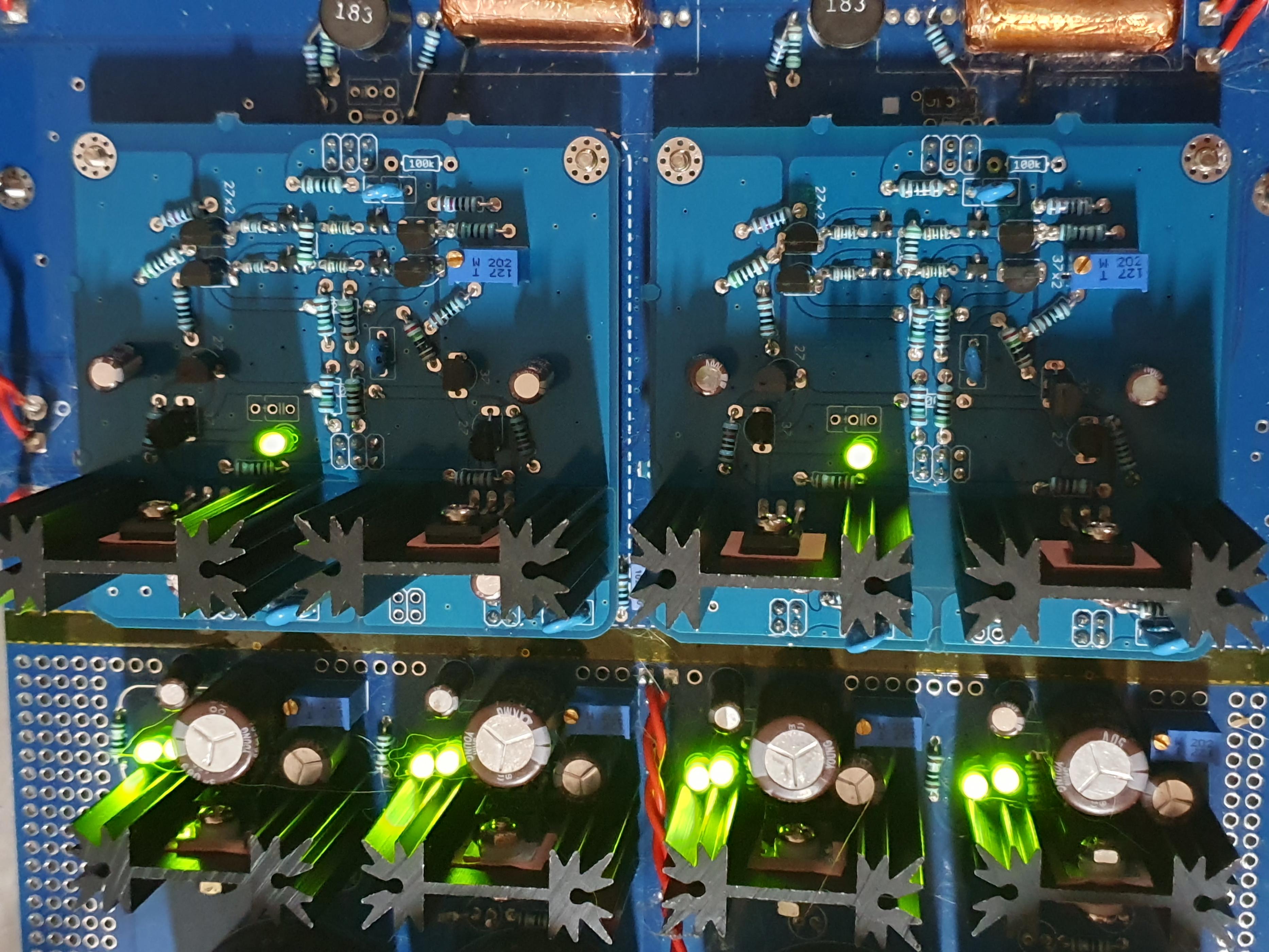

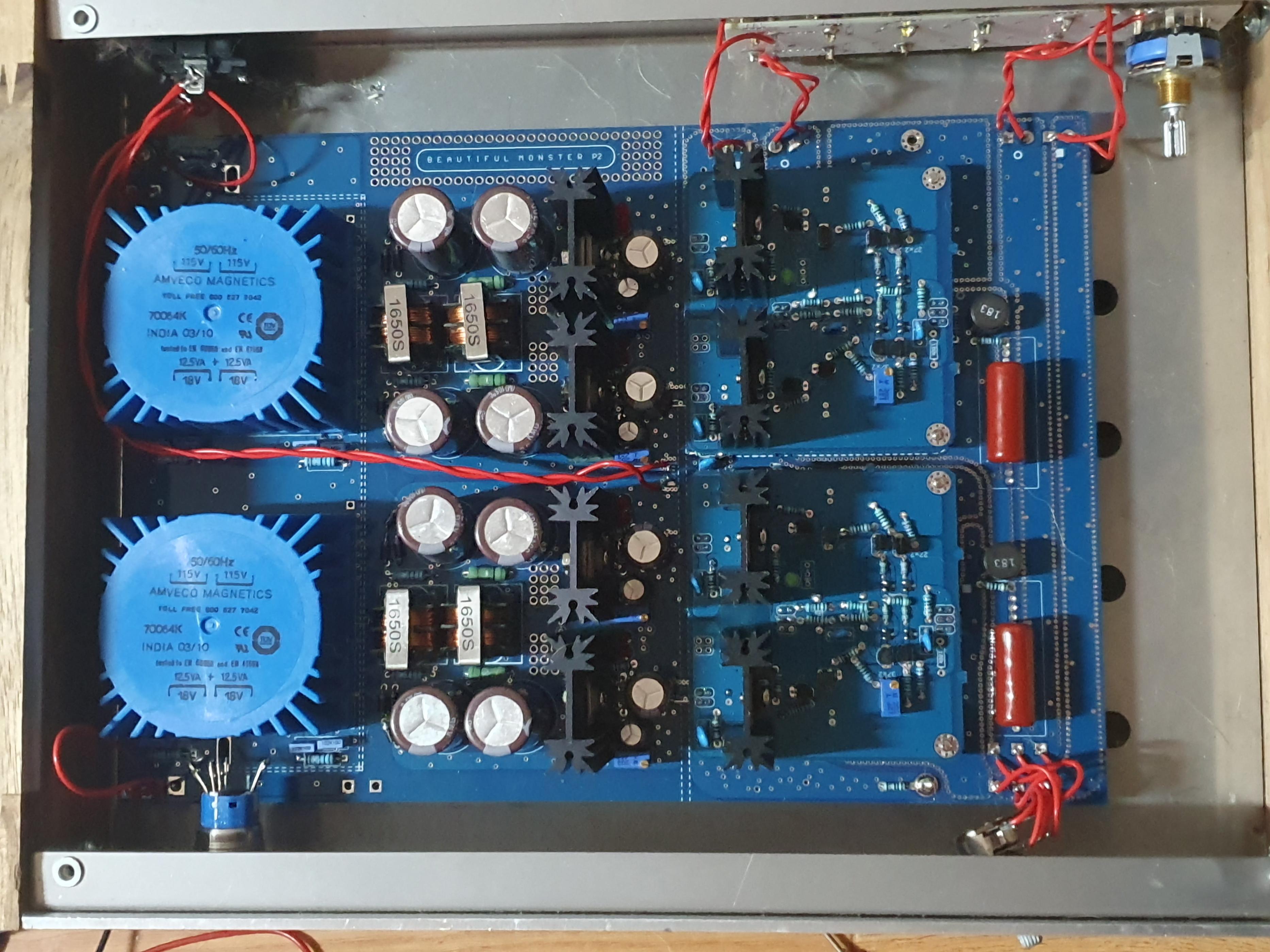

The psu is good enough! Adjusted it to -+18v and felt that it still wasnt running warm enough. What i will do next is lower the most of the ccs resistor values to 1/5th of what it is now, leaving the resistors around the jfet and the 1k resistors untouched. And then try again at 13v
Here is the build btw. Its lclc filter feeding cascoded lm317/337 then wayne's preamp modules that i did the layout for from the schematic. Its dead silent. You could hook it up to an iem and still not hear any hum.
Not happy with the module's layout tho. I will make it tighter next time 😀

Oh! Very nice indeed. I thought your PSU could only make +/-13v. There’s no question in my mind that the BA2018 likes the higher voltages, 18-20v seems to be the sweet spot, but I have one running at 15v that sounds wonderful as well.

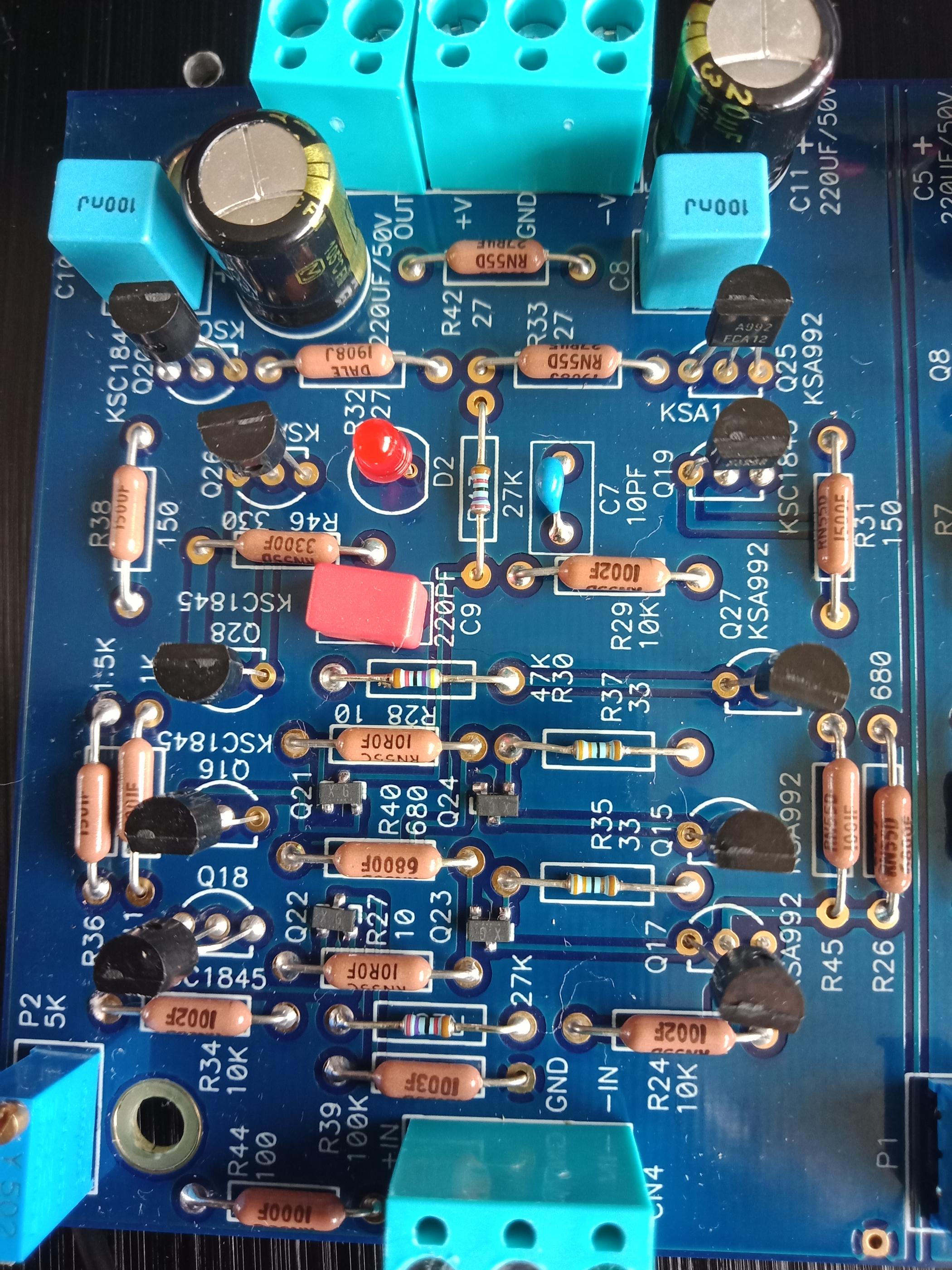

I got the bias tuned. Changes were 10k ohms> 100ohm, 27k>1k5 and changed the led to 2k trimpot. I have the outputs dialed at 700ma and all the transistors are nice and warm at -+13v (smile)
The sound is very dynamic and open now. However more transistor-y than before? Did i lower the psrr with my changes? Or is the 2k trimpot noisier than the led?
I was expecting the 100k ohm to be the bias resistor and the bjts after that being driver transistors. Was the working of this circuit ever explained somewhere? As appreciate as i am i dont have the time to read all 300 pages of this thread this weekend 🙁

700mA!?!
care to clarify that?
Measured it across the 10ohm emitter resistor. Since then ive dialed it down to 300ma. The resistors were getting too hot!

Bubba177 (or anyone else),
Here are some photos of my build, including the power supply.

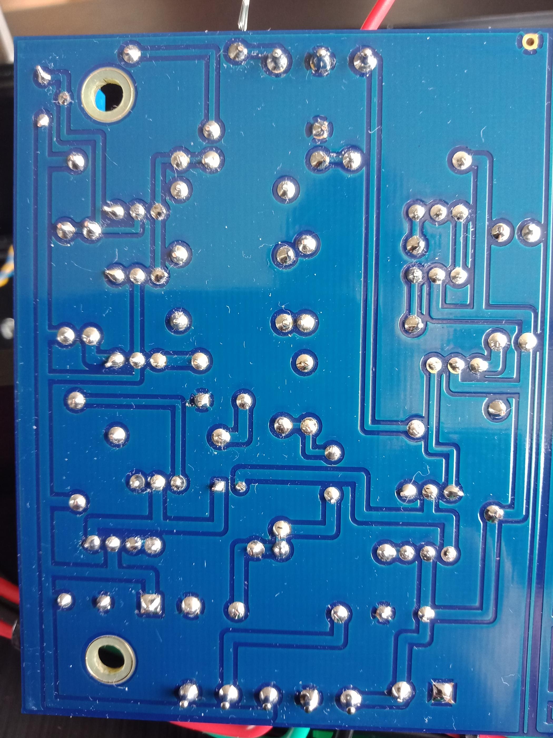

I posted a few posts back (2999), hoping for some insight into a problem I'm having with my recent build - wondering if anyone has any idea what's gone wrong?
Any help appreciated!

I had similar issues to you. I reflowed the SMD Jfets and then had different issues...
Not wanting to put the work into using the old parts again, I put some new ones in there, had a lot of DC offset, 17 volts worth, then floating one more time and it worked. Was able to set DC offset properly. Had sound, good center image etc.
One of the times when I was having these issues, one of them was even microphonic. Could have been a loose connection.
These little SMD chips are cheap. I would say order a bunch from Mouser or digikey so you have a bunch from the same batch and give it another shot.
