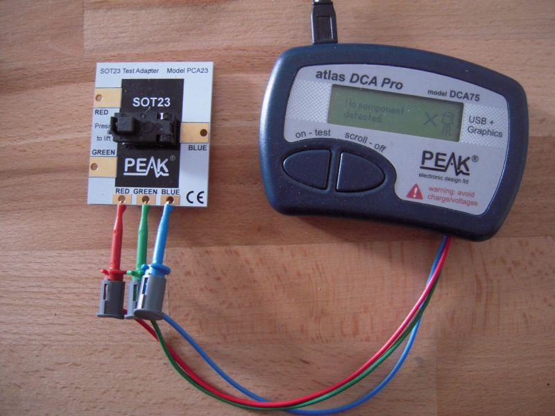

You could use this to match SMD-JFets..... 😉

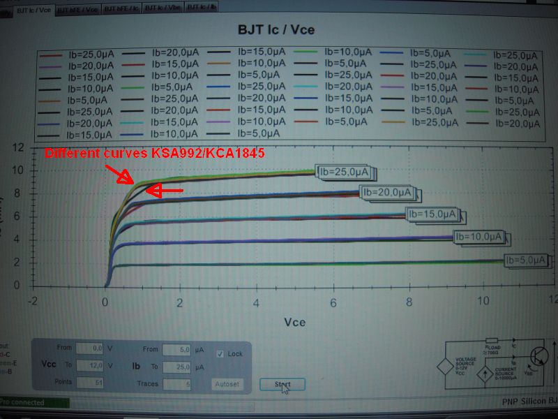

Didn't find my pics of 2SK209-matching.....
only from the KSA992/KSC1845

I've bought my Peak DCA75 Pro at the german parts distributor -
Security Check
Security Check
At the moment good price at 109.17 € (I have bought mine at 123,10€).
Or you can buy directly from PEAK ( they are in England)
Test Instruments | Peak Electronic Design Limited

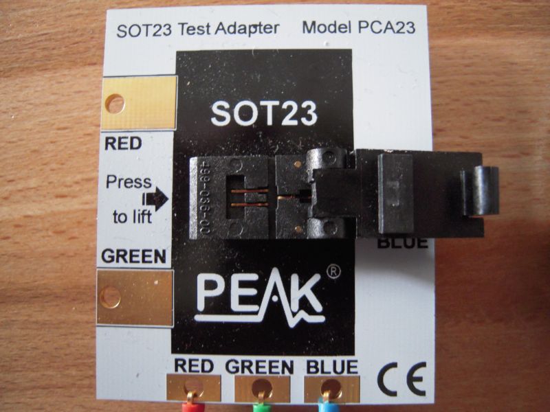

The SMD - adapter was bought from PEAK directly.
SOT23 Peak Component Adapter | Peak Electronic Design Limited
You only need a laptop - and... let's match
Greets
Dirk 😀
p.s.: The DCA75Pro can test to a maximum voltage of 12V
To test Mosfets for higher railvoltages - it is not perfectly suited
but it also works

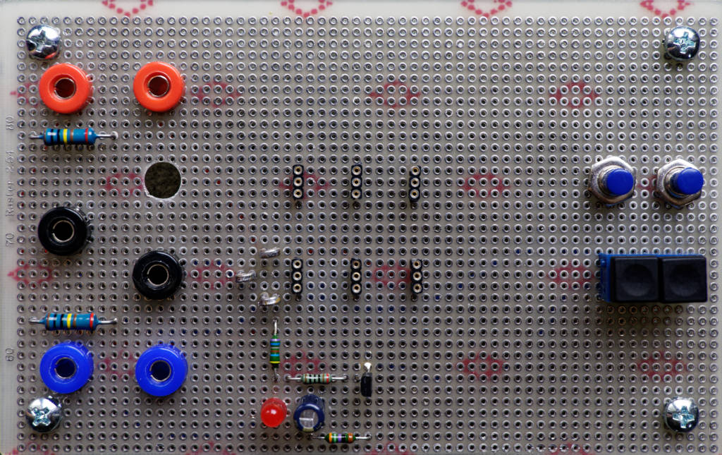

I usually match all my JFets, and matching for IDSS is pretty easy to set up, at least in principle, except that you need a special socket for the new small packages. There are plenty of references available that show the basic matching setup, my recommendation is to read the Borbely Article “JFETS: The New Frontier, Pt. 1” (should be easy to find, Zen Mod put up a link recently. I used his setup Fig. 5 for my measurements.)
I also have a DCA 75 but I am a bit disappointed in that it is not exact enough to match high GM JFETs, at least for some applications. The good news is that Wayne’s line stage does not seem to require matching, at least for GR parts, though matching certainly does not harm either. I matched my JFets at operating current because a) they are BL grade with higher currents and b) because I need to run the stage at +/- 30 Volts. This requires to control dissipation, especially in the drivers Q9/Q14. Increasing the emitter resistors resistors R7/R13 to 200 Ohms still gives 300mW dissipation for 500mW parts, which is as high as I wanted to go.
Talking of dissipation, measuring for IDSS heats up the parts. It is still ok for TO92 packages but those tiny new parts heat up quickly. This is another reason to match at operating current as that gives more stable readings.
Since you asked for a picture, here is my measurment board. As you can see there is not much to see, and this is still work on progress.
In the middle of the board I have 2 x 3 sockets for different pin-outs plus something to connect clip leads for the external sockets, the bottom row is for N-channel parts, top row for P-channel. Bottom center (red LED) shows the current source for the N-channel, right now with a fixed current setting resistor, but I want to make that switchable via DIP switches. P-channel current source will follow.

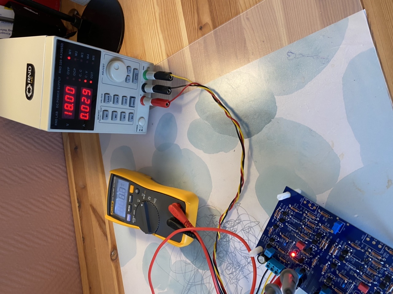

Anyways, in between being with family and doing housework, the last few days I managed to assemble a new PCB.
Just fired up.
Stable offset below 0mV, drift around +/- 1 mV. Current draw 28-29 per side. Current from JFETs to 10R resistors 3.1mA /31mV drop.
Looking good. But still hoping it won’t go ape during testing 🙁 Next up is the other chan, then have a look in the scope. Then do sinewaves and squares, we’ll see then. Looking good so far!

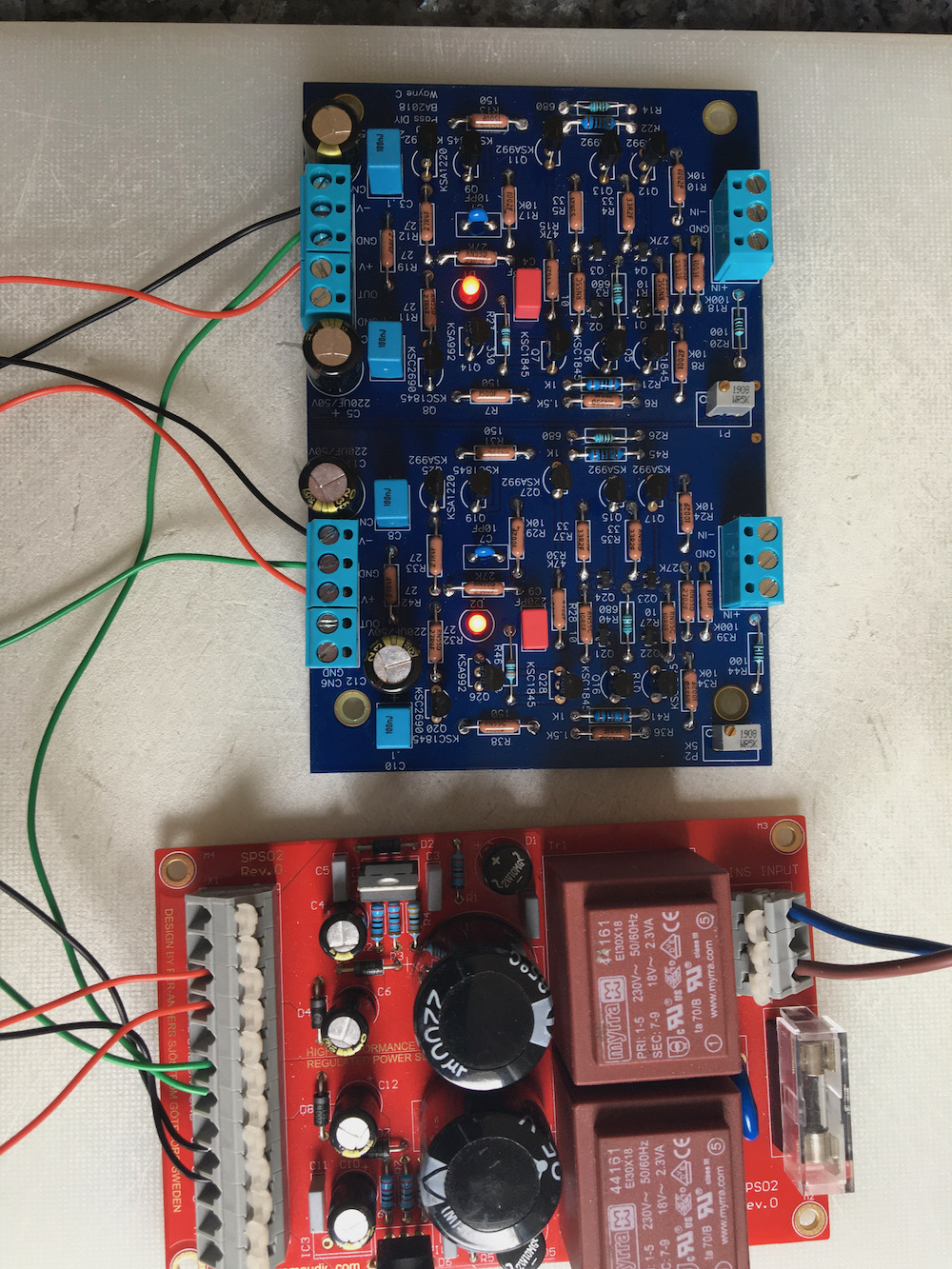

Thanks man! It’s been an unnesscessary journey, but a learning experience for sure.
Other chan also seems OK. Measures almost completely the same. Current drops over 150R resistors means both channels send about 13mA to the LEDs. Just about as prescribed.
Aah, finally! [emoji1376][emoji1376][emoji1376]
(Mine is doing fine again too, btw)
Good to hear! What caused the hum and noise?
I believe it was the gardener [emoji23]
(No, seriously, i don’t know. It hummed, I tore it apart, put it back together and bam it is good—sloppy work or something… here, aside some rfi-pickup/line-noise from the aca or the furutec-HPA/DAC, all is quiet too.)
