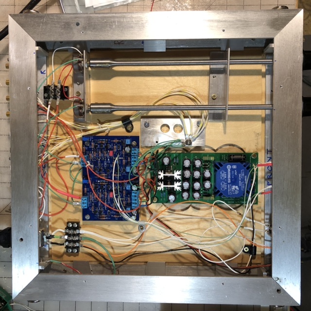

usure, insecure on Pete Millett +/- 15 volt (opamp) PSU
A question to those who have used his +/-15 (opamp) supply for this WBA2018 build... do the LM2941 and LM2991 regulators require isolation from the heat sinks they are attached to?
BOM does not specify but Pete being so lucid in the ways of electrons, might just assume I know these things...

... do the LM2941 and LM2991 regulators [used in Pete Millet's opamp power supply] require isolation from the heat sinks they are attached to?
The answers can be deduced by highly motivated people, from a quick study of the first six pages of the datasheet(s) for those voltage regulator ICs.

jdg123 - Being one who never passes up a teaching moment, here are some questions that are a little more focused to help you determine the answer…
1) Is the metal tab of the regulator connected to any of the pins? (Datasheet has the answer)
2) Can that pin/tab be connected to ground?
3) Is the heatsink connected to ground? (Or to anything else…, or does it float?)
4) Does the tab need to connect to anything via the heatsink? (I.E., is an insulator going to be a problem?)

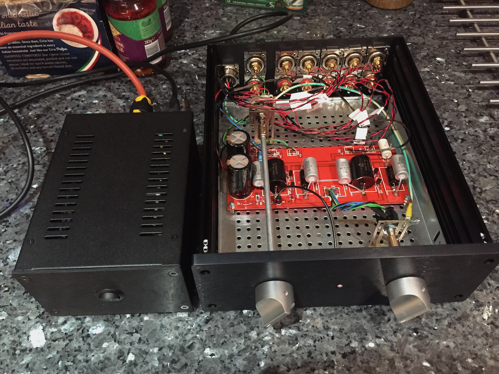

Soldered 8 critters... Now off to the store to get more Valium...
Congrats! Be sure to inspect every last joint. Also recommend you measure with a dmm with diode mode between each leg and next pad on PCB, just to be sure. And clean all the flux. I did it like this my second time around, a great success. Dunno what exactly I did wrong the first time though... thought I did a good job, but something went wrong nonetheless. Well well, doesn’t matter now.
Btw, it sounds just bloody great. In true Pass Labs style. Nothing is hidden, bass is awesome, and highs extended. Though not the slightest hint of harshness, rather a small amount of sweetness. Extended AND sweet. Only PL does it like that... really nice. I built to spec with small output transistors and GR JFETs. Extremely stable circuit.
Regards.

Ok, cool, I like learning 😇. Center pin of both lm2941 and lm2991 are the same as the metal “tab” one is to ground the other to input respectively. If I understand the iconography the heat sink floats. This to me (I’m guessing again) along with a lack of insulators on the BOM, says to just bolt the suckers on!
I’m not at all schooled in any of this. I usually wait for you guidance 6L6 😱
Cool. Verify that with your meter (is there continuity from the heatsink mounting holes to ground...) and if not, then you'll know if the heatsink is floating.

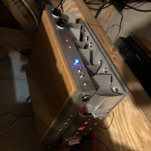

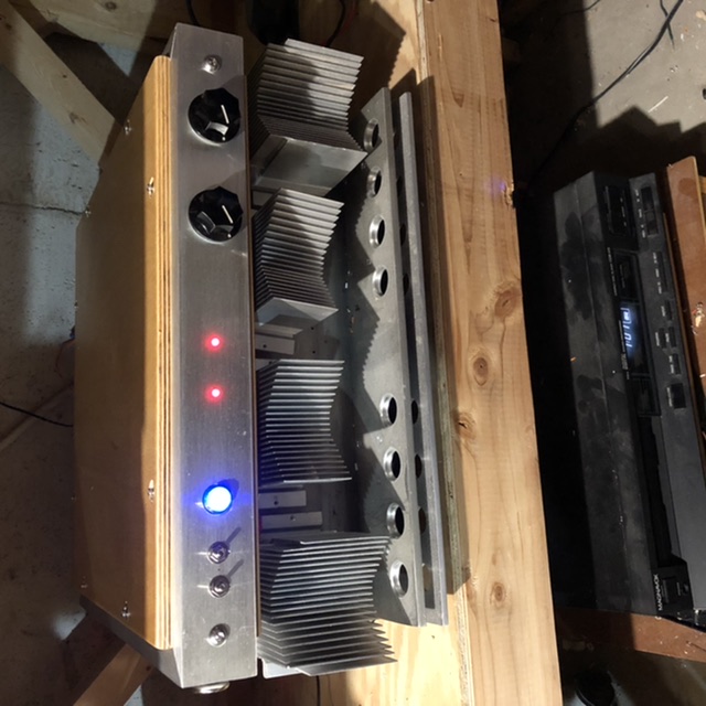

It’s all build from scrapyard aluminum, it’s good to live by a recycling center 🥰
It’s pictured above my F6, in my workshop 😎
Thank you to this group, Wayne, the man, and a kindly thank you to 6L6 for the assist/lesson. It takes a village to build a preamp 😊
