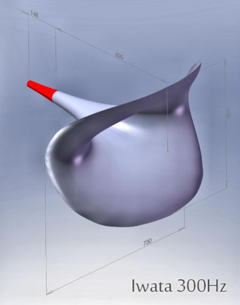

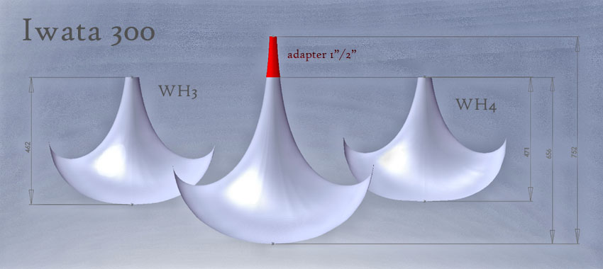

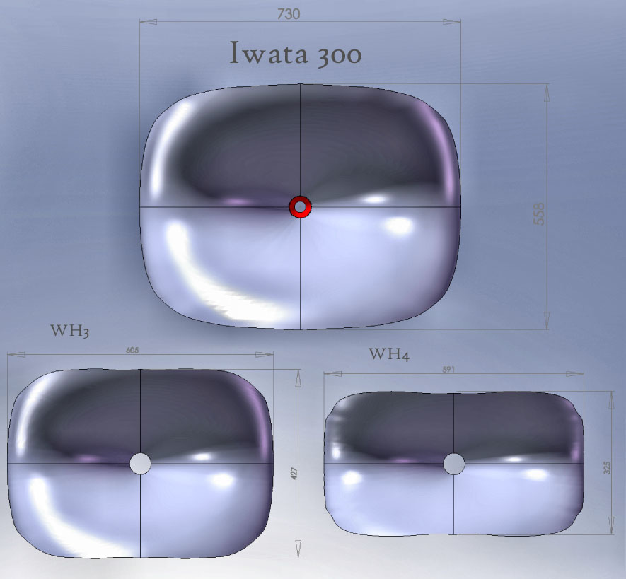

Iwata 300 CAD model with 1" to 2" adapter (red).
