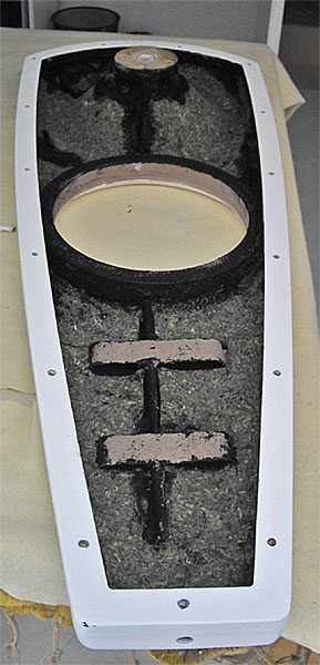

I am looking for more info though. What is inside the cabinet? how resonant are they? how does the compression driver and woofer mount? is there a wood frame inside to bolt onto? Etc.
Also, which 1" Compression drivers will fit the best? Do you have an optimal CD mouth angle?
Just screw your woofer to MDF and use threaded rod on compression driver. We tried special polymer sound damping material but there was no difference. Classic bitumen plus felt does the job. You can easily feel vibrations on a whole cabinet with RAW fiberglass. WG has 14 deg throat angle and most drivers will fit. I was comparing Mummies to $30.000 speakers like ASW Magadis with AMT and they were slightly smoother so better use ringradiators for highs (haven't checked yet).

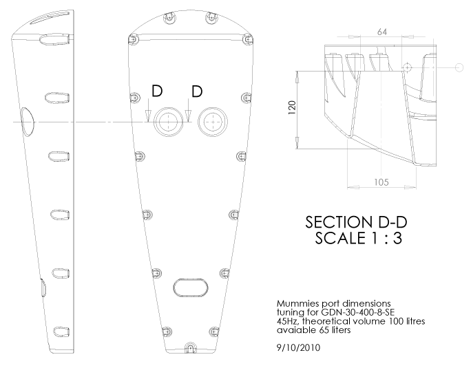

What is the internal volume and port tuning for the woofer??
Looking for a group buy on these..... - AVS Forum

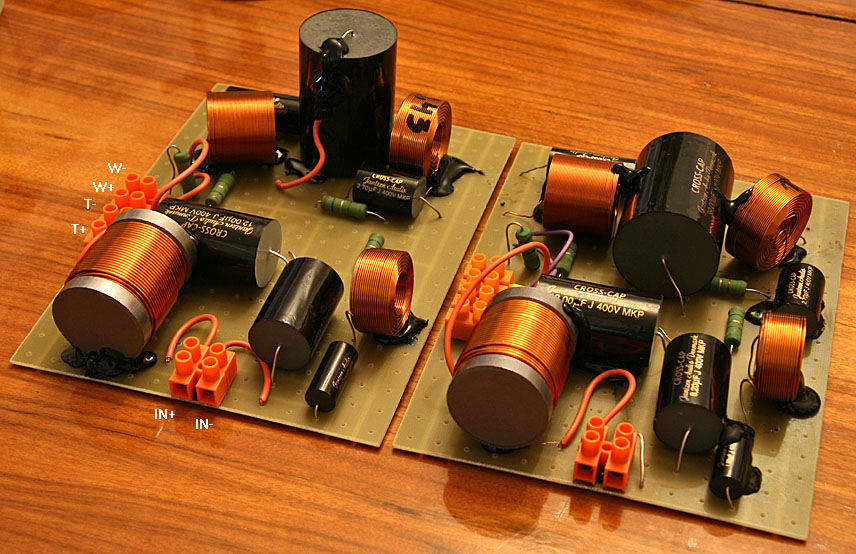

Ok we calculated cost of Mummies enclosure and it is $670/pair. You need extra stuffing e.g. felt+bitumen and stand - on the picture you could see bianco carrara marble. Shipping of one pellet is between 500-800$. I haven't call Polamer yet. Can you? For those who want experiment with CD waveguides (installed in Mummies) I warn passive crossovers are complex here and require some experience. Be prepared to spend a lot of time on tweaking otherwise speed up with digital.
With 65 liters you can hardly get 50Hz at 98-100dB/1W/1m so take into account lowering total efficiency or add bandpass subwoofer - for example 20 liters ported and 40 liters closed with 12" aluminum bass driver - 30Hz at 91dB. Mummies were designed for multisub setup. We chosen low mass wide bandwidth 12" bass/midrange without Faraday's rings - 100 liters is usually too large for most 12" PA woofers.
