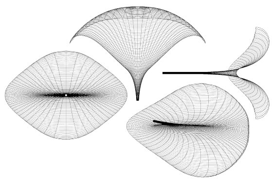

So what will happen with HF in longer horn?
I guess the HF will suffer and the horn will beam more.
Frode
There is also a constant directivity JMLC horn without beaming.
