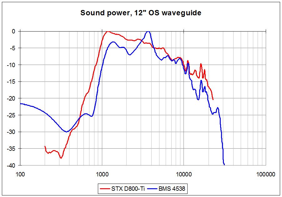

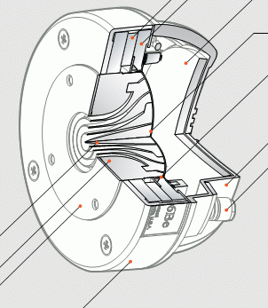

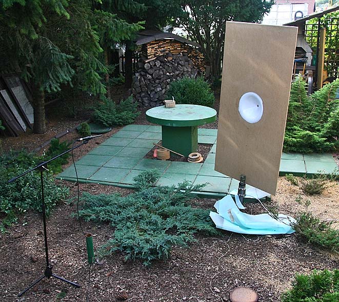

Interesting but risky. Simple roundover does the job. Remember JMLC is high fidelity horn and doesn't require any EQ. Sweet spot can be widen using 2-way horn design like "Avantgarde" or with elliptical. With OSWG you will spend plenty hours with passive crossover. Here's a power response of my 12" OSWG driven with my D800-Ti driver and borrowed BMS 4538. While BMS does not ring at HF like DE250 its unusual phase plug affects the sound power or it requires recoiling.
