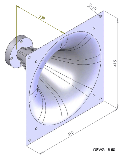

New 15" OSWG horn concept for PA, 130dB, 1.4" coax drivers, coverage 50deg. It has much chance to be fabricated soon.
its not to be negative, but depth of your drawing may give a wrong picture of the shape
makes it look more like a long throw horn than OS
anyway
I thought that 15" was supposed to be at the inner circle of the mouth rounding, to make it a 15" waveguide
well, this probably just shows that I know nothing about it
