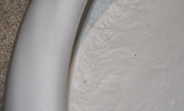

How does the back side look of these horns, is it rough glasfiber, or do they have just as nice a surface as the front side? I guess not...
Do I understand the OSWG 12" is made for baffel mounting, or else it would have needed the bigger round flares? Do you know the shipping for two to Denmark?
Backside of JMLC and Iwata horns
Backside is rough. It is designed to be flushed into baffle/box so backside doesn't matter.
I suspect that the JMLC horns also have this rough backside finish even if it's recommended to not mount them in a baffle. Am I right? How rough is it? Can you post some pictures?
Probably the same applies to Iwata horns or anybody has an idea how to mount them in a baffle
Another one, I understand that there is some choice of colours and black is one of them, right?
Chris
JMLC and Iwata are standalone horns, baffle mount isn't recommended. Colors: white, green, blue, yellow, black. RAL or metallic for a large orders.

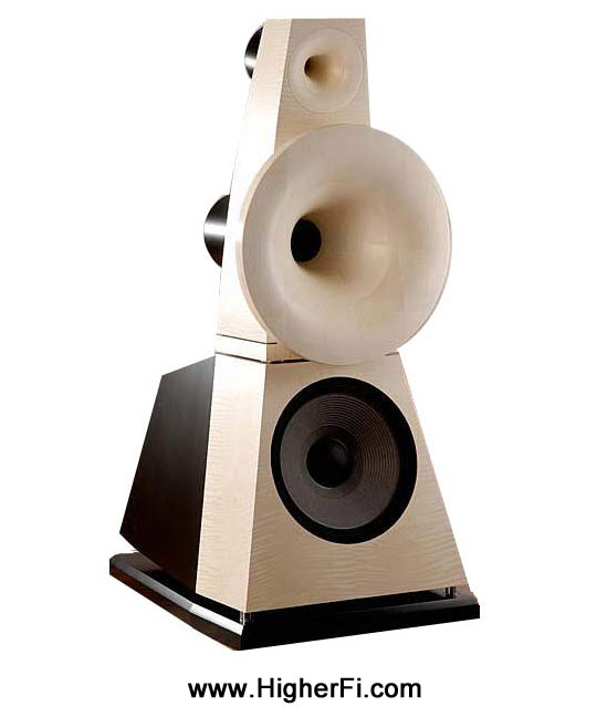

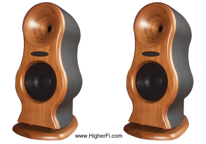

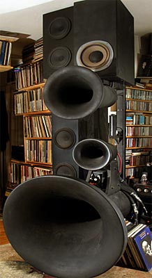

The beauty and high quality of this WIKI group buy can help move horns out of the "man cave" and into the living room.
From what I have read, an 18" OS_WG is the ideal size for a 15" woofer with 750Hz Xover. A 12" OS_WG can be used with 12" woofer crossed at 1,100Hz The best OS_WG designs include heavily rounded diffraction reduction cabinets. The JMLC horns with the full round-over are usually used naked.
