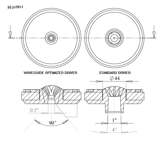

Typical driver and driver optimized for waveguides.
Would be nice if somebody was willing to manufacture these (preferably at high volumes to keep cost donw...) Any future plans?
First we must run test with printed phase plug - modification is easy. I would like to use Radian diaphragm or DE250 for comparisons.

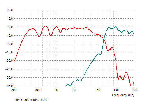

EJMLC-300 + BMS 4590. I like the sound very smooth and easygoing
Thanks. Do you have any directivity graphs?
What would be your 1st choice for a BMS 4590 between the Itawa300, EJMLC300 and the JMLC200T?

For single horn I would choose ejmlc300, for 2/3way and 1-1.4 inch driver JMLC350 as did Zoltan from Budapest:

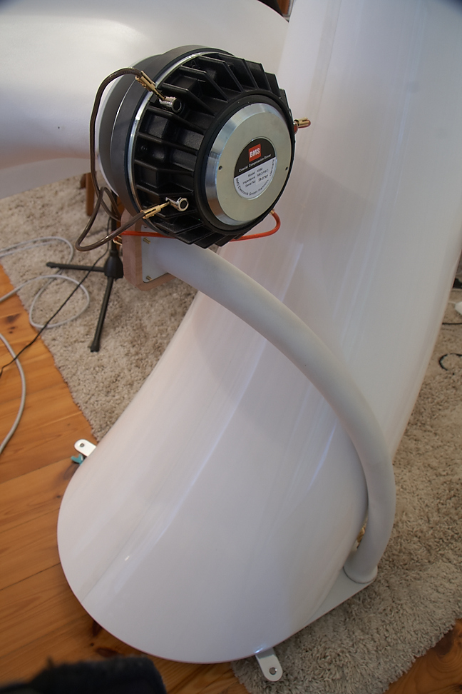

plus sub, tweeter and optionally super tweeter. Below is ejmlc/bms mounting, wood parts will be French Polished.

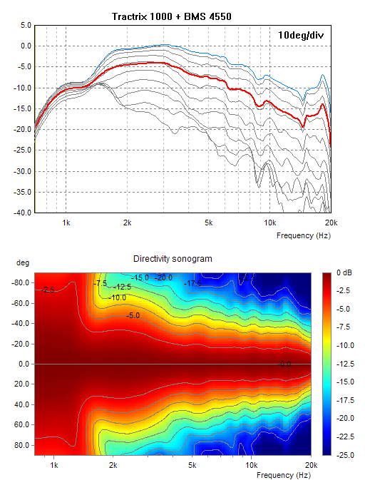

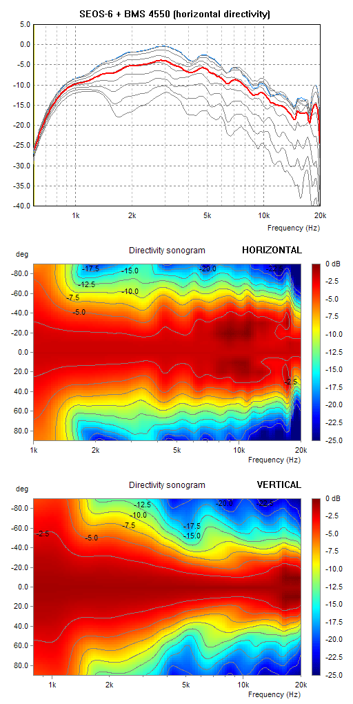

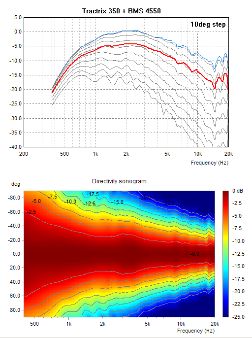

Tractrix-350, Tractrix-1000, SEOS-6 directivity.
I was asking (seemingly poorly) if you had directivity data on the EJMLC300 horn with the BMS 4590. Do those graphs exist?
