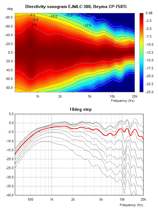

Here are some horizontal measurements of the IWATA + TAD 1402.

Glad to see some movement on this thread! And the plot thickens...there is now a smaller Iwata 600 for a 1" comp driver. Thanks for the measurements on the E-JMLC-300 jzagaja. Sounds like you're staying busy over there in Poland. Could you post some measurements for the Iwata 600 ?
As far as choosing a waveguide/reading these Directivity sonograms, what do people think about an Iwata 300 VS. a E-JMLC-300 ?
The E-JMLC-1000 with the BMS 4538 looks very nice to me. Crossover would have to be in the 1.5k area though.
Im wanting to build an actively bi-amped two way system for home listening and would like enough extension at the top to forgo a super tweeter and enough extension at the bottom to cross below 1k. Would consider 2", 1.4" or 1" comp drivers if possible, poly diaphragms preferred although their top end seems a bit limited.
Unless you have very deep pockets, a lot of time, and a very large room, I'd scale back your goals.
When you try and push a waveguide past four octaves, it gets very VERY VERY difficult to make it work. If you opt for a larger throat or a larger diaphragm, your high frequency response goes to hell. If you opt for a smaller diaphragm (a la BMS 4538) you trade low-frequency extension for high frequency extension.
