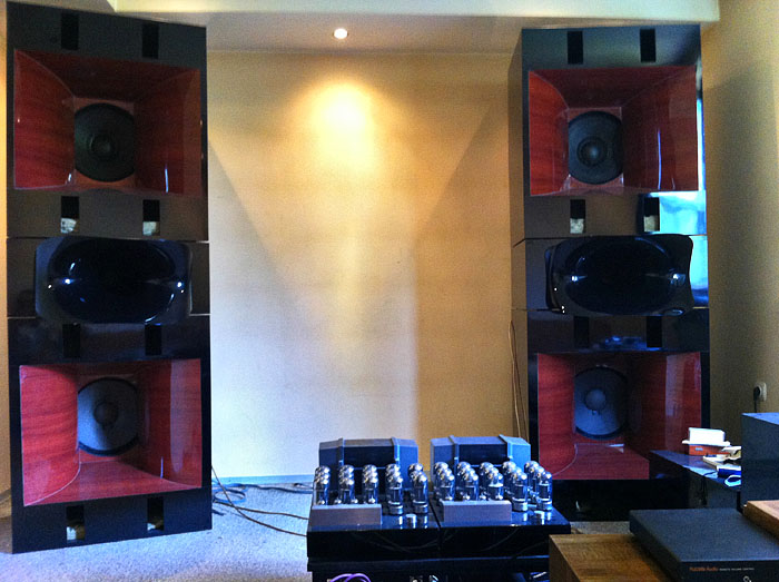

Iwata with Tad 4001 and 1601.

rajacat,
I posted a sort-of review of my Mummies on this thread some pages ago, reflecting my early and immediate reactions. I've since upgraded my D/A-converter and made other subtle changes to the power cabling as well as adding a more resolutely configured star-grounding, and coupled with the time to "mature" impressions I believe a follow-up review could be mandated 🙂 Perhaps my recent Audiogon impressions will enlighten a bit:
AudiogoN Forums: Auto-Tech speakers
A distinction must be made between my pair of Mummies and the ones illustrated above(in Mercedes silver), apart from the coloring; mine exhibit the Polish STX units, both the compression driver and bass unit, whereas the silver Mummies above feature a BMS compression driver(4524) and a Beyma(12BR70) bass unit. Sensitivity ratings are 98dB and ~94dB respectively, with the latter(BMS/Beyma) said to sport sweeter highs and slightly more extended lows(the mids not yet outlined). I'm vaguely considering a change to the BMS/Beyma Mummies, but this is still in the stages of thinking-it-through in that I have no easy way (other than going to Poland...) to audition them before purchase.
As is I'm very appreciative of my Mummy's outright honesty and sheer level of information. Theirs are not the gaudy or flamboyant sonic imprinting, but rather an exceedingly clean, tight, "fast"/energetic, and of-a-piece sound. Being that they also thrive on complex music and exhibit a marked sense of ease there's very often the sensation of simplicity to the presentation; it may at first lead one to believe something's missing, but on closer scrutiny there's quickly the reverse effect of feeling everything clearly laid bare, and emanating from a very stable and calm background. Unfiltered, you may say, yet musically very engaging.
