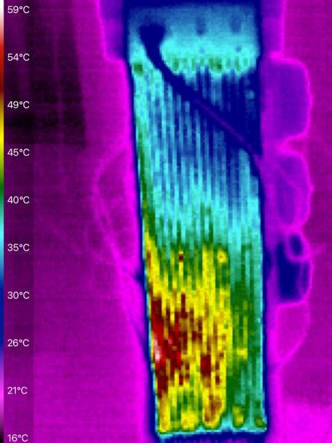

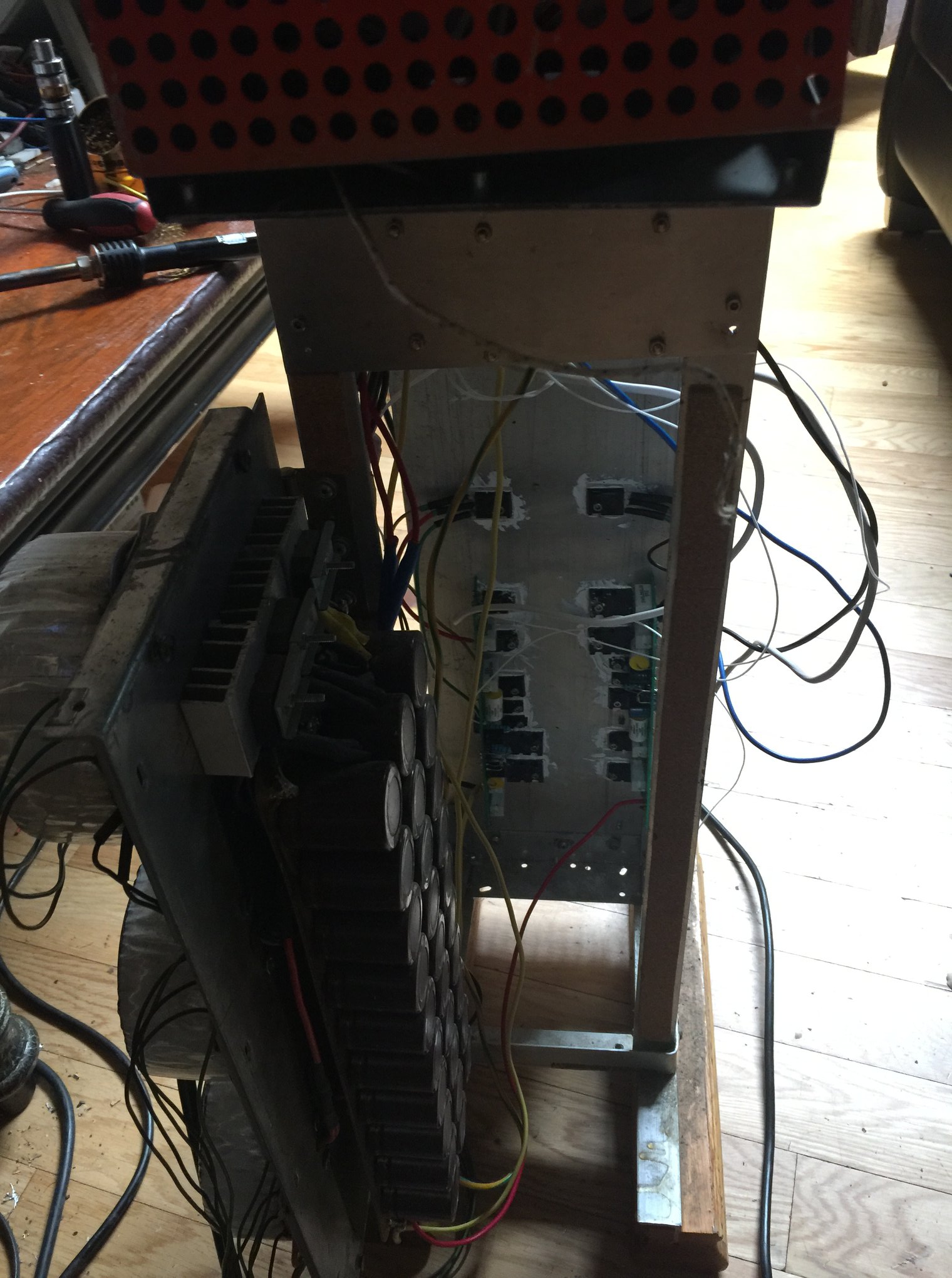

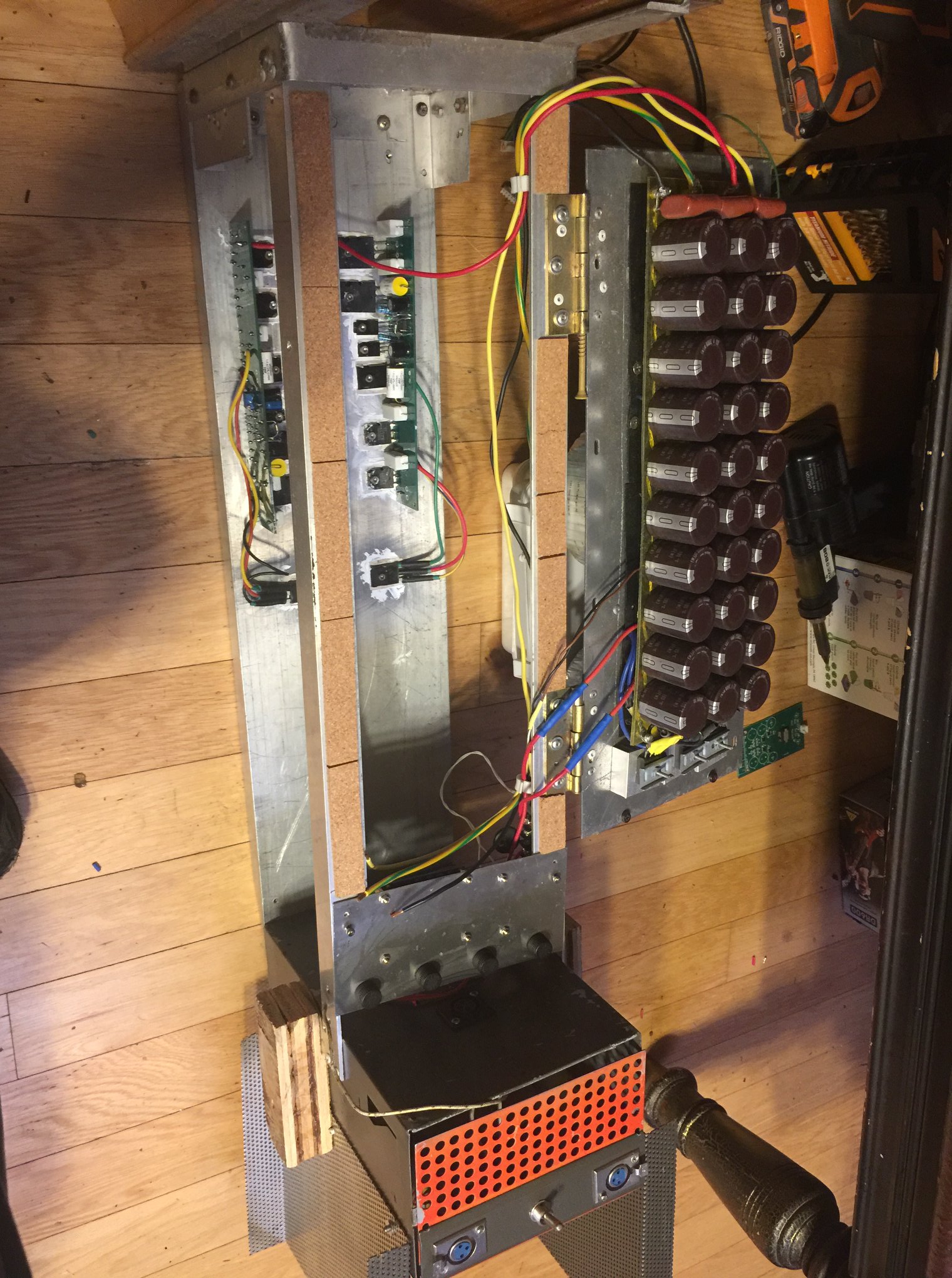

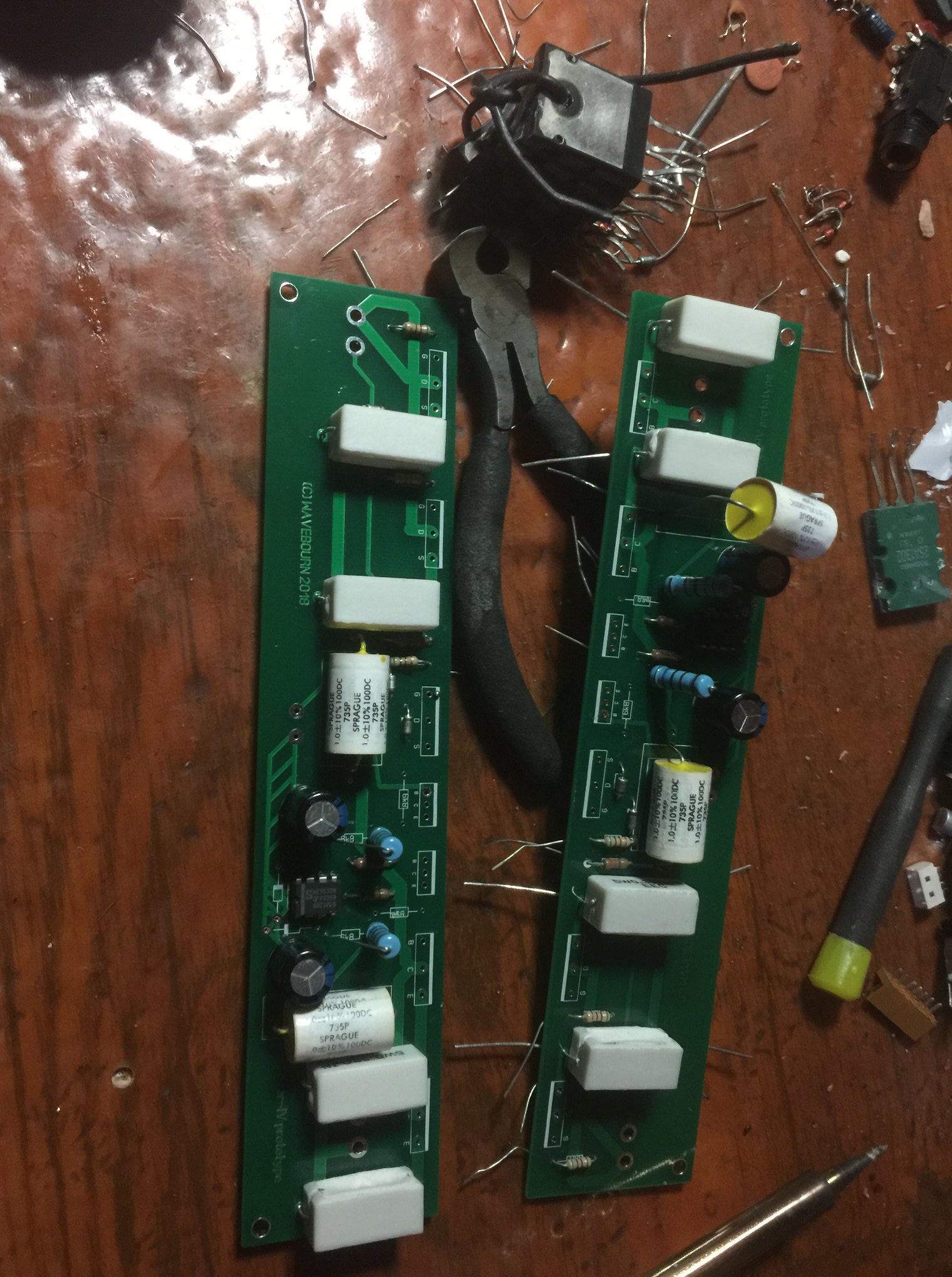

Time for the next version, improved... It will be 100W per channel now. BJT CCS, Sic MOSFET augmented source followers. PCBs for output stages.
